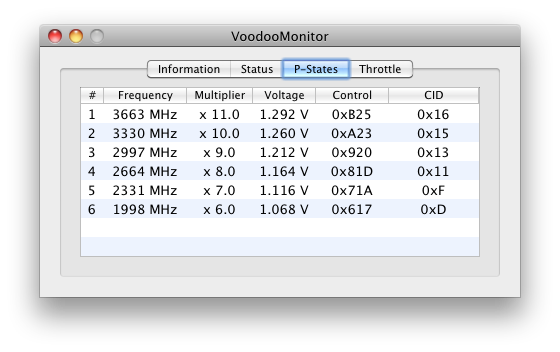

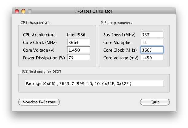

I tried this thing, with a thumping heart, should I fry my CPU, I'm not in a position to buy a new one. :gun:
Yet, I treaded carefully and figured out the P-States from the P-State Calculator, using my own values, not the auto-feed
values that P-State calc takes or shows automatically.
I'll put in the lines of code asap, so DB1 and master chief can study them, and confirm that my CPU won't be fried, like in few days. ;)
I've checked using Voodoo Power and Voodoo Monitor App. It isn't actually much accurate. But it did show me the Speedstep figures. Then, I tried the Mark-i app, it is as good as ASUS PC Probe. It's more real-time than anything else.
There are a couple of more things that need to be done, to enable sleep support. USB Jumpers is definite must/requirement.
I thought I had placed caps on all sets of jumpers, (but I didn't remember!) but I had not switched jumpers on pins 2-3 of all 4 (four) sets of USB +5VSB jumper points. SO?
Well, the system went to sleep, but would not RESUME /WAKE up.
So opened the cabinet, did the switching, and rebooted. Enabled SpeedStep and Enhanced C1E and Set the Multiplier to Auto instead of Maximum value = 11, in the BIOS. My CPU (too) is unlocked.
Booted to Snow Leo. Ran Voodoo monitor. It defaulted to showing me the lowest of the 6 P-States that I have fed into the DSDT.aml file. There was 1 single compilation error, when I used the 3.3 version, later.... I'd to comment out few lines to eliminate that error.
I hope DB1 or BlackCH or Master Chief can help me in sorting out that issue. Coz I've kinda mixed up a lot of DSDT files from across the forum. And, kinda misplaced the minimally modded 3.1 DSDT variant.

Hey man when i look your screenshot of voodoomonitor i realized that i have same values.... can you please share your dsdt ssdt please?
or write how and where you modified your c and p states? right now i have dumped ssdt tables but i dont know how to modify them... thanks!

Importantly, 2 things:
1st]
I've Used P-States calculator and the first SpeedStep line is based on what you seen in this screen shot:
The TDP value is at 75W, as against its default (maybe read or derived) value of 65W
Voltage levels begin from 1.450V decreasing till 1.300V in both the voltage fields.
I hope it doesn't fry the CPU. I did it coz i've extreme OC'ed my rig from 2.93 -> 3.67 GHz.

1st P-State screenshot: post-18224-1272858920_thumb.png

Well, I've changed the DSDT as per the P-States as already specified there by you.
Nevertheless, you can post a screenshot of P-States using voodoopstates.kext, voodooMonitor and P-States calculator, without the Intel SpeedStep enabled in the BIOS. All CPU settings set "Manually".
Then we could arrive at a improvised DSDT.
Now, Coz even I am going to bit improvise my DSDT today, and implement few SpeedStepping changes.
Attach the said files and let's see what more can be done. :ninja:
