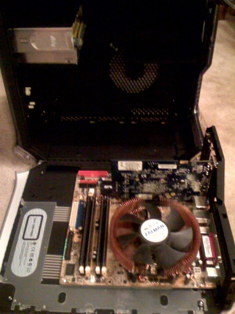

kernalzero Posted November 14, 2007 Share Posted November 14, 2007 Well here's a preliminary picture of my G4 case mod. So far I've cut all the excess metal out, smoothed the surfaces, drilled my mobo mounting holes, painted the case and now the mobo is mounted. I spray painted the entire case a flat black, once I get my clear rounded cables, SATA cables, new thermaltake PSU, power button cable, etc I think it will contrast the black really well. We'll see though I guess. I'm hoping my old ibook DVD drive will work, atleast saving me some $$ for the time being. The locking mechanism still works though! pics taken with my iphone and the room wasn't very well lit...will post better pics later once I get all my parts. Link to comment Share on other sites More sharing options...
bonestonne Posted November 14, 2007 Share Posted November 14, 2007 looks pretty good my build is slightly held back due to power supply and budget. rather than waste money on three extensions, i'm adding 15" to the ATX power cable, ATX 12v cable [P4 power] and the fan plug for the PSU. that's about 56 total places to solder and shrink wrap. i'm done with the P4 cable and some of the ATX power cable, and i even added the two pin connector for the stock Apple 120mm fan inside the case. I also had this issue with the 3' PATA cable, there was section of it missing, i very slowly [took about 20 minutes to do it] removed the PATA connector from the ribbon cable and put it on the cable a little lower than the hole so it was still long enough to use its original positioning around the case. for the motherboard did you drill straight down into the case and mount standard motherboard mounts? thats what i'm thinking of doing...if its too high or too low i'll just add spacers. so far my case is mostly original...i just have the small issue of one of the top plastic hooks being broken, so there's a slight gap. aside from that, its largely original to how it was before i touched it, but i did manage to remove the original motherboard mounts [6 out of the 9]. they're very weak actually, i used a large pair of pliers to bend them back and forth until it gave, the metal is weak enough to release them, but at the same time, once the panels and all are in place, its not noticeable that they're gone. will post pics as soon as i'm feeling better, just got too much schoolwork. oh, does anyone know how to rewire the power light and power button? i want to leave the circuit board how it is, but just add the leads that i need for it. if thats not possible, then at least how can i use it, i want at least the LED and reset buttons working, the other button i have no use for [not even sure what its for either]. the power button has 4 leads, which two can i use...also, the LED is two colors, which leads do i use for the green? i'd rather not have to experiment, i don't have RAM for this just yet. i changed my plans from single drive/single OS to three drives, triple booting my hackintosh. this will get interesting, by far. ------edit-------- long awaited, and needed! some pictures! the empty case^^ the broken clip area, not sure how i'll attack fixing it^^ planned out new mount points and removed old ones^^ PATA cable fix. very ingenius, i must say^^ my being mostly out of supplies needed to continue^^ 40 points of solder/shrink done, 14 left.^^ for now that's it. Link to comment Share on other sites More sharing options...

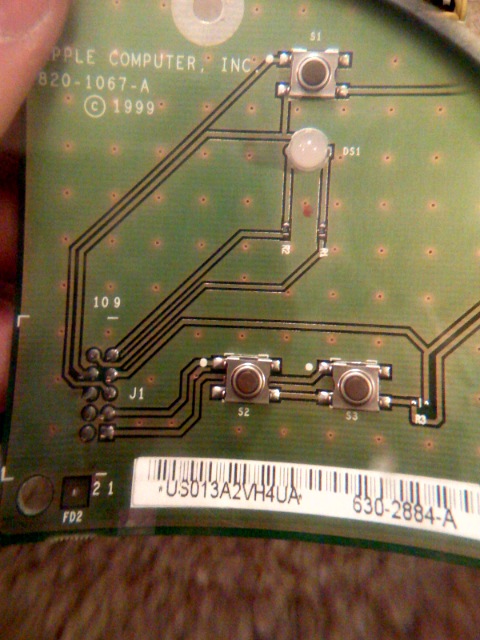

kernalzero Posted November 20, 2007 Share Posted November 20, 2007 I've got some of the power button/LED/reset front panel pin layout of the stock front panel board figured out...I've been playing with it. Once I get it all figured out and soldered I'll post pictures and instructions of the pin layout so you can rewire your stock board to work. I'll also post pics of my stripped case without a board in it so you can see how I mounted the board. (have one more thing to cut for my new TT PSU to fit) Pin Layout: 1 2 3 4 5 6 7 8 9 10 Power: Pin 3 & 6 (tested & confirmed) LED: Pin 1 & 2 (untested but the layout looks obvious) Reset: not sure yet, the reset button is the S2 button labeled on the board but the circuit is hard to trace where both the + and - are because the interupt (S3) button is connected too... we'll see and i'll play with it Link to comment Share on other sites More sharing options...

bonestonne Posted November 21, 2007 Share Posted November 21, 2007 full case with motherboard mounted on its own weight. it doesn't move around at all, so far all cables reach, and graphics card comes out with little flex or trouble. close case, showing tight limitations on the optical drive. i took off the optical drive door, a new paint job may be the solution, but i need to mount the optical drive to the case somehow...will have to figure something out. customized molex connector for the drive. this drive may be alone in the case because the power cable is shorter than i thought. i have the cable snaking under the drive tray so it doesn't get in the way anywhere. fully accessable back panel, i will be putting a plate here, it is only like that so i know what to cut. unrestricted power supply fan, however i'll still cut the stock fan guard off, it isn't needed. cables all make it neatly next to and past the fan without risking getting clipped by the fan. that small cable with a wire tie and shrink wrap over it is two spare wires from when i made the P8 connector for the fan, i had to cut off another connector, those wires were spare, i covered them, and made it so they couldn't cause a short. distance between CPU cooler and power supply. hopefully thats plenty for it and it doesnt get loud. motherboard mounting technique. there are two screws like that, i'm hoping to get a third, but its firm right now, so i'm not entirely worried about it. so far thats all, i'll be wiring the front panel now, and will get back with results [pass or fail]. with a combination of pictures, a 15W soldering iron, and a dab of silver solder, we have life! after ever so carefully soldering, that, and the reset button were wired, as well as the green portion of the LED. for the LED, i couldn't find another way other than guess and check, top and middle will be green, middle and bottom will be yellow. i cannot test the reset button yet, but i'm hoping that it works at this point. even without RAM, the system powers on, as well as the fans. the 120mm case fan inside the case turned on effortlessly and silently, the power supply fan did not start when the header was plugged into the motherboard, most likely due to the fact that the motherboard could not control the fan [as it has no RAM and cannot get past POST. there's the system powered on, no RAM, however the board did start, telling me that my soldering job works well. the hard drive does not make much noise or vibrations, so it was hard to tell it was on, but its powering on as well without trouble. well lit power on light, looking very good so far, with the bulk of the work done on it. the rear of the case while powered on, looking neat. power cable has no trouble getting to the power supply, the light is only on when the power supply is on. project is coming along very nicely.just the back plate for the motherboard and optical drive are left for the finishing touches. approx. time spent so far on this project = 12 hours Link to comment Share on other sites More sharing options...
