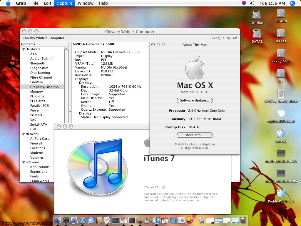

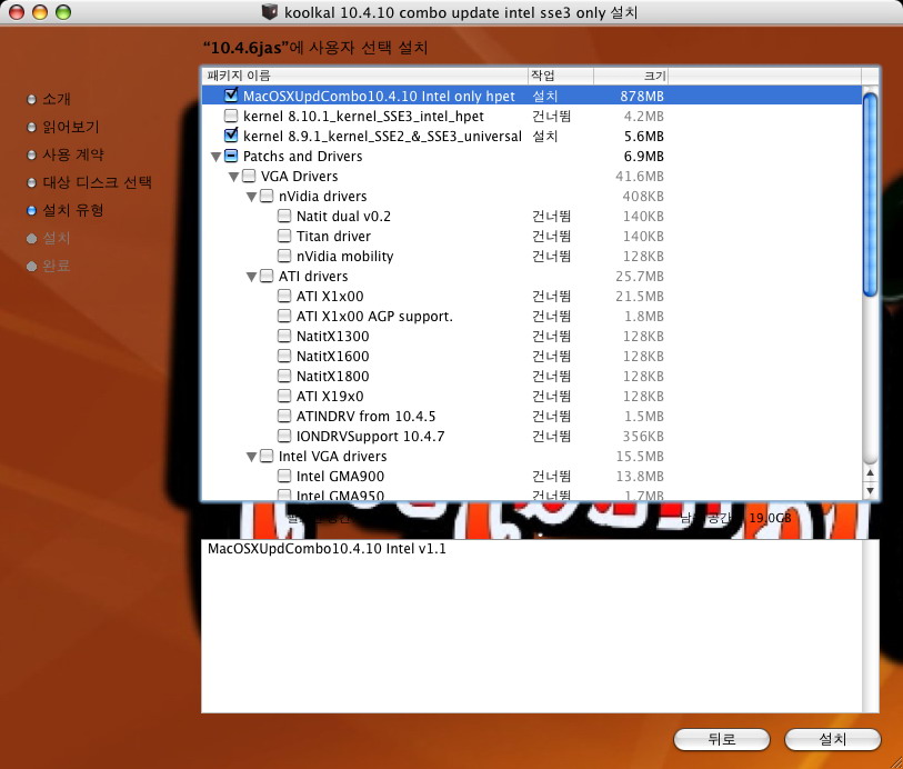

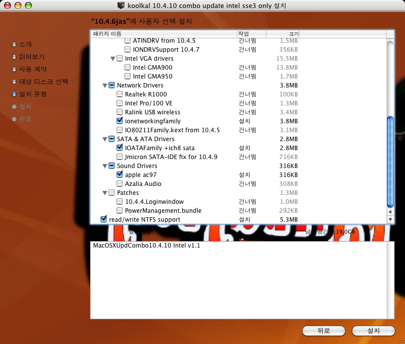

chival4ry Posted July 15, 2007 Share Posted July 15, 2007 Hi, all. First of all, I thank koolkal for his nice work! -------------- Details for koolkal 10.4.10 intel combo sse2 & sse3 V2 ( Demonoid ) Created by koolkal 22 hours ago (2007-07-15) UPDATE koolkal 10.4.10 intel combo sse2 & sse3 V2 choose kernel 8.10.1 sse3 intel hpet or kernel 8.9.1 sse2&sse3 (universal) !!! INTEL SSE3 HPET only & SSE2,SSE3 (universal)!!!! i haven't test it on AMD because i haven"t AMD pc for test !!! automatic backup of extenstions folder in /backup/extensions/ automatic backup of kernel in /old automatic repair befor & after! original 10.4.10 apple combo + various patch : jmicron/ ioata enhanced/+ich8 sata support/ gma 900 & 950 patch inclu/ ac97/ionetworking + 10.4.4 login window from jas! nvidia and ati drivers/ azalia sound drivers /ntfs read write support/ wifi and ethernet support! i added some drivers packages from uphuck dvd 1.3 ! all in one!!! installer designed for 945 mobo should workin for other! thx to jas semthex netkas myzar uphuck and all the other!!! use it at your own risk!! and post your comments! UPDATE YOUR TRACKER install apple smbios fixe from netkas! good luck!!! Size: 319.70 MB ------------------ BTW, after rebooting, I look at " panic (cpu0 caller 0x003AB83F) : Unable to find driver this platform : "ACPI". " and "4-languages(You need to restart your computer. ~~) -My system : 2.4c(sse2), nvidia 5600, 1024 ram, asus p4p 800 I was using 10.4.8. ( Jas 10.4.6 iso + Some Mac OS X 10.4.8 Combo Update (Intel)[Pacifist] + JaS.10.4.8.Intel.SSE2.SemtheX.Beta9.dmg +Titan.kext(2006-11-4) ) ( http://forum.insanelymac.com/index.php?showtopic=36480 ) - My choice : default(no kernel 8.10.1 sse3 intel hpet) + kernel 8.9.1 sse2&sse3 (universal) + ntfs read write support Can you help me? ---------------- ----------------- [ Additional Info and Experience : 2007-07-17] ------------------ Although I succeeded in this work without koolkal 10.4.10 intel combo sse2 & sse3 V2, I got good knowledges thanks to this koolkal` patch. Above all, see sources, please, and this post was mostly wiritten for sse2. After trying Titan.kext, GeForce*, NVDA* on 10.4.6jas, I didn`t have additional works, but CI & QE appeared and appear on 10.4.8 & 10.4.9 & 10.4.10. ----- [1] 10.4.6 to 10.4.8 ( nylock10 ) [ source : http://forum.insanelymac.com/index.php?showtopic=36480 ] ( Jas 10.4.6 iso + Some Mac OS X 10.4.8 Combo Update (Intel)[Pacifist] + JaS.10.4.8.Intel.SSE2.SemtheX.Beta9.dmg +Titan.kext(2006-11-4) ) ----- [2] 10.4.8 to 10.4.9 ( Ahmad Moawya ) [ source : http://forum.insanelymac.com/index.php?showtopic=45283 ] (1) /system/library/coreservices/loginwindow.app (replacing) (2) /system/library/extensions/AppleSMBIOS.kext (replacing) (3) /system/library/extensions/AppleACPIplatform.kext (replacing) (4) /system/library/extensions/AppleAPIC.kext (replacing) (5) /system/library/extensions/IOATAFamily.kext (replacing) (6) /system/library/extensions/system.kext (no replacing because of a new mach_kernel.070506[8.9.1]) (7) /System/Library/Extensions/AppleIntelCPUPowerManagement.kext (removing because of 2.4c[no dual core - me]) ----- [3] 10.4.9 to 10.4.10 ( josh256 ) [ source : http://forum.insanelymac.com/index.php?showtopic=54678 ] (1) /System/Library/CoreServices/loginwindow.app (# cp -R) (2) /System/Library/Extensions/AppleACPIplatform.kext (# cp -R) (3) /System/Library/Extensions/AppleSMBIOS.kext (# cp -R) (4) /System/Library/Extensions/AppleAPIC.kext (# cp -R) (5) /System/Library/Extensions/AppleCPUThermo.kext (# cp -R) (6) /System/Library/Extensions/AppleThermal.kext (# cp -R) (7) /System/Library/Extensions/IOATAFamily.kext (# cp -R) (8) /System/Library/Extensions/System.kext (# cp -R) (9) /System/Library/Extensions/AppleIntelCPUPowerManagement.kext (# rm -R) ( I applied (1) ~ (9), btw, if there are unnecessary kext works, let me know, please. ) ( After this 10.4.10 work, and then, after rebooting 2 times, could see Desktop. ) ----- [4] the latest AppleSMBios.kext (netkas site : Google Search) by netkas @ 11.07.2007 13:53 CEST Few days ago I started work on new AppleSMBIOS.kext What fixed: - loginwindow crash, and no more need to patch loginwindow (as I previously made) - System Profiler work fine, without any patches. - CS3 works - CPU speed reading fixed (for loginwindow) updated - boot rom version identidy added to profiler output known issues Information abour memory banks reads wrong, but who cares ? ----- [5] System Profiler Problem Solution [ source : http://forum.insanelymac.com/index.php?showtopic=55525 ] --------------------------------------------------------------------------------------------------------- Thanks, Jas, nylock10, Ahmad Moawya, josh256, koolkal... ---------------------------------------------------------------------------------------------------------- Link to comment Share on other sites More sharing options...
kaly Posted July 15, 2007 Share Posted July 15, 2007 hi ! have you deselect 8.10.1 kernel at the install? sorry i haven't seen attached thumbnail ! what's your chipset ??? you can try to restore your AppleACPIPlatform.kext from /backup/extensions/ Link to comment Share on other sites More sharing options...

Macnoobz Posted July 16, 2007 Share Posted July 16, 2007 i have a total failure updates using this koolkal 10.4.10 intel combo after updates completed & a reboot.......got a kernel panic i installed with "Kernel 8.9.1_kernel_SSe2/3_Universal" selection. My Current Kernel: System Version: Mac OS X 10.4.8 (8L2127) Kernel Version: Darwin 8.8.1 any idea? TIA Link to comment Share on other sites More sharing options...
