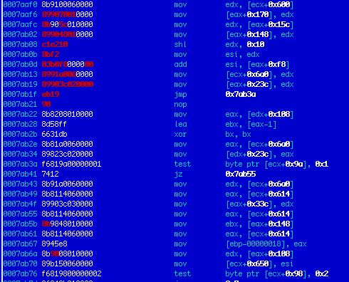

Slice Posted March 9, 2008 Share Posted March 9, 2008 OK! If you ready to help me and moreover to yourself I can tell you all details, answers and propositions. I collect huge number of informations. About reverse engineer - post #70 here, its result for ATIRadeon9700 - post#75. Very useful link (thanks to ensobelmont) http://dri.freedesktop.org/wiki/Radeon200M...goryHardware%29 There are other AMD documentation but not so useful. There are opensource Linux drivers but not reliable for MacOSX or simply wrong. About GMA900. Yes it also has shared memory but we also have no Mac sources of the driver, and Linux sources is far away from that we need. Ready to use intel drivers can't be used for Radeon. Link to comment Share on other sites More sharing options...

prepressman Posted March 10, 2008 Share Posted March 10, 2008 Questions:1. Video memory address is 58000000 or c0000000? 2. OpenGL memory address is 5c000000, or 60000000, or c8000000, or d0000000, or zero? 3. (170) must be OpenGL memory address? 4. What means (174) - AGP_CTRL, and (1c0) - ??? 5. How (f8) is used in the driver? Linux don't use it at all. Influence in MacOS you see in users trying. My Windows say this: Nome ATI Radeon Xpress 1100 Type of Bus PCIe Device identification PNP PCIVEN_1002&DEV_5975&SUBSYS_009F1025&REV_004&2C0D4F31&0&2808 Tipo de adaptador ATI Radeon Xpress Series (0x5975), compatible with I DETAINED Technologies Inc. Description of the adapter ATI Radeon Xpress 1100 RAM memory of the adapter 64,00 MB (67.108.864 bytes) Entry of the table of colors 4294967296 Resolution 1280 x 800 x 60 Hertz Bits/Pixel 32 Memory address 0xC8000000-0xCFFFFFFF Porta de E/S 0x00009000-0x00009FFF Memory address 0xC0100000-0xC010FFFFF Channel IRQ IRQ 17 Door E/S 0x000003B0-0x000003BB Door E/S 0x000003C0-0x000003DF Memory address 0xA0000-0xBFFFF I hope that this help in something... Link to comment Share on other sites More sharing options...
Slice Posted March 10, 2008 Share Posted March 10, 2008 My Windows say this: Memory address 0xC8000000-0xCFFFFFFF I hope that this help in something... If it is so simple I shouldn't be asking. I try the address and got black screen. When I use 0x50000000 I can boot. So as fglrx! Exercize 2: Trying to follow ATIRadeon9700 I got next calculations ( vars Xn - calculated here, Yn - elswere): (170)=Y830 -- obtained from AGPGart, else = 0; X0=0 (15c)=0 (23c)=X0 (33c)=X0 (43c)=X0 (148)=((f8)-1) & ~0xffff; -- register F8 used before init. X1=(f8) X2=X1+Y828 -- value Y828 is AGP_memory_size, else RAM_memory_size (14c)=(X2+Y828) & ~0xffff + (X2 >> 16); (1dc)=X1 (1e0)=X2 - 1; (700)=X2 + Y8ec -- address of RingBuffer (774)=X1 + Y8bc -- SCRATCH_ADDR (15e0)=0 -- SCRATCH_REG0 -- depends on presence of GA.plugin Question: How It can works if zero addresses are never the same as Fglrx addresses and not the same as IODeviceMemory addresses obtained from ioreg or from Windows? No more tests, no more trying. I still waiting a man who answer the questions. Link to comment Share on other sites More sharing options...
prepressman Posted March 10, 2008 Share Posted March 10, 2008 I try the address and got black screen. When I use 0x50000000 I can boot. So as fglrx! Ok, But exist 3 memory address, Why do you used only the first? For you show the black screen, may be for not. Send me this .kext 9700, for to make test. who know? . Do you will wanna my ioreg to compare? Link to comment Share on other sites More sharing options...

prepressman Posted March 11, 2008 Share Posted March 11, 2008 I have no ready to use 9700.kext with other addressing because I see no sense to prepare it (not easy work). I make for myself patched 8500.kext. Exactly the same problem! OK, I understand you. Do you already in chance the new .kext ATIRadeonx2000 of the Leopard? This is a new generation of .kext, I think that is a update of the .kexts R4xx. Link to comment Share on other sites More sharing options...

Amiga 4000T Posted March 15, 2008 Share Posted March 15, 2008 Well, I make more two test about this binary. ---First--- I had make patch in the ATIRadeon9700 of the OSX 10.4.4 and result was: QE/CI supported, but when I open and move any Window they are transparent and slow too. How posted previously. ---Second-- I make patch in the ATIRadeon9700 of thr OSX 10.5.2 and result was: QE/CI unsupported and after boot the everything stay very slow. ---Third--- I make patch in the ATIRadeon9700 of thr OSX 10.4.8 and result was: some that first test. All test was make with ATISlice.kext and IOPCIFamily patched. - Why don´t work in OSX 10.5.2? - Why the windows no work in the OSX 10.4.4 and 10.4.8? Do you have any idea? Thanks ance again Slice. How to make patches for ATIRadeon9700.kext? Need some progaramma detail? And then this procedure experimental and even if I could run to turn qe/ci us on my ati x200 5955? Tell me about. Thanks Link to comment Share on other sites More sharing options...
