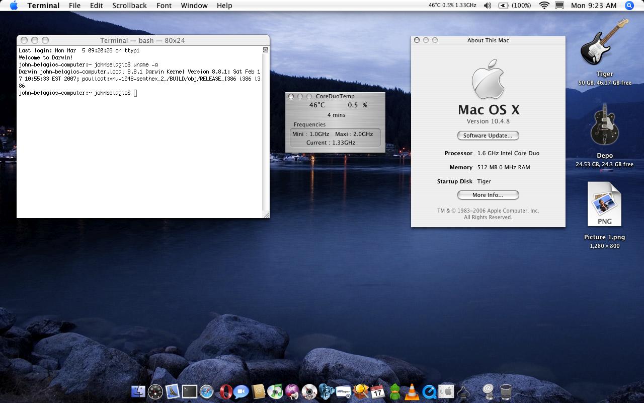

Eskurza Posted March 5, 2007 Share Posted March 5, 2007 (edited) oh it is working perfectly.. the fans kick in when the temp. reaches 49 or so.. temperature usually around 45 Depending on the load, the cpu speed modifies 1.33Ghz, 1.67Ghz, 2.0Ghz..with the dynamic setting. no go on the sleep though. Edited March 5, 2007 by Eskurza Link to comment Share on other sites More sharing options...

Eskurza Posted March 6, 2007 Share Posted March 6, 2007 yup I realized that feels good already. Temperature values around 42-45C, I will keep testing as they become availble Link to comment Share on other sites More sharing options...
