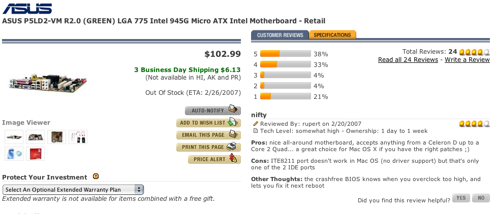

DiaboliK Posted February 21, 2007 Author Share Posted February 21, 2007 this is quite funny... im not the only one who reccommends this board for OSX Link to comment Share on other sites More sharing options...
