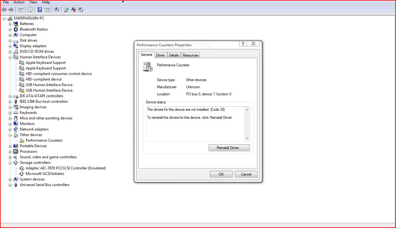

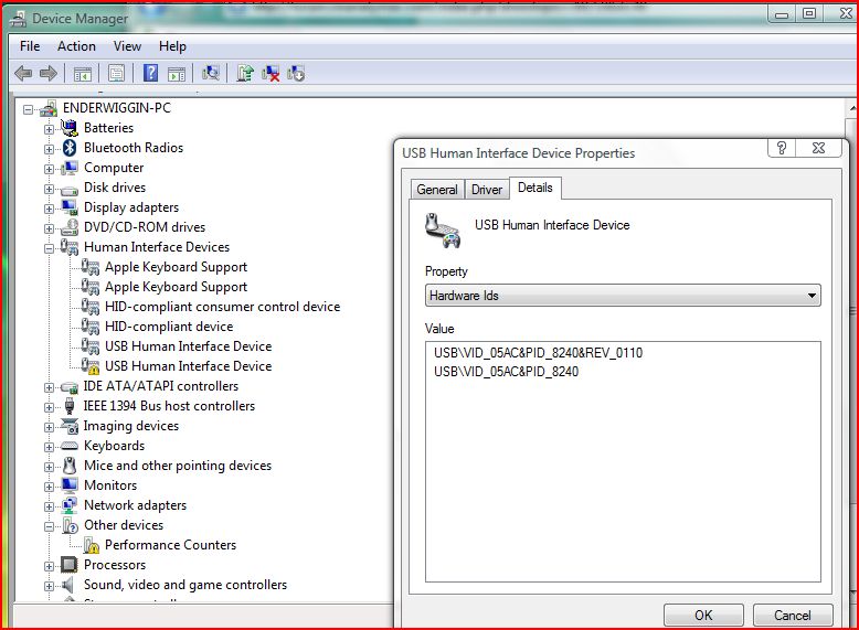

xxxin Posted February 3, 2007 Author Share Posted February 3, 2007 Please help to put the screenshot of your device manager here. And please also check the hardware IDs of all the non-working USB devices and list them. Link to comment Share on other sites More sharing options...
huntergreenoz Posted February 3, 2007 Share Posted February 3, 2007 Here's a screenshot of the 2 devices on me machine. Link to comment Share on other sites More sharing options...

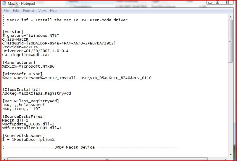

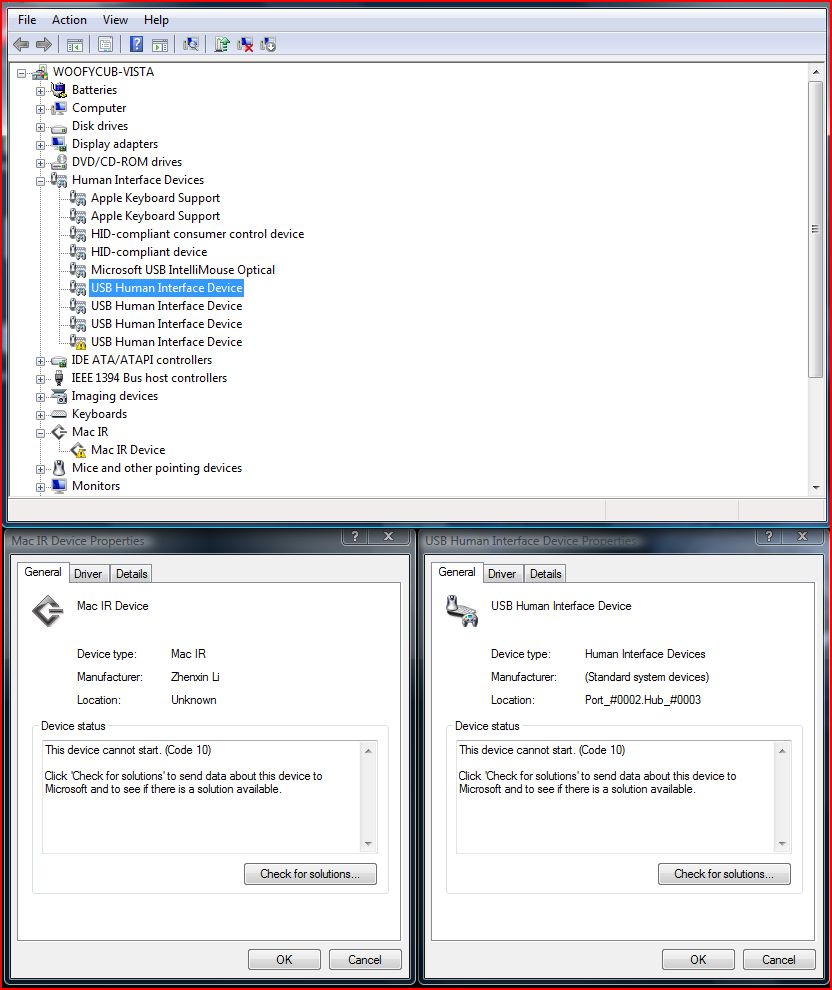

Straffaren Posted February 3, 2007 Share Posted February 3, 2007 Hi, I tried the driver on a powerbook (also running Vista Ultimate) and it's the same thing there: the system cannot find the file specified. It doesn't say anymore than that. My log file on the mac mini shows that it returns with "InstallStatus 2", but that's all the info I can find, it doesn't say which file is missing. I looked in the inf file and found references to a wudf.cat which I can't find anywhere on the system, maybe that's nothing, I'm just poking around. However, I know Vista has copied at least one file because in c:\windows\system32\drivers\UMDF there's a MacIR.dll. Do you know if there's a log file that shows exactly what files are missing? Link to comment Share on other sites More sharing options...
bloodmyst Posted February 3, 2007 Share Posted February 3, 2007 Here's a screenshot of the 2 devices on me machine. Are you installing this thing the right way? It makes a difference as to whether you're using the Install Hardware wizard in Control Panel versus the Device Manager, etc. Check out my previous post detailing what I needed to do to install the driver correctly. I was having this same problem before I installed it a certain way. Link to comment Share on other sites More sharing options...

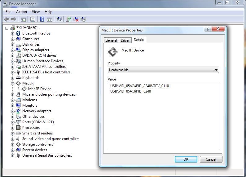

xxxin Posted February 4, 2007 Author Share Posted February 4, 2007 Hmm, I post my screen shot here. 1. The hardware ID might be different across different Intel Mac models. 2. Before installing the driver, Mac IR device should be shown as "USB human interface device" with a exclamation mark in Vista device manager. 3. If you have multiple exclamation marks in "Human interface devices" section of the device manager. Change the hardware ID in MacIR.inf and try to install the driver on all the devices with the exclamation mark. My environment. 1. Intel Mac Mini Core Duo 1.66G(T2300). 2. Vista Ultimate 32bit. 3. I didn't install any drivers from Bootcamp CD except the audio driver from Sigmatel. Link to comment Share on other sites More sharing options...
baltar27 Posted February 4, 2007 Share Posted February 4, 2007 Hmm, I post my screen shot here. 1. The hardware ID might be different across different Intel Mac models. 2. Before installing the driver, Mac IR device should be shown as "USB human interface device" with a exclamation mark in Vista device manager. 3. If you have multiple exclamation marks in "Human interface devices" section of the device manager. Change the hardware ID in MacIR.inf and try to install the driver on all the devices with the exclamation mark. My environment. 1. Intel Mac Mini Core Duo 1.66G(T2300). 2. Vista Ultimate 32bit. 3. I didn't install any drivers from Bootcamp CD except the audio driver from Sigmatel. I checked the MacIR.inf file and it matches the first value but the second one is missing... it is under the human interface w/ exclamation mark. What can i do to correct it meaning does it need the second value? Should i uninstall the other drivers from the bootcamp CD? i installed them all using microsoft intallation tool. the exe wont run still... here are screenshots of both the MacIR.nf and the value of the hardware id Link to comment Share on other sites More sharing options...
