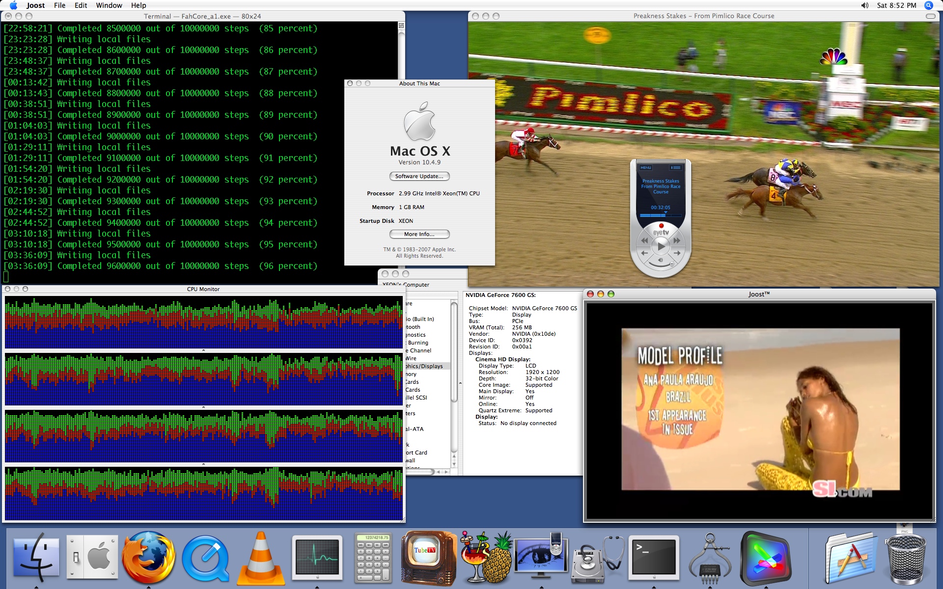

hrfforlife Posted May 27, 2007 Share Posted May 27, 2007 Tyan Tempest i5000XT Geforce 7600GS 256mb PCIe JaS 10.4.8 SSE3 + JaS 10.4.9 Combo Update Link to comment Share on other sites More sharing options...
