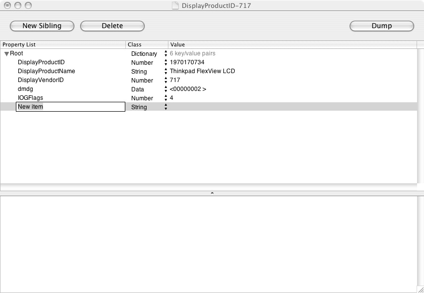

Now let us suppose you want to add those data in a DisplayProductID-xxx file. How to do?

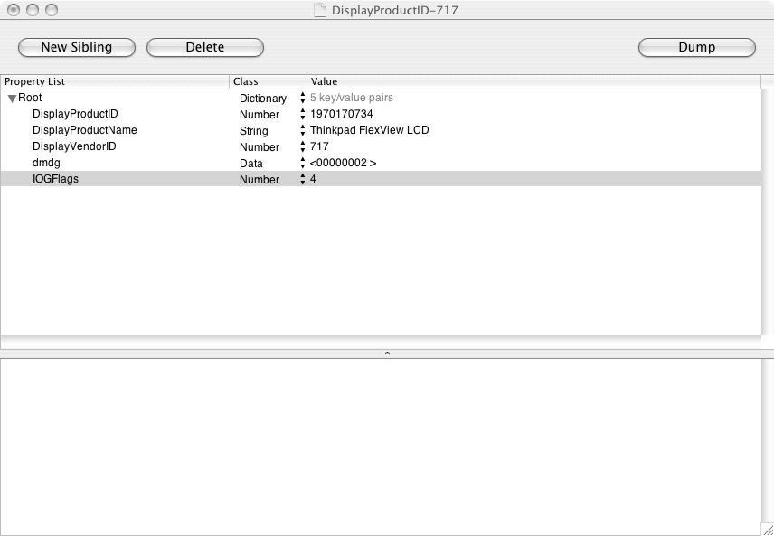

Launch the Property List Editor, open the relevant file as in this example:
you see that properties are:
1) hierarchically organized;
2) consisting, each, of:
- a property name
- a type of data
- the value of the data
Now, in the case of DisplayProductID-xxx files, the name of the new property to insert is "IODisplayEDID", the type of data is "Data" and the value of data is the string you have manually prepared before.
We will now insert the new property.
First, click "New Sibling" button, it will create a new empty property:

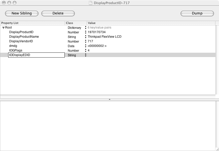

Then, doubleclick on the property name field and type "IODisplayEDID":

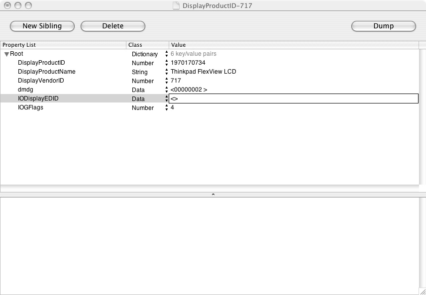

Now set the property type as "Data" by using the pop up menu in the "Class" column, then click in the value field:

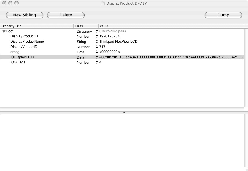

Finally, paste the string of the EDID data:
That's it, save and exit.

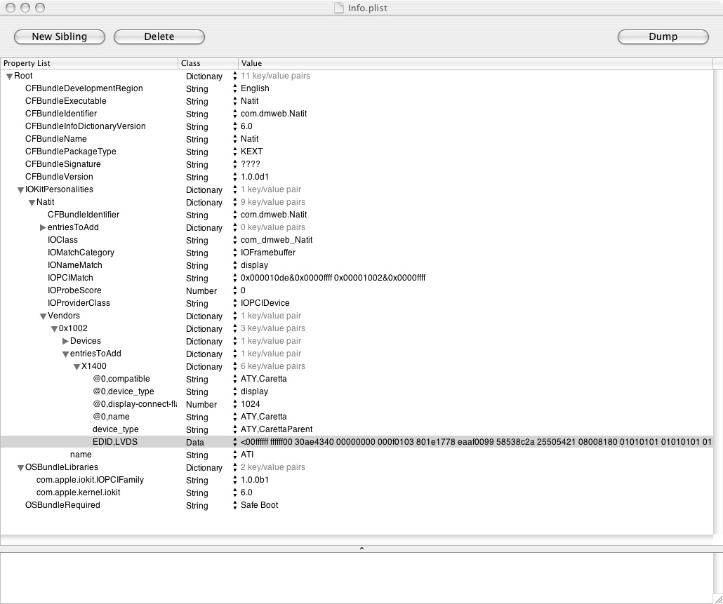

In the case of Natit, for my ATI X1400 I had to insert the EDID data as shown in the following screenshot, but I do not know what is the correct property name or its hierarchical location for other cases (e.g Nidia cards).
great guide
for NVIDIA natit property for EDID (internal display ) will be "@0,EDID" <....>
