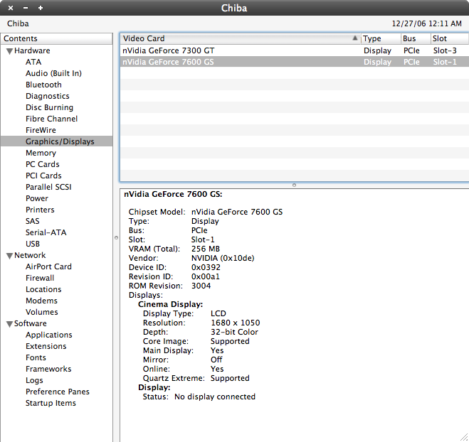

I just tried Legends74's method and my MSI 7600 GS works like a champ. I had no luck before when I tried just putting the 7600 in there. After I put the 7300 in slot 3, it worked like a champ! :)
So happy.
Attached File  Picture_1.png   88.41K   139 downloads

Oops, I actually meant to comment on that...
Yes it behaves exactly as my 7300 does. Option brings up the OS select and everything. The first boot did have the monitor rotated 90 degrees, but selecting detect displays does fix it and you dont have to deal with it again. I'm goign to test multi monitor setup tonight.
