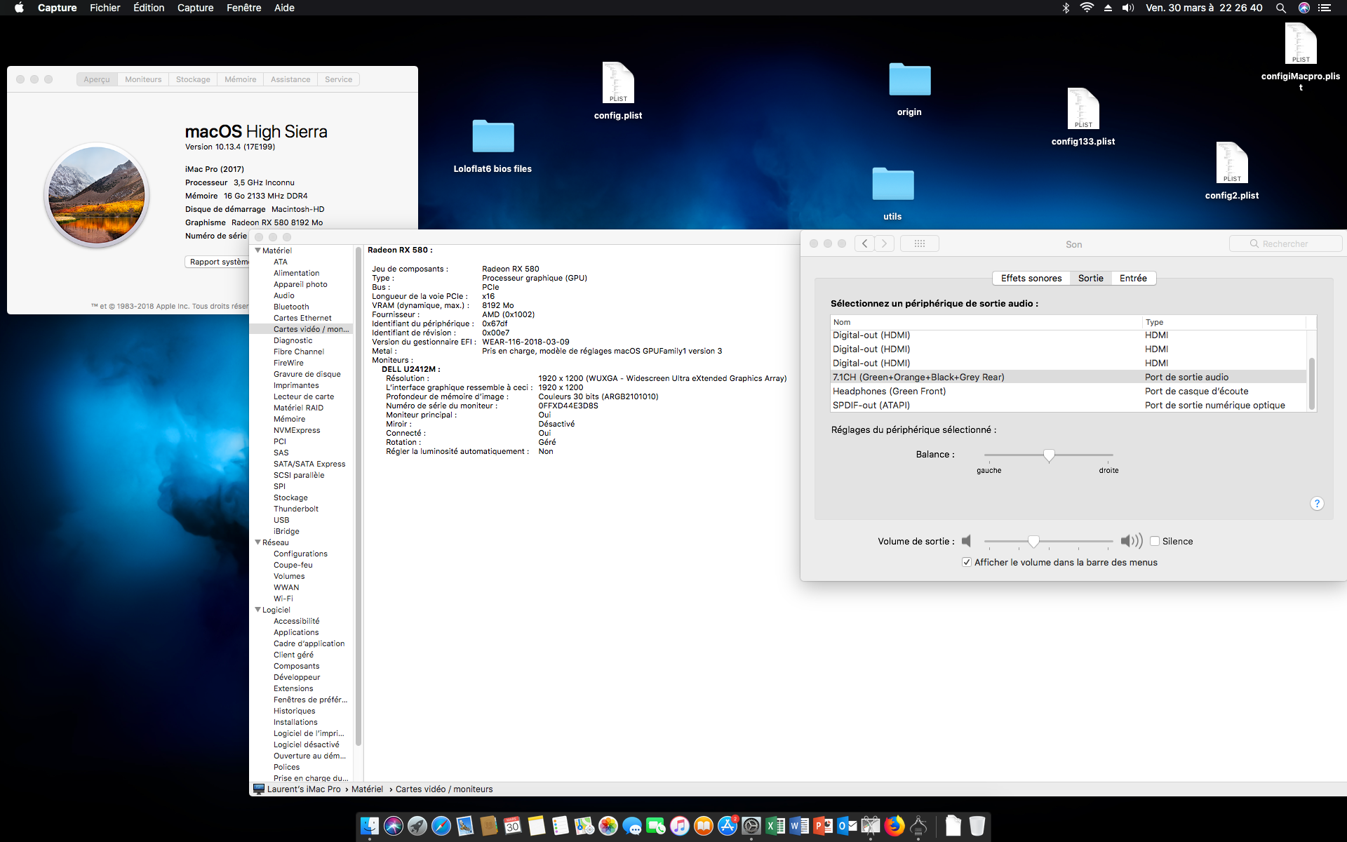

Bingo Amd is fully supported :
Boot without inject Ati or radeondelnit or Watevergreen.kext  :thumbsup_anim:
Sleep and wake by one clic on mouse with no issue .

Some words about my settings to have sleep and wake with no issue. (also with Bluetooth 4.0 WI-FI PCI Express (PCI-E)-Carte Combo BCM94360CD )
1/ System preferences :
Just checked suspend hard drive activity as soon as possible
2/ EFi/Clover
  - Kexts : XHCI-200-series-injector.kext and USBinjectall.kext (latest Rehabman's release )
- ACPI/Patched :
   - custom SSDT for USBinjectall.kext ( very important for usb internal 255 power management for WIFI PCI )
  "SS01", Package()
                        "UsbConnector", 255,
                        "port", Buffer() { 17, 0, 0, 0 },
May be different for other mobo also see in your Ioreg
   - ssdt.aml for CPU power management
- config.plist :
    - darkwake=0
    - SSDT :
        - PluginType checked
        - Plugin Type 1
        - PLimit Dict 0
3 / Bios  : disable wake on lan
4 / GPU : full support for Amd RX 580 right now ; full acceleration , fans are stopped when GPU is quiet and running after if needed ( exit Radeondelnit or Watevergreen or inject Ati)
What happen then :
- Screen saver on five minutes
- Screen off about three minutes after screen saver
- Sleep about two minutes after
- Sleep : all is turned off ( only magic leds from mobo and led from WI-FI PCI Express are lighted )
- Wake :  right clic on the mouse or press one touch on keyboard
- All works well with no issue ( with or without lockscreen).
If this could help others.
Edited by Loloflat6

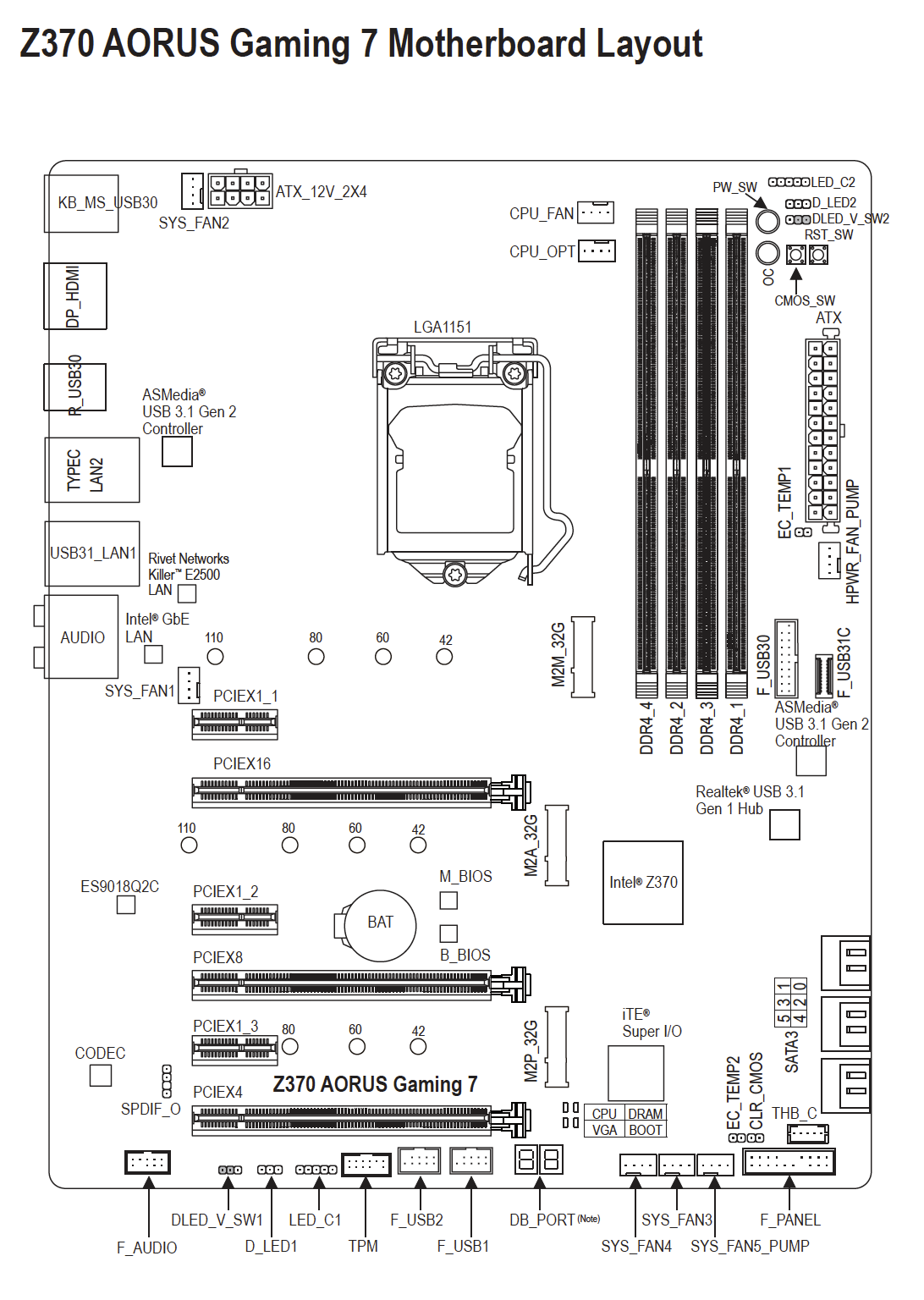

Hi, KGP! Thanks for your dedicated amazing work!
I have a different system like Coffelake with Gigabyte Z370 board. But your guide made my computer in the best mode so far.
I have worked on PCI implement section. And I am so noob of coding thing. If I understood correctly, you have Asus board and I have Gigabyte one and both are totally different PCI slots and mapping. But it is possible to make my PCI information correctly with your SSDT and the method of implementation you described?
Btw, I am not a rich person but I would like to give you a good cup of coffee time for your dedicated work.

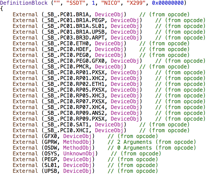

@KGP-iMacPro Hi,
Thank you for reply and wish for me.
I do not think your SSDT-X299 iMac Pro.aml is not compatible with my MB.
I just started with GPU part. I changed ACPI DSDT at Clover configurator.
PEGP->GFX0 and it is good to change display part in my IOREG.
5acafd4b9f1d3_ScreenShot2018-04-08at10_42_21PM.png.1d89c7fb8b9fbfbcbf90c2013e4ac566.png
And editing in SSDT, I changed DefinitionBlock part like this
5acafdff9673b_ScreenShot2018-04-08at10_45_07PM.png.f034a41137a06b80cce986de096453ff.png
And Scope part like this. (Vega 64 in slot 1)

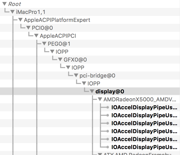

I guess 'slot-1' is cosmetic part right? If you see my Board map, I put my GPU first PCIe x16 slot which is second PCI slot. So I put 'Slot-2'
5acaff229390a_ScreenShot2018-04-08at10_49_48PM.thumb.png.cfd8231b16a83272aae0f30088dba822.png
However, PCI information said there is no PCI devices installed in SP.
Do you what is the problem?
Sorry my English so bad.
Joo Hyun Grace
