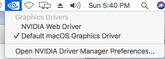

cold boot is working now
I have a non working Nvram (as always) but I don't use any script or emu variable to have Nvidia dev set to 1
now (system starts fine but with osx default Nvidia driver as you can see)
try by now to reselect it and reboot..

Nice, thx for the report. For nvram I cannot say much, there still are appear to exist motherboards where it does not work. Generally the case is ASUS whitelist, which requires flashing an older nvram driver, but honestly there may be other issues too. All of them are almost certainly our of the scope of AptioMemoryFix, however.
I know about your efi scope and I was reporting it because for me from RC5 it helped so much in automatic way
By the way I have also CSM enabled which is adviced to disable in read.me
For me now is working well and after a reboot Nvidia driver is set fine again to Webdriver option
Thank you again

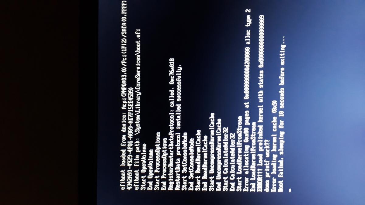

Hi, I'm struggling with my mobo which has always been awful regarding memory issues.
So far, only the 1st OSXAptiofix version got it to boot, from time to time.
It was broken with 10.13.1, ok with 10.13.2, then broken again with 10.13.3.
I tried to use the version 2 and calculate a slide value. Here's what I did :
Located this area that seemed to be sufficient :
available  000000000CF06000-00000000AD737FFF  00000000000A0832 000000000000000F
Calculated :
CF06000 - 100000 = CE06000
CE06000 / 200000 = 67
Did it backward to verify and noticed I had to increase it to 68.
Used slide=104
Problem is stil the same (error allocating blah page blah…)
Is there something I miss ?
Try increasing it one by one until it works. Or let the automatic choose for you.

Hi Apianti, I already tried all the aptio fixes with no succes. I also tried with 105 but I'll try again increasing it more.
Try only using either of those two drivers, try every single slide if you have to, it may take a while but just to rule it out. There might be something else going on there. Does it tell you where it failed to allocate the memory? Like the address and how many pages? Did you try the AptioFix from here with no slide value, letting it choose one?
Are you sure the memory is free at 0xd200000? Did you check the memory map after you entered clover GUI from EFI shell? Is it consistent? Also use AptioFix from this topic or AptioFix3 from the installer (they both may be in the installer?). Fix1 and Fix2 are inherently broken...
EDIT: Post your memmap from EFI shell after clover GUI.
There are several versions of the EFI shell you can try but I don't see why it would crash from clover but not the firmware, are there drivers being loaded that are causing problems? You need to put it in the tools folder and name it specific names to be found. Also make sure that GUI/Scan/Tool=true in config.plist. You need the memory map from after clover has reached the GUI, it's useless otherwise. Have you tried AptioMemoryFix without a slide letting it calculate one for you?
The shell stopped working years ago, somewhere before builds 2000 of clover.
Ok, gonna check all that.
Edit : ok the scan option brought it back but it still crashes. I get a fix cursor on the upper left corner. I think it's again a memory issue because it does launch fine from clover in legacy mode.
