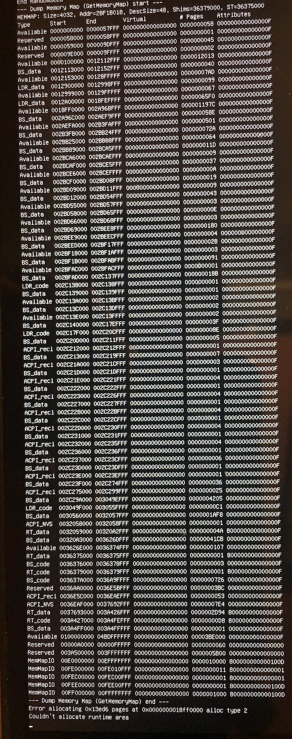

Sorry for coming back with a question. When I was under 10.13.x, everything started normally.
And when I want to test install 10.14, the following picture occurs.
My configuration is
CPU: i7-8700k
Motherboard: asus m10h
Memory: Corsair 8g*2 2400hz
Hard Drive: Samsung 960evo 250g
Graphics card: RX480 8G
used kext:Lilu IntelGraphicsFixup IntelmausiEthernet Shiki WhateverGreen Fakesmc
I'm sorry, my English is not very good. This is translated from Google。
Thank you in advance for the Great God。

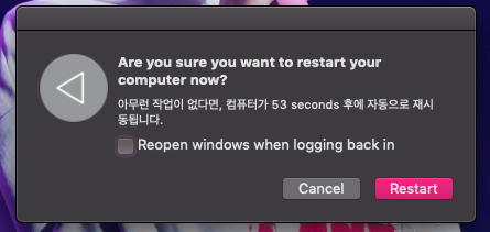

@vit9696
hi. i want to report potential language issue between clover and aptiomemoryfix.
long time ago, i reported this issue in clover thread. but still there is issue.
first, to avoid this issue, always use OsxAptioFix2Drv + EmuVariableUefi-64.efi + set ko(config.plist).
https://sourceforge.net/p/cloverefiboot/code/HEAD/tree/rEFIt_UEFI/Platform/DataHubCpu.c#l212
today, i tested only your driver aptiomemoryfix without EmuVariableUefi and cleanup before update beta6.
this issue happen
1. installing => not keep korean language. always shown english. in recovery, too.
2. restart popup after install beta6. popup shown korean + english combination.
i checked realmac nvram dump
bluetoothInternalControllerInfo
000000: 95 82 ac 05 00 00 00 00 78 4f 43 7a 8c 80        |........xOCz..|
multiupdater-0
000000: 54 00 68 00 6f 00 72 00 55 00 74 00 69 00 6c 00  |T.h.o.r.U.t.i.l.|
000010: 2e 00 65 00 66 00 69 00 00 00 2d 00 67 00 20 00  |..e.f.i...-.g. .|
000020: 2d 00 6f 00 20 00 2d 00 73 00 72 00 20 00 31 00  |-.o. .-.s.r. .1.|
000030: 20 00 30 00 20 00 2d 00 66 00 73 00 20 00 65 00  | .0. .-.f.s. .e.|
000040: 66 00 69 00 2d 00 61 00 70 00 70 00 6c 00 65 00  |f.i.-.a.p.p.l.e.|
000050: 2d 00 70 00 61 00 79 00 6c 00 6f 00 61 00 64 00  |-.p.a.y.l.o.a.d.|
000060: 31 00 2d 00 64 00 61 00 74 00 61 00 20 00 2d 00  |1.-.d.a.t.a. .-.|
000070: 67 00 20 00 2d 00 6f 00 20 00 2d 00 73 00 72 00  |g. .-.o. .-.s.r.|
000080: 20 00 30 00 20 00 30 00 20 00 2d 00 66 00 73 00  | .0. .0. .-.f.s.|
000090: 20 00 65 00 66 00 69 00 2d 00 61 00 70 00 70 00  | .e.f.i.-.a.p.p.|
0000a0: 6c 00 65 00 2d 00 70 00 61 00 79 00 6c 00 6f 00  |l.e.-.p.a.y.l.o.|
0000b0: 61 00 64 00 32 00 2d 00 64 00 61 00 74 00 61 00  |a.d.2.-.d.a.t.a.|
0000c0: 20 00 2d 00 6e 00 6f 00 72 00 65 00 73 00 65 00  | .-.n.o.r.e.s.e.|
0000d0: 74 00 20 00 00 00 00 00 00 00 00 00 00 00        |t. ...........|
prev-lang:kbd
000000: 72 75 3a 30                                      |ru:0|
LocationServicesEnabled
000000: 01                                               |.|
in realmac, there is prev-lang:kbd variables.
vit9696, did you always use only english in macos? no default russian? i wonder whether you experience this issue like my issue.
I have no experience with RealMac.
What I'm wondering is that after you first purchase a Mac, when you select a language on the Settings screen, will the language you selected be recorded in NVRAM? I wonder if the record is prev-lang: kbd.
Or I wonder if prev-lang: kbd is specified according to RealMac which is released in each country. This is not clear, so it seems that the problem I am experiencing is present.
sorry for my bad english
thanks in advance
Edited by Sherlocks
This is a macOS bug. I also have it. Unless the initial installation has prev-lang:kbd set to a correct local language, all the subsequent updates may break the locale of the operating system. If you google it, you could find several reports on apple forums and in other places. Apple Radar is your friend.
  • Like 3
okay. i have to keep emul option to avoid language issue. thank you so much:)

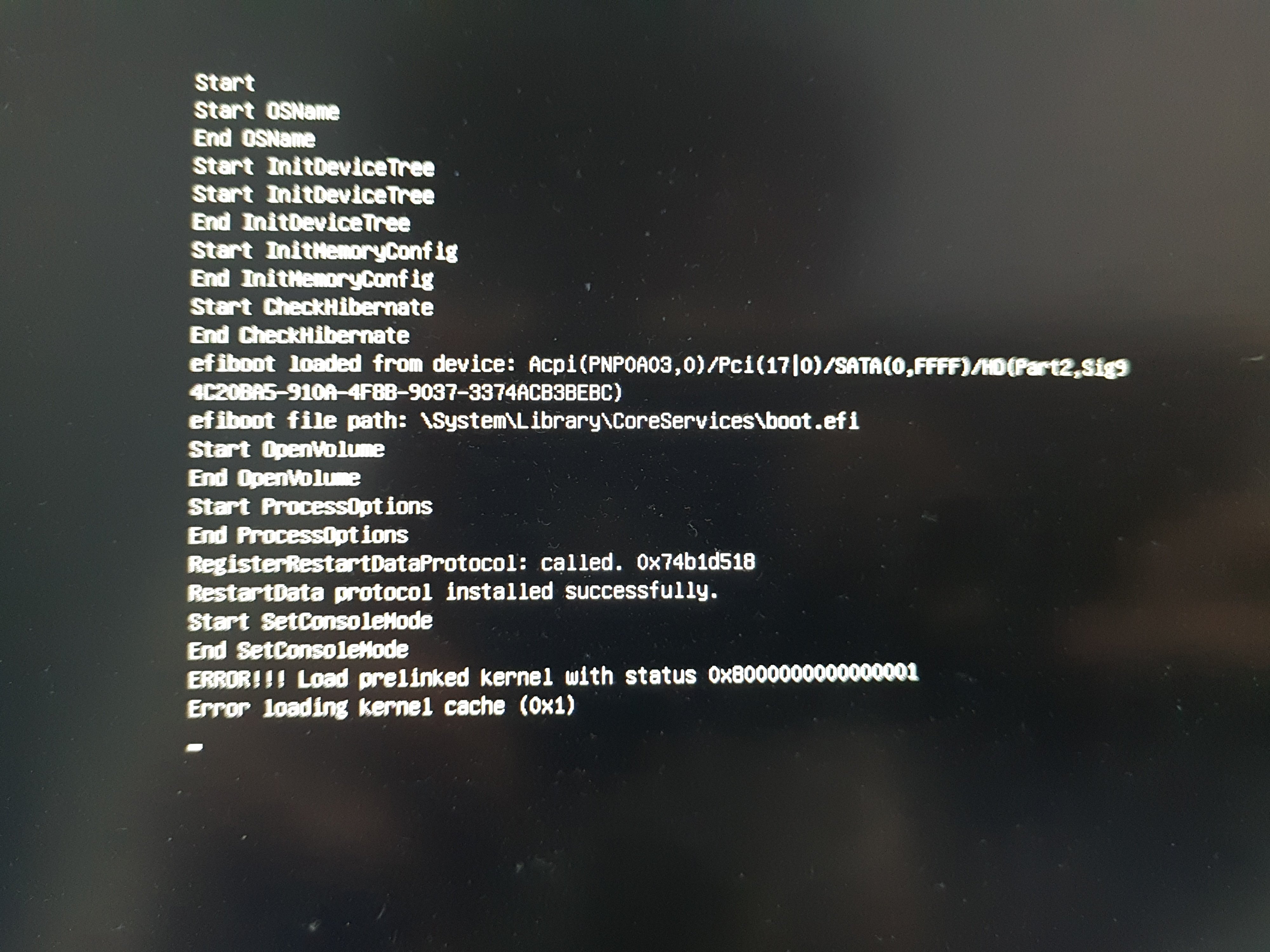

I have a problem starting boot.efi on an FV2 APFS partition. I have signed the boot.efi with the secureboot keys and can only get the graphics to work when I enable CSM in the BIOS.
Without CSM and with or without FASTBOOT,  MOHandleProtocol doesn't find the GOP (Graphics Output Protocol) on any file descriptor. I managed to find one at startup and save a that value, I checked the framebuffer address too and zeroed it so that I knew that it was valid but still no graphics output.
Without my changes I get an 0xE unsupported error. Adding the GOP manually gets me a display that is doing nothing. I can see two calls to the GOP device and no calls to any of the GOP methods.  Normally you see only the Blt call being made when things work.
Anyone have any ideas? The BIOS isn't going to be flashed on this device as I am currently repurposing int.
Hi, I think it is not related to secure boot, but most likely your BIOS firmware does not properly implement GOP and uses UGA to draw the onscreen content. Perhaps some of the newer code expose parts of GOP (e.g. ConSplitter) but it does not guarantee that t is functional. I would suggest you write a shim betweeen GOP and UGA and submit it as a patch if it works out.
See https://github.com/tianocore/edk2/blob/master/MdePkg/Include/Protocol/UgaDraw.h.
