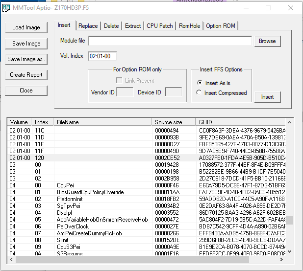

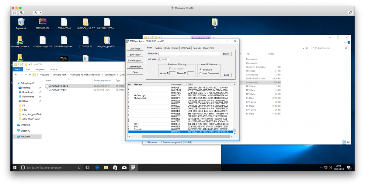

DO NOT USE THE OzmosisToolKit (this equals OZMTool)!!! "Why" you may ask? Here is the answer:
When you look at your usual rom, you will find 5 volumes in your Bios. The second one is the DXE Driver volume and thus takes all the Ozmosis files that are being inserted. Here you can see my original rom's last file of that volume and the following volumes (image is longer, but does not fit to screenshot):
This is the modified version:
This file ends right under the marked spot. The following volumes are missing! I think this is because of the following:
OZMTool tries to insert more than possible. This effects, that the 2nd volume is being resized (grown, others shrink) and this effects the other volumes to become invalid and thus they disappear. You would be able to flash this rom, but (!!!) your Bios will not be able to see any further Devices. If these are hard drives, USB sticks, dvd drives, whatever. They just can't be accessed and, resulting from this, also not booted. So you basically aren't even able to flash a new rom, because your bios does not see any external or internal drives. Do yourself a favour and leave this tool for AMI 4 Bioses (if this is the plural form...) and use MMTool instead. It might be more safe. OZMTool uses the engine of UEFITool, so try to avoid that as well maybe. I've had these problems before. Or, if you do want to work with these, check the volumes using MMTool afterwards. You can cause immense damage to your Bios
Furthermore this OZMTool doesn't even work with Skylake Roms because of the indifference of the AMIBoardInfo UUID. In AMI 5 roms this uuid is different than in AMI 4 Bioses (and it is called AMIBoardInfo2). Because of this, OZMTool can't access all the volumes and insert the files. After modifying the UUID it works, but still: You damage your rom!! Don't try to flash this!!!!
