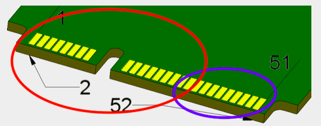

foskvs Posted November 11, 2017 Share Posted November 11, 2017 Humm.. Interesting even mini pci devices have to be shown as USB? Not true. Combo cards consist in a wifi chip + bt chip. Wifi is connected through PCIe bus and BT is connected through USB2. Approximately, the blue part is the USB2 connector and the red part is the PCIe one. Does BT work under Windows? If the answer is yes, attach open IORegistryExplorer, co to File -> Save As... Attache the file created. IORegistryExplorer.zip Link to comment Share on other sites More sharing options...
garti Posted November 11, 2017 Share Posted November 11, 2017 Not true. Combo cards consist in a wifi chip + bt chip. Wifi is connected through PCIe bus and BT is connected through USB2. Approximately, the blue part is the USB2 connector and the red part is the PCIe one. Schermata 2017-11-11 alle 21.51.34.png Does BT work under Windows? If the answer is yes, attach open IORegistryExplorer, co to File -> Save As... Attache the file created. I Got this error Error You aren't permitted to upload this kind of file I PM the link to download the output. Link to comment Share on other sites More sharing options...

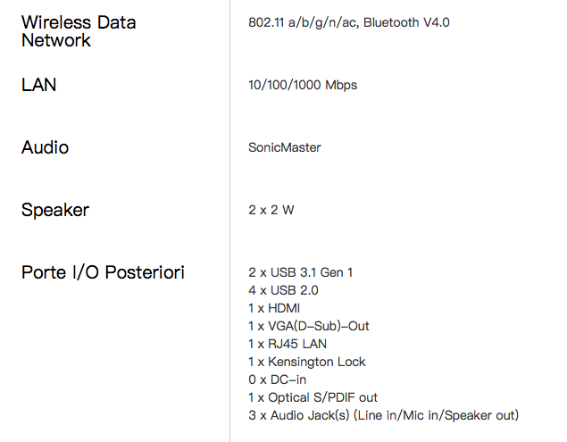

foskvs Posted November 12, 2017 Share Posted November 12, 2017 According to Asus website: From your ioreg: I think there's something wrong in the way you are injecting usb. Download Hack_Info, drag it to terminal and add -all argument. Attach the file generated on your desktop and your CLOVER folder. Hack_info.zip Link to comment Share on other sites More sharing options...
garti Posted November 12, 2017 Share Posted November 12, 2017 According to Asus website: Schermata 2017-11-12 alle 09.44.05.png From your ioreg: Schermata 2017-11-12 alle 09.50.04.png I think there's something wrong in the way you are injecting usb. Download Hack_Info, drag it to terminal and add -all argument. Attach the file generated on your desktop and your CLOVER folder. I PM the report Link to comment Share on other sites More sharing options...

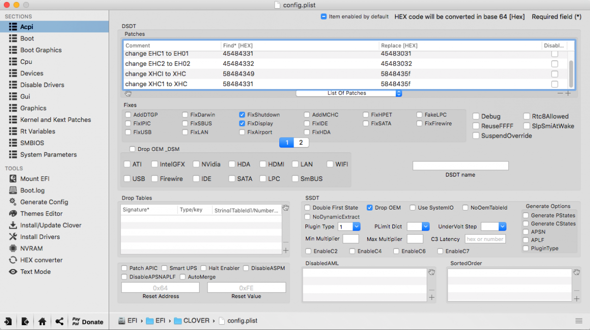

garti Posted November 20, 2017 Share Posted November 20, 2017 It doesn't deactivate usb3 ports. It moves usb2 ports from XHC to EHC1. I have no other ideas, but the problem is definitely related to usb ports. I've some updates with Half success. BT is detected and On. AirDrop Works. I can pair headset. However after pairing the headset, If I turn it off. I noticed that I cannot turn off or On the BT. XHCI to XHC and XHC1 to XHC is what made BT active. of Course with BrcmFirmwareData.kext and BrcmPatchRAM2.kext in . /EFI/CLOVER/kexts/10.13 All the other kexts and patches, I can deactivate them with no effect . . Link to comment Share on other sites More sharing options...
