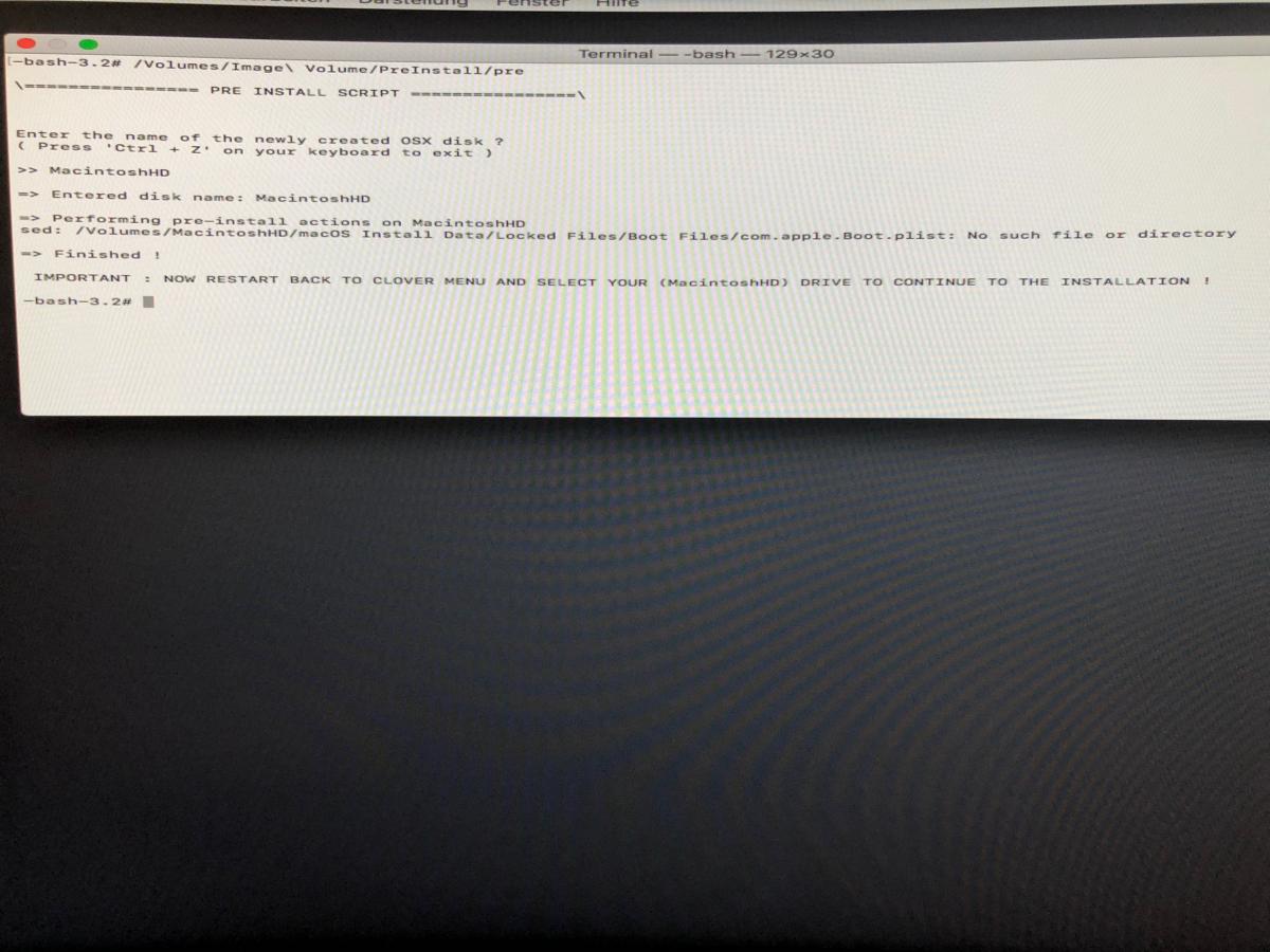

I have managed to find the hard drives over the diskutil, made a fusion drive of the ssd and hdd and started the installation. After about 1 minute it automatically restarts and I try to continue with the terminal command "Volumes/Image\ Volume/PreInstall/pre" but I get following error
Are you trying to setup on a fusion drive with 2 drives? Maybe installing on only one drive would be a better option for now?
For the above message, did you try reboot and using the macHD drive to continue the install?
Ok, then i am going to erase the fusion drive and try to install it on the ssd only.
I tried to reboot but in the glover menu I had no new drive so I was only able to boot again from usb...
I tried also the postinstall method, but there is no such file or directory :(
Hello,there.
What did you do that made you can see SATA drive in disk utility?
I have same hardware(mobo is ASUS ROG x399) sucked at installer
It could be helpful if you share what have you done
Thanks anyway. Found out that i wasn't the only one having this problem.
Managed to see my SATA drives by using Tool->Terminal->diskutil list
Thank you very much!
Turns out that when hard drive is brand new brought one(with no partition) same problem happends and sulotion by using diskutil always work!(Tried twice)

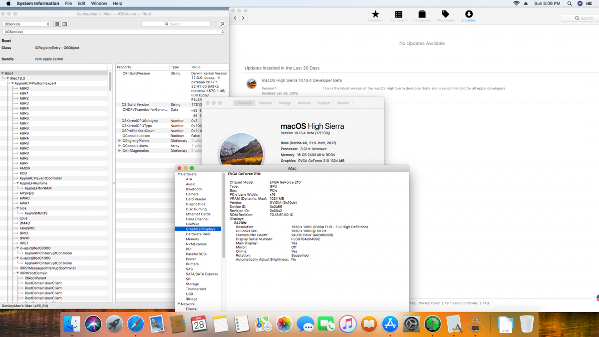

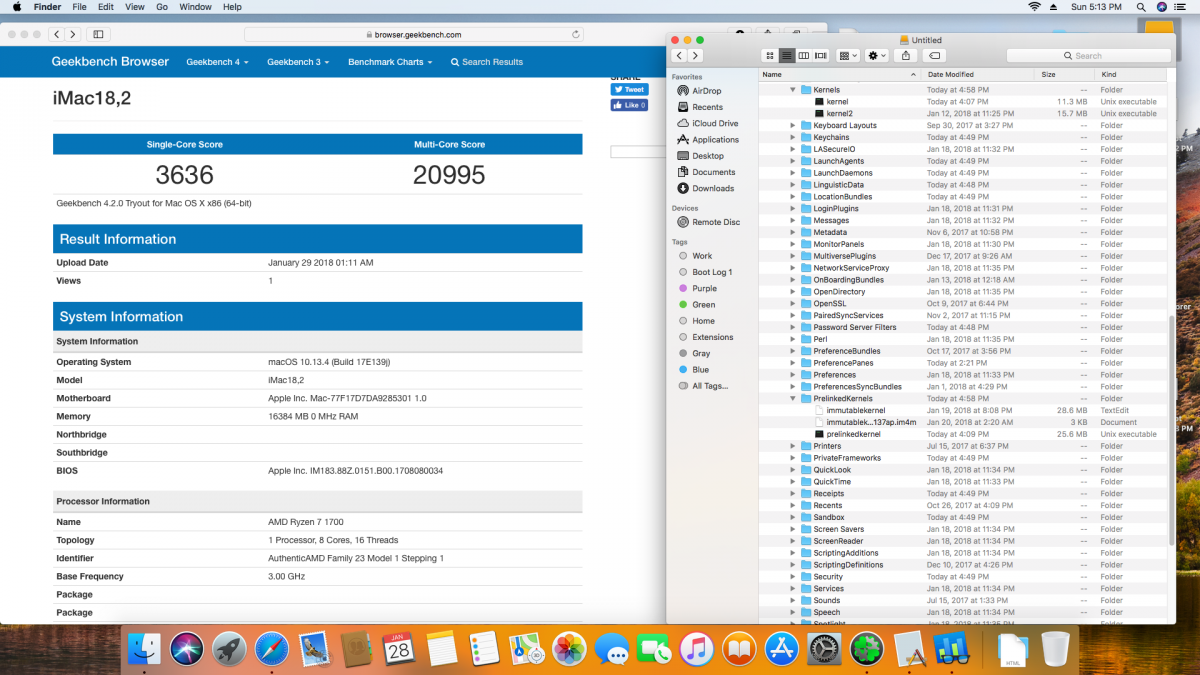

I have been able to load the latest High Sierra 13.4 developer beta version 1.   It has some new kernel and prelinkedkernel issues but I was able to repeat my install from a freshly loaded disk.    I started with the High Sierra public release 13.3 and replaced the kernel and relinked kernel and system kext.    Then I used the Dev. bets utility and downloaded the beta HS 13.4 version 1 from the App Store.    This method will require a working Intel Hackintosh along with your Ryzen system.
Get you Ryzen system running in High Sierra 13.3 and drag your kernel (Bronya kernel) to desktop for a copy.    Download Shanee's kernel updater app from the downloads section here.  http://www.insanelymac.com/forum/files/file/919-amd-kernel-updater/
Follow the directions to update your kernel using app and it will place the 13.3 updated kernel into your S/L/kernel folder.    Check kernel date for update status to see if it worked.    Now run Kext wizard or other kext utility too rebuild permissions and rebuild caches.    After its completed drag this kernel to desktop and replace the one there from previous the time.    Go to the prelionked kernel folder and drag a copy of it as well.    Put these in a new folder and load onto your working Intel Hackintosh for editing later.
Run your update for the beta from App Store and at reboot turn off your system and remove the drive.    Place the drive in your Intel system and use the Intel system to boot into the Install package.    It should reboot a few times during the install and when the "boot form Install" option tab is no longer there and only the original drive tab for your Ryzen system is there do not boot into it yet.   Boot into your intel system and do these edits.
Open the Ryzen drive on your desktop and go the kernel folder.    Select the new kernel and right click on it until it turns whit then add a 2 to the end and hit enter.    You should get the password prompt for the name change.   It should look like this kernel2.    Next drag the updated kernel form earlier to the kernel folder you should get Authenticate option and password.
Next go to your prelinkedkernel folder and open it.   Right click on the prelinkedkernel and trash it.    follow prompts.    Now drag your updated prelinkedkernel to the prelinkedkernel folder and follow prompts.
Before you test use kext wizard or other utility, I prefer kext wizard because you can specify the drive you want to repair, make sure to select your Ryzen drive for this function.   This works well when editing a disk that is not you boot disk.
Shut down Intel system and remove your Ryzen drive and install in your Ryzen system.    On first boot hit the space bar and select verbose, single user when it stops at root# type in "mount -uw" without "" marks.   At 2nd root$ type: 'fsck -fy", then at 3rd root# type "exit".  it should boot into High Sierra beta 13.4 beta 1 and you will be set.
Below are my Folders so you can see the layout you can try them but since they are tailored to my system they may not work for others.    But they might so give them a try but make sure you haver backup drives to test with or can afford a broken configuration.
