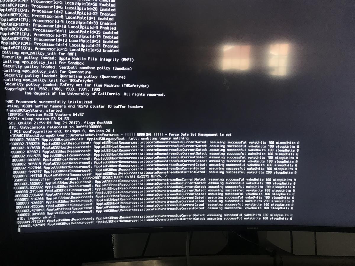

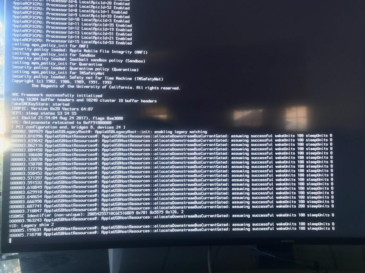

jasonsansone Posted October 4, 2017 Share Posted October 4, 2017 I was able to install High Sierra without any issues, but now that the OS is installed, the system won't boot. Attached is a photo of where the system hangs. I am currently at work so I will upload the clover.plist later tonight. I have tried everything I can think off. I've experimented with all combinations of various Clover boot flags and variables. I have tested various kexts. I tried the ICH10 patch for HS but it didn't change anything (I didn't have install problems without it). Im using Clover v4233 installed as Legacy. SMBIOS is MacPro5,1 as it best resembles this system's hardware (dual processor on Intel 5520 chipset with ECC ram). I thought that potentially the graphics card was causing problems, so I pulled the SSD out and installed the nVidia Web Drivers on a different, working hack build. I can boot into HS on that machine using the computer's normal clover setup. I get full graphics acceleration and everything else works fine when testing the SSD on the other hardware. The system is a Lenovo Thinkstation C20 with a low profile Gigabyte 1050 Ti OC. Some relevant specs: 2 x Intel Xeon E5620 2.4ghz Intel 5520 Intel ICH10R 48GB DDR3 ECC 128gb SSD formated to APFS Anyone have any ideas? No matter what I have done, I can not get past this hang booting 10.13. Edit 1: I have tested with multiple forks of FakeSMC. Tried Kozlek 6.26 and the HWSensors 3.5 Edit 2: Attached current config.plist config.plist.zip Link to comment Share on other sites More sharing options...
jasonsansone Posted October 9, 2017 Author Share Posted October 9, 2017 Update: I formatted my USB thumb drive and replaced with the new 10.13 build released with the Supplemental Updates (17A405). Update apfs.efi to the newest version. Booted from the USB, formatted the SSD, started all over. I was again able to successfully install High Sierra but can not boot into the OS. The results are the same. System hangs at same place as original photo. Link to comment Share on other sites More sharing options...

jasonsansone Posted November 20, 2017 Author Share Posted November 20, 2017 To patch under clover in [kernel and kext patches] Name: AppleAHCIPort Find: 4585f60f 95c289c8 83e0fe66 85c9780f 84d2750b Replace: 89c883e0 fe6685c9 0f98c141 08cc9090 9090750b Comment: whatever This information is the same as the following information from Posts #5 and #6. Thank you. That simply quotes and links to http://www.insanelymac.com/forum/topic/327488-macos-high-sierra-final-release-is-out-17a365/?p=2505086. I already tried the ICH10 patch. I haven't tried the newest releases of Clover and FakeSMC to see if anything has changed. I will update when I have time to test more. I have tested that method. It did not solve my problems. Link to comment Share on other sites More sharing options...
