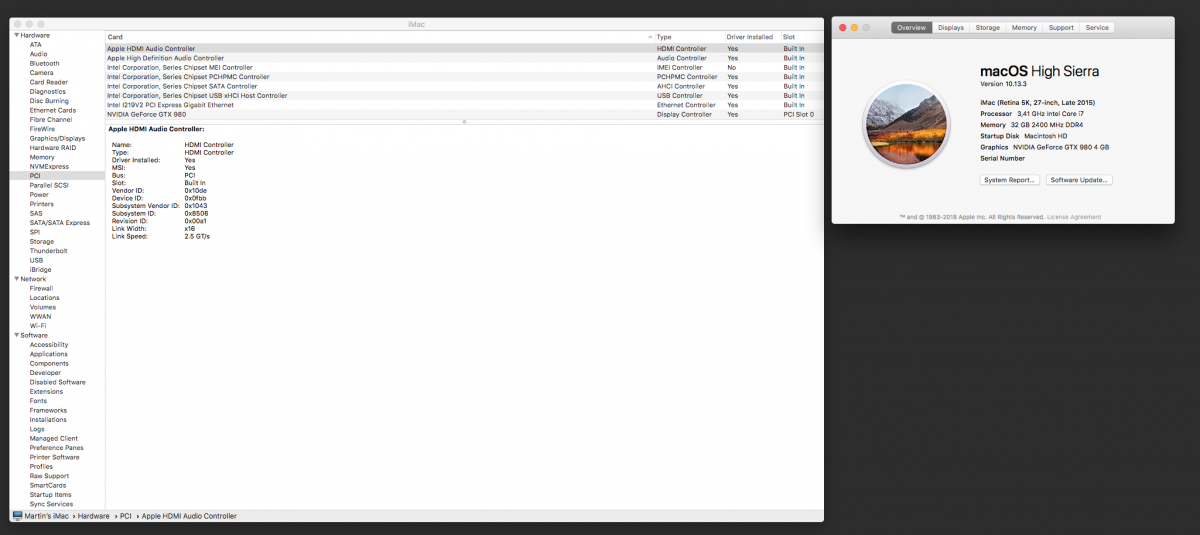

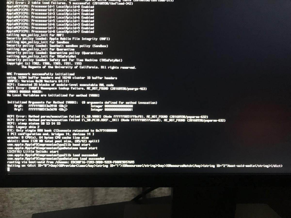

good day, i tried it, it boot once, it was great and showing me proper PCI list and everything worked! but after i reboot i cant boot anymore....its showing me this screen and waiting for root device error while booting, crossed circle, what boot args did you used? do you used also intel integrated, or nvidia graphics? what kext do you used? can you help me please?
ress O key in Clover boot screen, go to Acpi Patching/DSDT Name and put DSDT02.aml
boot into system, run it and send me files

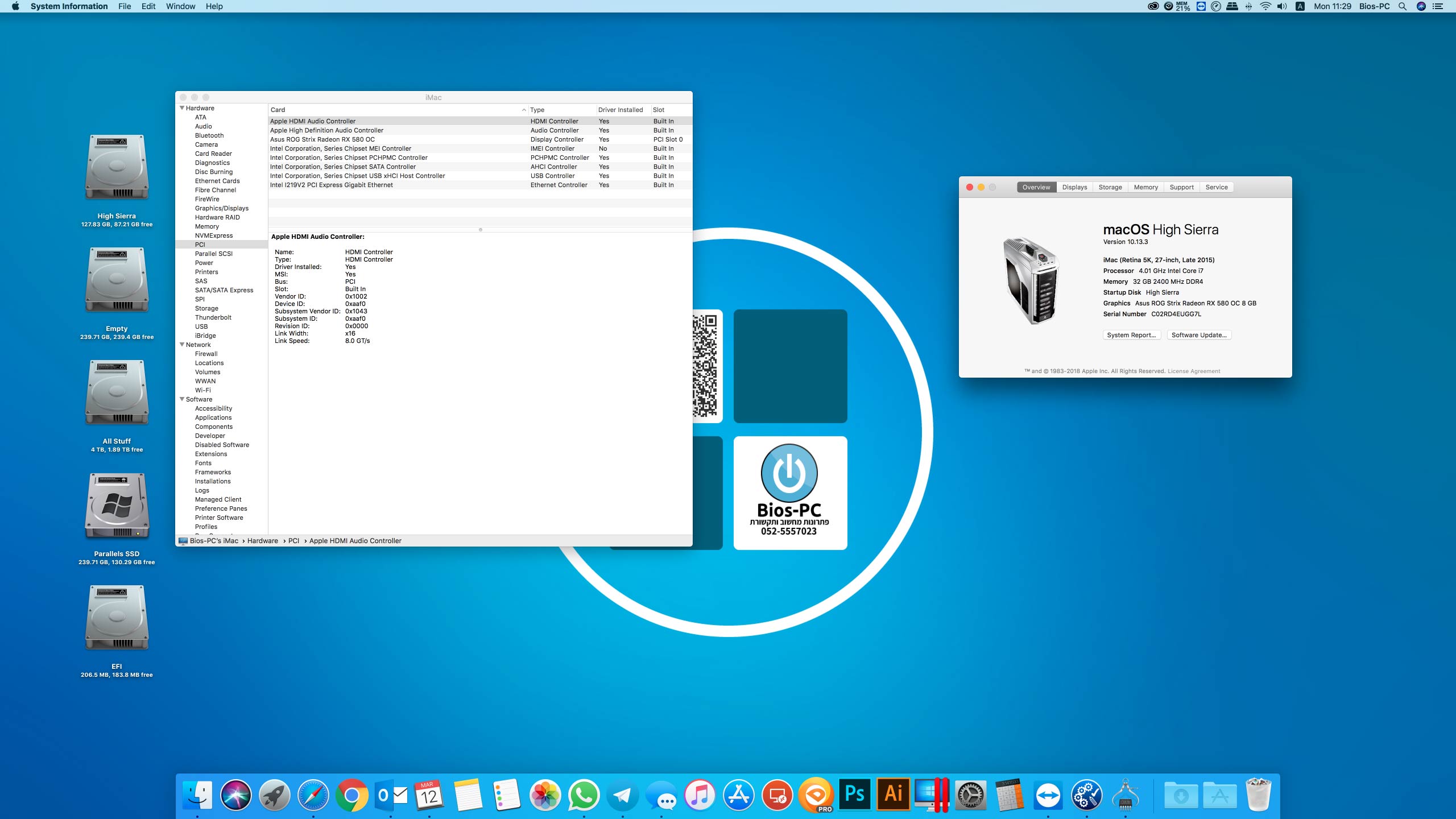

sooo somehow with luck i managed it working, i dont use all of your clover folders, which u send me, i just used your dsdt.aml with my boot plist and reconfigure it and it works!!!! somehow :D i can see my PCI devices and it looks everything is working, maybe i can send you my bootlog or something to check it, if everything is ok? but it looks like,
thank you very much Mald0n!!!
HA! one thing is not working :D SHUTDOWN, its keeping restart when i shutdown and shutdown fix in clover wont work :D here its used dsdt from you in attachement, any ideas how to fix this? :)

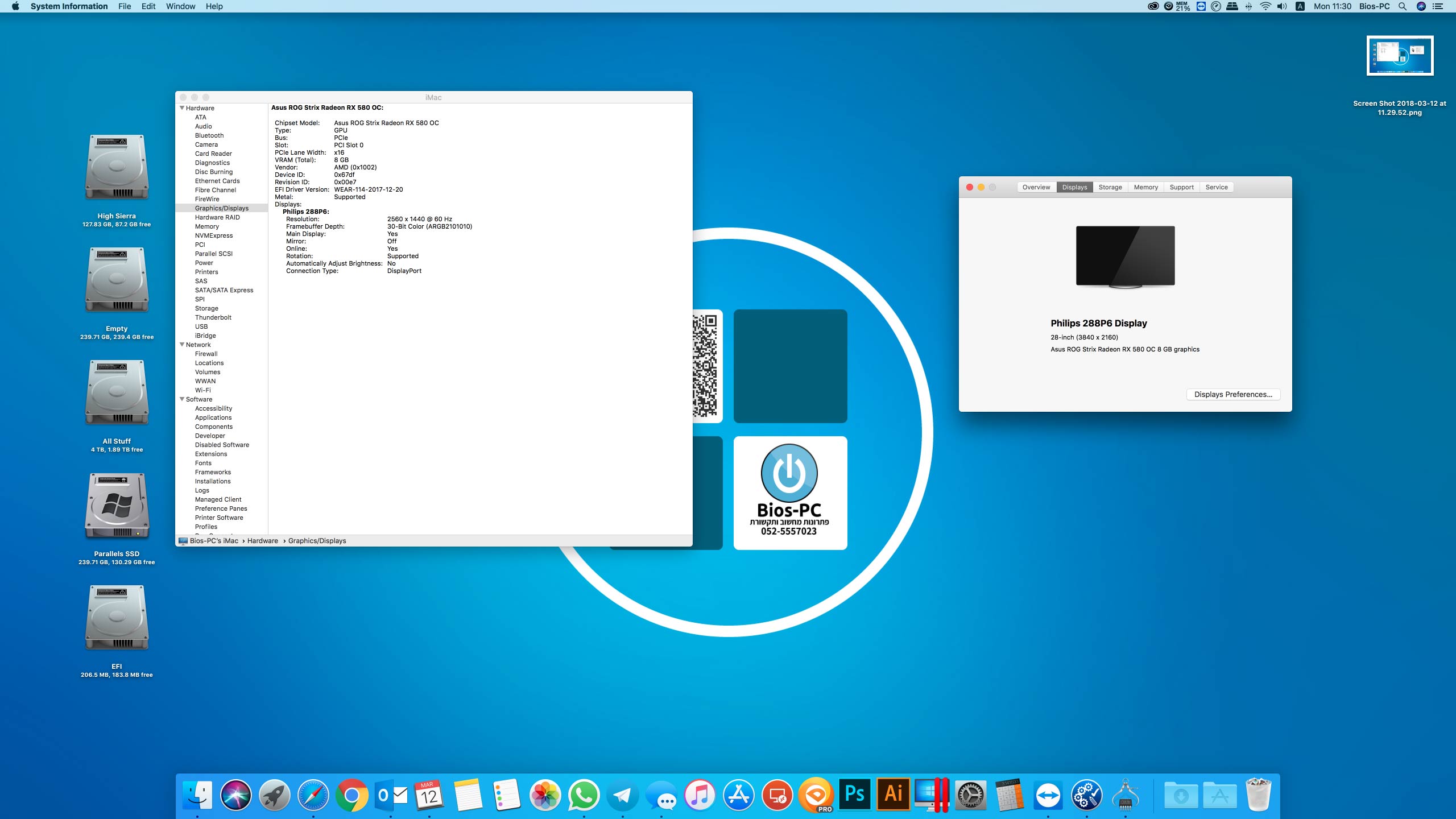

now I change my ASUS gtx970OC 4GB to ASUS STRIX AMD 8GB
because in high Sierra the gui was laggy
and I tried to fix this issue about half year with no luck
sorry but apple like AMD not NVIDIA
so now with the AMD Card everything work perfect no laggy UI
but I have some issue with VTEncoderXPCService that make my CPU 400% and raise the temperature to 55C instead of 30C
I think something with the high sierra
it happen just when I want to change desktop background or screen saver .

Hi ,
is there a way to not use whatever green by editing the dsdt for graphic?
also I want to have wireless always en0 in dsdt
can u help please?

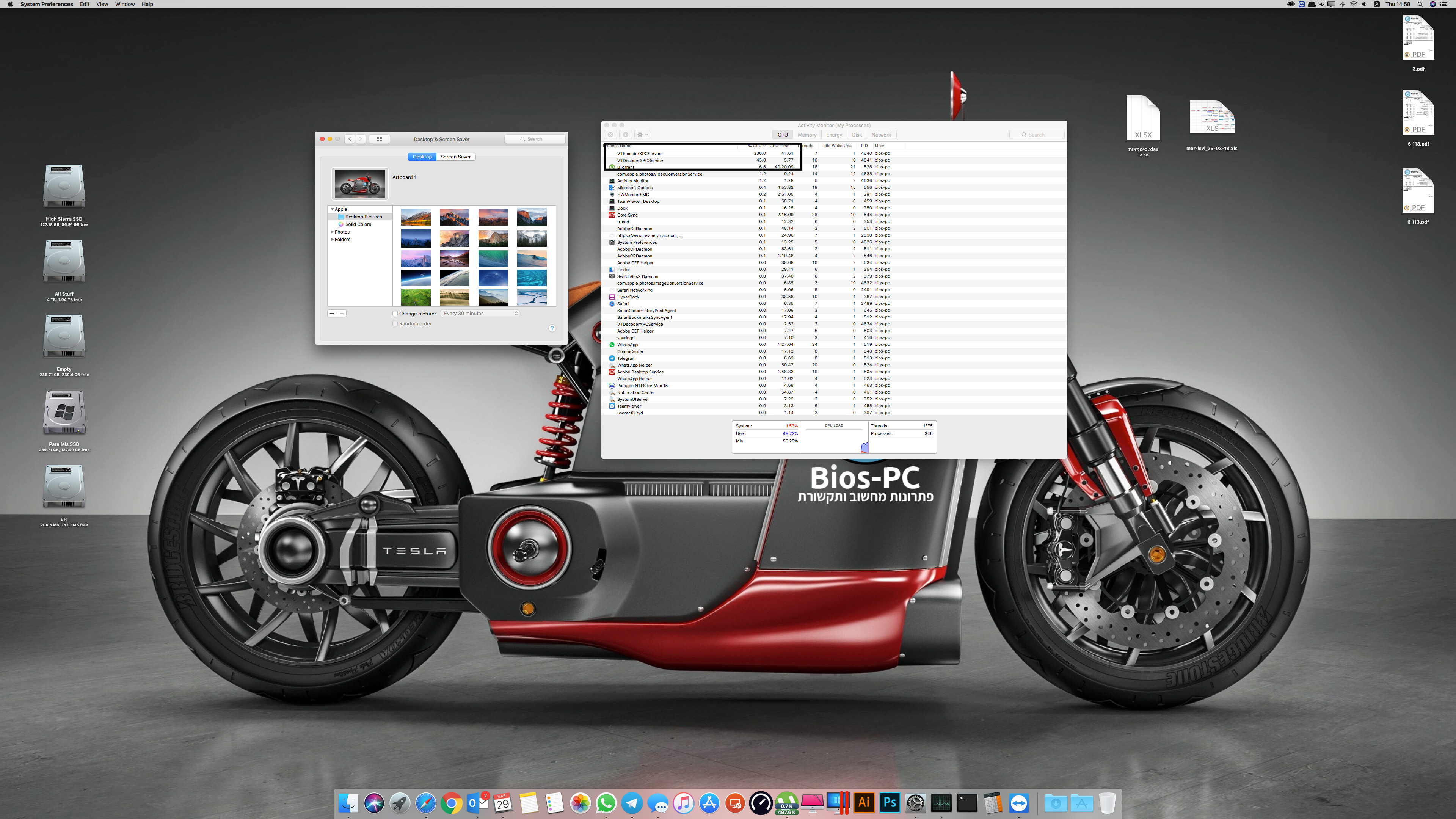

hi
I think that the frame buffer not really correct
when I open "change desktop wallpaper" my cpu go for 300% and high fan speed
I check every config that maybe could make the problem
after I make lot of fresh installation I found that the WhateverGreen.kext make the problem
look at the screenshot
also I wanted pic information about nvme and wireless card on pci section
best regards
and u r the best

Hello my friend
after a long time of work to figure what make the cpu and Mac freeze is the DSDT
ehn i remove DSDT now iMovie and fcxp pro work without any problem also photo app
I think something wrong with the dsdt
thanks for ur help
