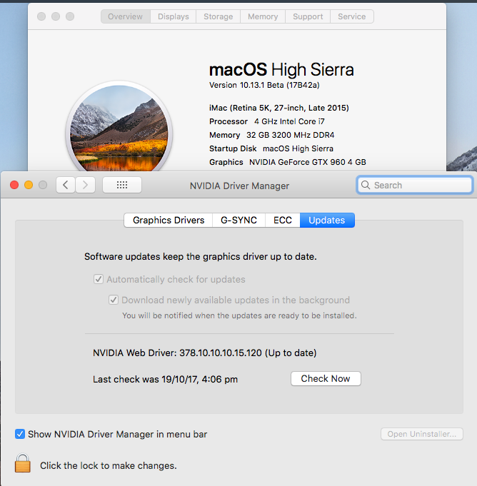

/Library/Extensions/NVDAStartupWeb.kext/Contents/info.plist
you have to modify
<key>NVDARequiredOS</key>
<string>17A405</string>
with
<string>17B35a</string>
and rebuild permission and cache in a way working for you
before to install you have to disable some version check
            #627
Im try and work nvidia web driver. And try active cuda not work you can have help me.

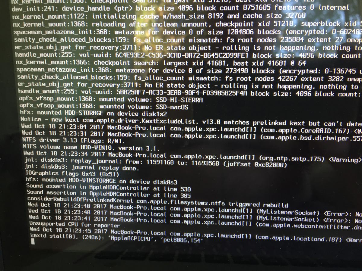

Is anyone having this issue (unsupported cpu for reporter/kextd stall) trying to boot into the beta 3 installer?  There seems to be some discussion about similar problems in the Clover general discussion thread so this may be a Clover problem.  It certainly seems like it will be a Clover solution once it gets sorted out.
Guest ricoc90
I also get the "unsupported CPU for reporter" message, but system boots fine

Here's my preboot.log:
attachicon.gifpreboot.log.zip
Where are your kexts? They're not being injected by Clover. Also, are we talking about Sierra or High Sierra?
18:590  0:001  Preparing kexts injection for arch=x86_64 from EFI\CLOVER\kexts\Other
18:590  0:000  Preparing kexts injection for arch=x86_64 from EFI\CLOVER\kexts\10.12
18:590  0:000  Custom boot screen not used because entry has unset use graphics
18:590  0:000  Closing log

How did you solved? I have HD4600 in desktop. Thanks in advance.  :wink_anim:  :wink_anim:
I have my custom kexts in Clover/Kexts/10.13. I'll try moving them to other.  I'm not sure why Clover isn't loading the kexts in 10.13.
So rico90, you really helped me!  I was able to install beta 3 by moving my Clover kexts to the Other folder.  I don't know why my 10.13 folder didn't load but the text you quoted above made it clear to me what the problem was.  Thanks.
