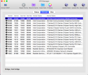

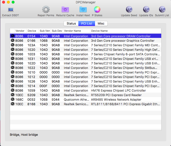

1. did u have tested the drivers that has MARZILLO uploaded?
2. to your question ==> start the tool and make a screenshot and upload it here
