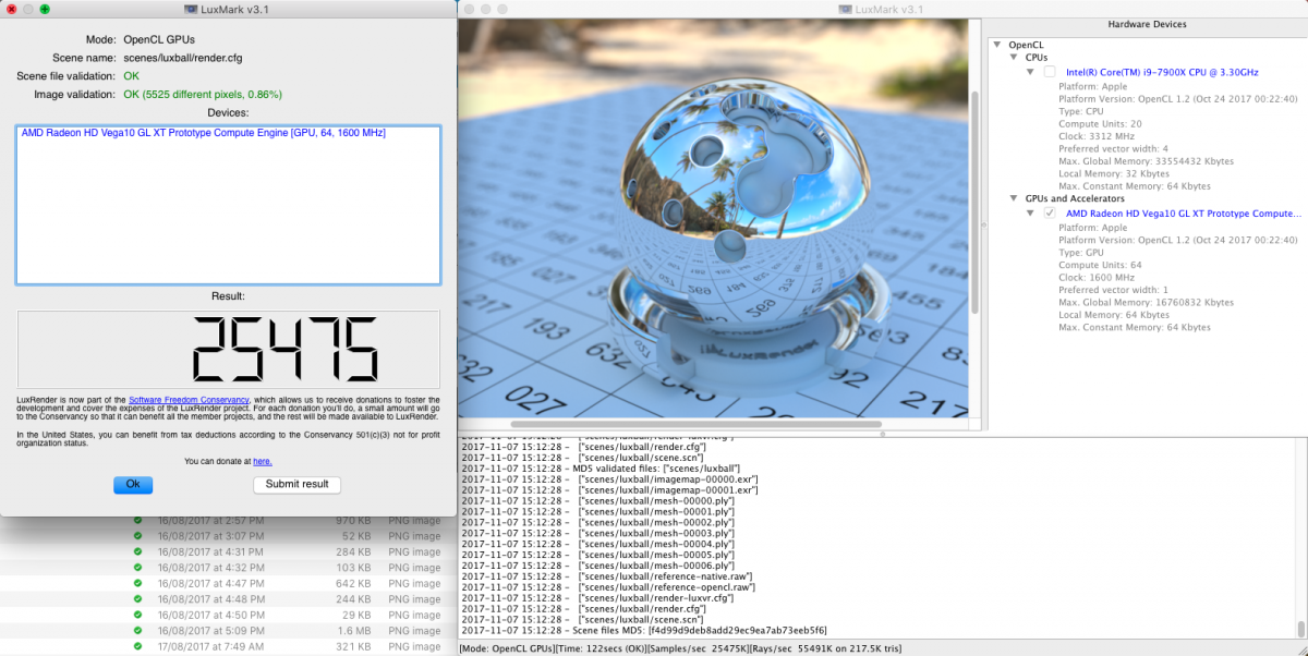

maleorderbride Posted November 13, 2017 Share Posted November 13, 2017 Yes me too, but on the Vega anyway, the 10.13.2 has fixed that. Also my benchmarks are 20 to 30% better. What do you get in Luxmark in 10.13.2 with a single frontier edition? What approach did you use to make sound work properly? I tried the kexts out of your EFI Folder, Toleda and Apple ALC but I'm missing something. VoodooHDA that you install like a package gives me horrible sound with a "fizz". Thanks in advance! You need Clover DSDT patches in addition to AppleALC--rename CAVS->HDEF & PC00->PCI0 (or do it manually in an SSDT or DSDT). You could find this out on your own by dumping your tables into Clover and looking at the DSDT, and then searching for the address always associated with audio and noticing it is no longer at ALZA (or, of course, HDEF). 1 Link to comment Share on other sites More sharing options...
surfinchina Posted November 13, 2017 Author Share Posted November 13, 2017 What do you get in Luxmark in 10.13.2 with a single frontier edition? Up from the 10.13.1 score of 20476 1 Link to comment Share on other sites More sharing options...
