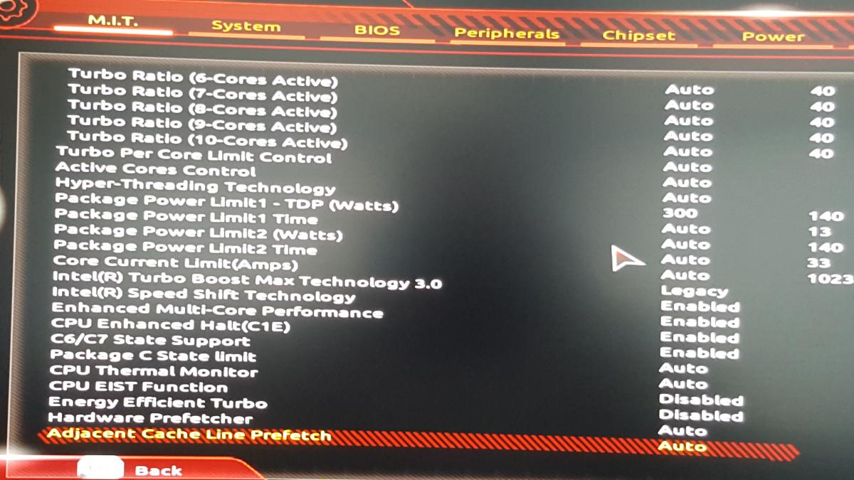

Philterino Posted August 25, 2017 Share Posted August 25, 2017 I guess the Nvidia thing could be part of the problem... but I think my Geekbench scores are WAY off for multicore. the lower ones on GB are around 30000... most seem to be around 38000... most seem to be like 6 or 7 times the single core speeds... so im just wondering is there something ive missed. Im using thePMDrvr.kext. etc. but i havnt done any custom SSDT as i cant get the app to work due to unsupported CPU. Not sure what to look at next. Link to comment Share on other sites More sharing options...

surfinchina Posted August 25, 2017 Author Share Posted August 25, 2017 Aren't Geekbench scores CPU and memory only so the GPU should make any difference? Regardless of what GPU should I not be able to get same score as Surfchina if I had the same cooling and settings etc.? Right, this one first I'm pretty sure it's your bios. I got similar scores when I changed some things in there to settings that a certain other person has posted on another site. Which is a lesson that we should never take anything seriously over there haha. In advanced frequency settings, advanced CPU core settings you will have this: Don't worry about the package TDP limit, that's just for overclocking so leave it on auto. note turbo boost is set to legacy. Apple doesn't support native yet. note energy efficient turbo off, EIST off, the rest is auto or enabled. You don't need any kexts or patches for xcpm, in fact they hurt, not help. PMDriver doesn't hurt but it gives me a 8 speedsteps instead of 6, so it's not that important. Here is a kext to enable audio attached: VoodooHDA.kext.zip 1 Link to comment Share on other sites More sharing options...
Philterino Posted August 25, 2017 Share Posted August 25, 2017 Right, this one first I'm pretty sure it's your bios. I got similar scores when I changed some things in there to settings that a certain other person has posted on another site. Which is a lesson that we should never take anything seriously over there haha. In advanced frequency settings, advanced CPU core settings you will have this: 20170826_083822.jpg Don't worry about the package TDP limit, that's just for overclocking so leave it on auto. note turbo boost is set to legacy. Apple doesn't support native yet. note energy efficient turbo off, EIST off, the rest is auto or enabled. You don't need any kexts or patches for xcpm, in fact they hurt, not help. PMDriver doesn't hurt but it gives me a 8 speedsteps instead of 6, so it's not that important. Here is a kext to enable audio attached: Awesome thanks... yeah I did use the bios settings from some person on some other site. I will give this a go. Link to comment Share on other sites More sharing options...

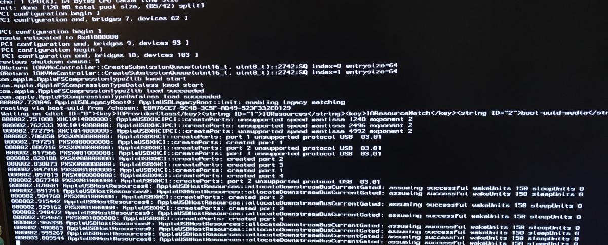

jonathanzhu Posted August 25, 2017 Share Posted August 25, 2017 Trying to do the same with a TUF X299 Mark 1, get stuck by a USB related problem. Link to comment Share on other sites More sharing options...
surfinchina Posted August 26, 2017 Author Share Posted August 26, 2017 Trying to do the same with a TUF X299 Mark 1, get stuck by a USB related problem. It's possibly not a USB related problem, that's just where it stopped. Anyway, in case it is, try some different USB kexts. I use the X99 0ne: X99_Injector USB 3.kext.zip Link to comment Share on other sites More sharing options...
Arkanis Posted August 26, 2017 Share Posted August 26, 2017 Generally after USB comes AHCI and mounting different partitions. Check you Bios, in which ports your HD is plugged, etc. Some motherboards won't come Ith AHCI enabled by default, others have multiple chipsets for SATA, pick the most compatible one. And of course avoid USB3 until machine starts booting completely. Regarding what Punk said about "Apple becoming smart", I don't think it is a dark and gloom premonition, it is a fact and it has happened in the past with dual CPU rigs (and it is still happening) where Apple made it harder for us to get these machines working on purpose... Also, I don't think we mon-existant to them, we aren't a threat that is for sure, but I'm pretty sure they have an eye on what is going on, performances, etc. Link to comment Share on other sites More sharing options...
jonathanzhu Posted August 26, 2017 Share Posted August 26, 2017 Generally after USB comes AHCI and mounting different partitions. Check you Bios, in which ports your HD is plugged, etc. Some motherboards won't come Ith AHCI enabled by default, others have multiple chipsets for SATA, pick the most compatible one. And of course avoid USB3 until machine starts booting completely. Regarding what Punk said about "Apple becoming smart", I don't think it is a dark and gloom premonition, it is a fact and it has happened in the past with dual CPU rigs (and it is still happening) where Apple made it harder for us to get these machines working on purpose... Also, I don't think we mon-existant to them, we aren't a threat that is for sure, but I'm pretty sure they have an eye on what is going on, performances, etc. Thanks! Cloud you tell me how to avoid USB3? btw, I also have USB 3.1 on Board. It's possibly not a USB related problem, that's just where it stopped. Anyway, in case it is, try some different USB kexts. I use the X99 0ne: Thanks! But I tried this one at the first time and it does not work.... Link to comment Share on other sites More sharing options...

Arkanis Posted August 26, 2017 Share Posted August 26, 2017 We are cool mate, I got you message the right way. @johnathan regarding USB avoid to use it in the first place, secondly try to turn it off. If it still hangs at the same place the problem doesn't come from your USB ports but something else, what is being loaded AFTER that. Check AHCI for starters. Link to comment Share on other sites More sharing options...
Philterino Posted August 28, 2017 Share Posted August 28, 2017 Still can't get this power management sorted, I've tried a bunch of stuff, was starting to think i had a duff chip but did a Windows install and was hitting 36000 in geekbench multicore with a stock bios profile. Only getting 21000 in sierra. Would the gigabyte UD 4 just not be workings same as the gaming 7\9 etc.? Link to comment Share on other sites More sharing options...
surfinchina Posted August 28, 2017 Author Share Posted August 28, 2017 Still can't get this power management sorted, I've tried a bunch of stuff, was starting to think i had a duff chip but did a Windows install and was hitting 36000 in geekbench multicore with a stock bios profile. Only getting 21000 in sierra. Would the gigabyte UD 4 just not be workings same as the gaming 7\9 etc.? So what kind of power management have you put in, in terms of patches or kexts? And boot args. Link to comment Share on other sites More sharing options...
Philterino Posted August 28, 2017 Share Posted August 28, 2017 i used the updated pmdrvr.kext first... Got 6 speedsteps and about 18-20k f2f 1600 in cinebench ssdtPRGen got me to 20-22k gb 1400-2000 in cinebench. Ive tried various frequency vectors still nothing getting me in to 30k In Windows i was running about 50-60 degrees in full turbo so I think cooling is ok. In cinebench the cpu freqs are all over the place.. Don't look stable at all. I'm totally new to this and could be missing something obvious but I've been reading tons of stuff and have tried to be pretty scientific with how I've been modifying settings to see where I'm getting gains and losses. Might try a high Sierra build although I only have nvidia gpus so not sure that would work yet. Link to comment Share on other sites More sharing options...
surfinchina Posted August 28, 2017 Author Share Posted August 28, 2017 i used the updated pmdrvr.kext first... Got 6 speedsteps and about 18-20k f2f 1600 in cinebench ssdtPRGen got me to 20-22k gb 1400-2000 in cinebench. Ive tried various frequency vectors still nothing getting me in to 30k In Windows i was running about 50-60 degrees in full turbo so I think cooling is ok. In cinebench the cpu freqs are all over the place.. Don't look stable at all. I'm totally new to this and could be missing something obvious but I've been reading tons of stuff and have tried to be pretty scientific with how I've been modifying settings to see where I'm getting gains and losses. Might try a high Sierra build although I only have nvidia gpus so not sure that would work yet. Have you got Intel power gadget? Run it and take a snapshot of it as you run cinebench. That'll let us know what frequencies you're getting. If you've made an SSDT and put it in patched you'll need to check plugin type = 1 in Acpi in Clover config. I check C2, C4, C6 in CPU but I don't know if that makes a difference. If you don't have luck with this we can take another look at your bios. Link to comment Share on other sites More sharing options...
Philterino Posted August 28, 2017 Share Posted August 28, 2017 Just in my phone here so don't have Intel gadget stuff here but I've sceengrabbed a bunch. I'll post tommorrow. I think there is one of mine in this thread. I have plugin type at 1... Hadn't checked c2, c6, etc.. Will try that tomorrow. Thanks for the help! Really appreciate the time you out in to this 1 Link to comment Share on other sites More sharing options...
