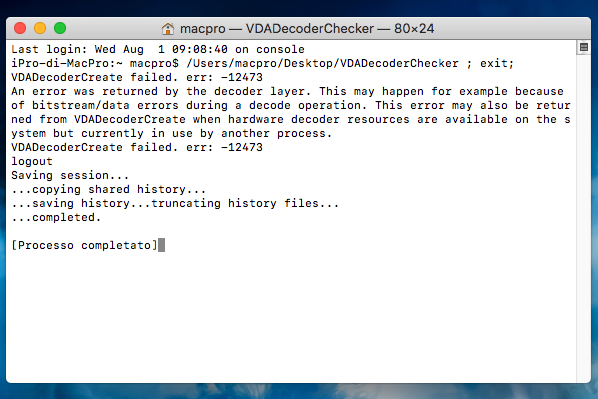

On 8/1/2018 at 9:20 AM, xelanaiznac said:
thank you Pavo. I found out that if I use vega64, my hardware acceleration is fully supported.
as soon as I put my Nvidia gtx 1080, I have the error as picture
this happens on my x99 and on my x299 config (tried in both systems).
no issue with my z370 with both amd or nvidia
hi guys, any idea? @vit9696 @Pavo

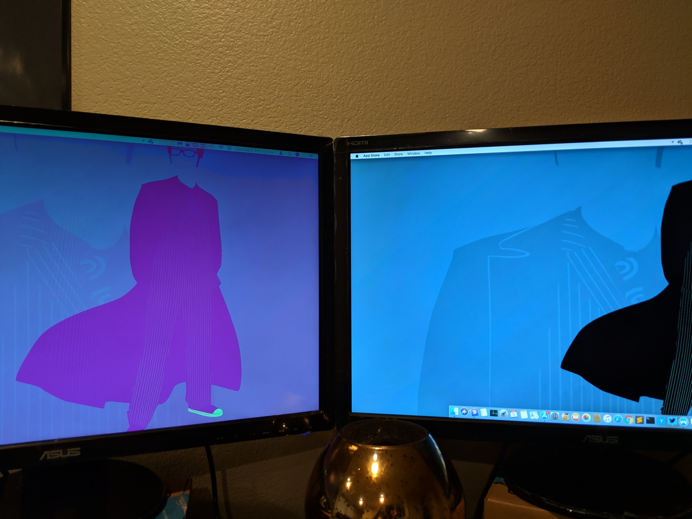

Hello,
I recently updated to 10.13.6, and with it I updated all my Kext to the last version, however, I'm getting a pink/magenta tint on my second display. I have been playing around both multiple configurations and I haven't been able to remove it.
So far:
  • Older versions of Kexts: Gave black screen
  • Newer WhateverGreen with latest Shiki, and Lilu: kernel panic, and reboot (even when setting the no reboot option on clover)
  • Newer versions, disable Whatevergreen: Pink/Magenta tint
  • Newer versions, disable IntelFixup, and Shiki: Pink/Magenta tint.
Mac seems to recognize correctly my Graphic Card: MSI RX 560 AERO ITX 4G OC
Any help would be great!

On 8/5/2018 at 11:30 PM, kennyeni said:
Hello,
So far:
As detailed in this official post  Coredisplayfixup, Shiki and IntelFixup are now all depreciated as those functions are now merged with Whatevergren.
If you read the latest realise notes for Whatevergreen it specifically states that use of those kexts in-conjunction with Whatevergreen will result in KP's and display issues.
Delete them and just use the latest builds of Lilu + Whatevergreen.
Cheers
Jay

Hi Support Team (WhatEverGreen or Shiki)
I can't play DRM-protected video on iTunes. iTunes shows black screen and stops position of playing marker at '0'.
Here is my spec:
NVIDIA Geforce 1060 GTX
Intel i5 8400 + UHD 630
I have turned on iGPU + Discrete GPU setting on BIOS and seems to work on playing video using iina with hw-decoder perfectly (Imgur)
I also checked VDA Decoder if working using VDADecoderChecker and, it shows 'Intel plugin detected. HW Decoder is fully working' (Imgur)
I try to make it work with the following: I installed the kext WhateverGreen.kext and set boot args with shikigva=12.
Force AppleGVA to use Intel or Nvidia decoder and reset DRM But none of them makes it to work.
It still doesn't work. How do I work on it? Thanks!
Edited by awert_65
