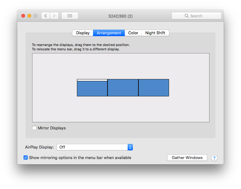

On my Z77X-up5 with i7-3770K, I tested with 4 monitors without any issues and I tested all 5 ports.
I have Saphire Nitro+ RX 580 8GB. It's 5 ports (2xDP, 2x HDMI, 1x DVI-D) are an almost perfect match for the Orinoco framebuffer and the generic AMDRadeonFrameBuffer.
Edited by MacNB
  • Thanks 1
42 minutes ago, Allan said:
Hello guys, one doubt.
It's possible now use 3 monitors with WhatEverGreen? I wanna buy a RX 580 in the future.
Thanks :)
Yes I also have an Asus ROG Strix TOP RX580 8GB and it works perfectly fine I tested it with two DP ports and 1 HDMI and all the displays were working ok.
Edited by Cyberdevs
  • Thanks 1
You're amazing guys! Thank you so much!!!
:thumbsup_anim: :thumbsup_anim:
