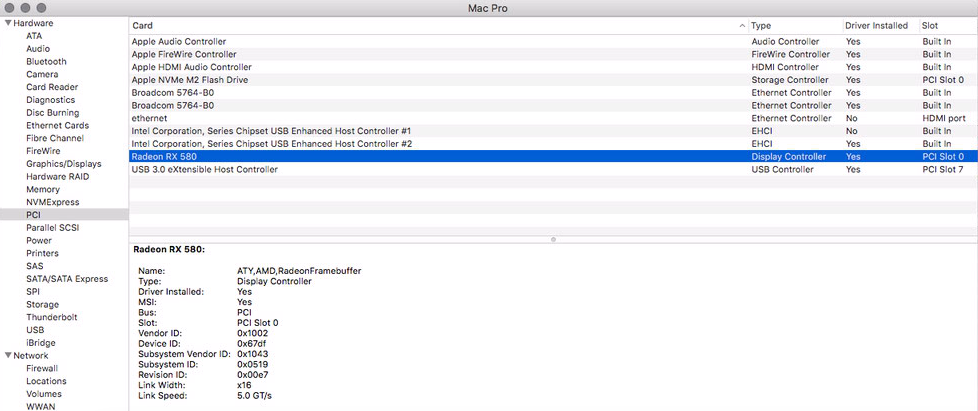

It looks a lot better now, attaching screenshot.
Graphics card looks like it's in the first slot (Slot0) when it's in the second (Slot1).
The screen is still black but it seemed to me it blinked more (twice, quickly?) before going black.
Do you want me to upload some logs or something?
In that case, please be quite specific about what and how to produce them.
Wow, thanks a LOT for helping.
