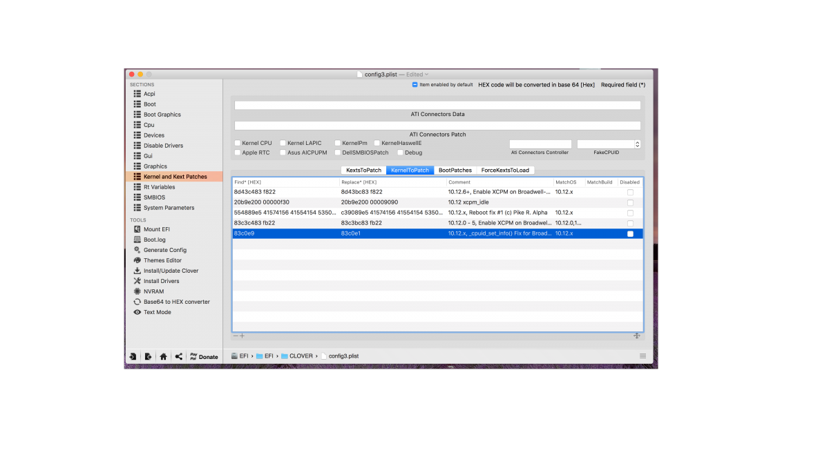

I have applied xcpm_bootstrap 10.12.6 but cpu frequency after update is stucked at high value ( in my case 3.2ghz...i've xeon unsupported cpu)
Here is my config.plist screenshot

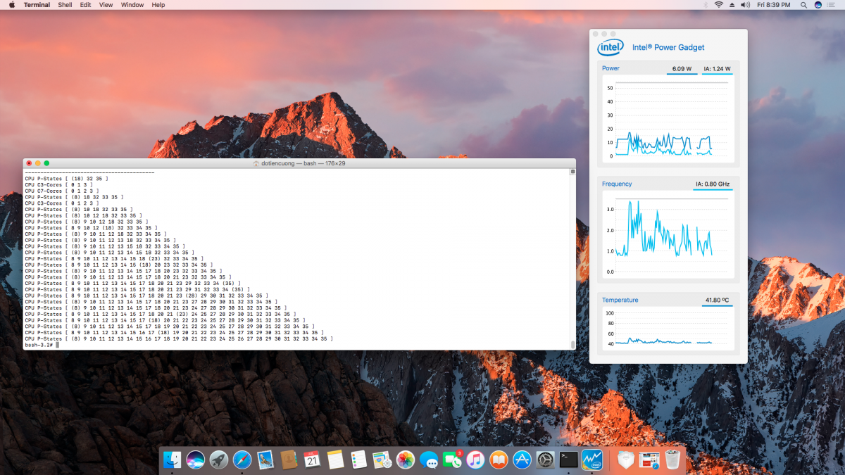

You need to update your frequency vectors to get the full array of P-States available for your CPU.  Use Pike R. Alpha's freqVectorsEdit script.  To see if you have frequency vector support, you can run this code in Terminal:
sysctl -n machdep.xcpm.vectors_loaded_count
If it returns the number 1, you have frequency vector support but if it returns the number 0, you do not.
I find the mistake....i've multiple config.plist so clover read always the old one even if i selected the new. Now it works
Try the following kernel patch for a x99  10.12.6 system
old:         find:             83c3c483 fb22
               replace:       83c3c183 fb22
                                   xcpm_bootstrap © Pike R. Alpha
new:       find:             8d43c483 f822
               replace:       8d43c183 f822
                                   xcpm bootstrap  derived from Pike R. Alpha's Ivy Bridge patch
This fixed my Haswell-E   xpm  issue !

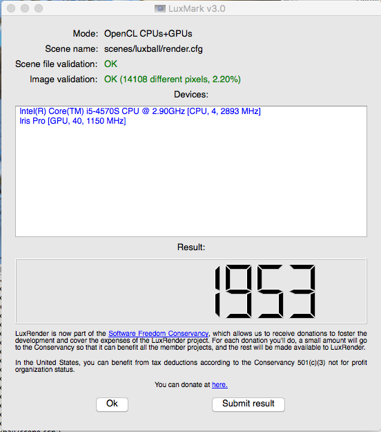

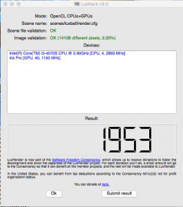

It is very good
I have a no extreme version patched @ extreme via nvflash.
Perfect.
As always Webdriver for OS X are not optimized very well for OpenCL but this gfx is a beast! :-)
It is a beast indeed :)

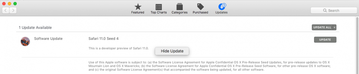

Off-topic: I have this weird issue on both Sierra and High Sierra that the software updater keeps spamming the Thunderbolt 1.2 update. Any idea how I can get rid of it?
See image: http://i.imgur.com/Ls3G4iw.png
Off-Topic:
I have found another easy way to hide the unwanted updates.
Open AppStore, Click updates and right click just right on comments of the update that you want to hide and select "Hide Update"
