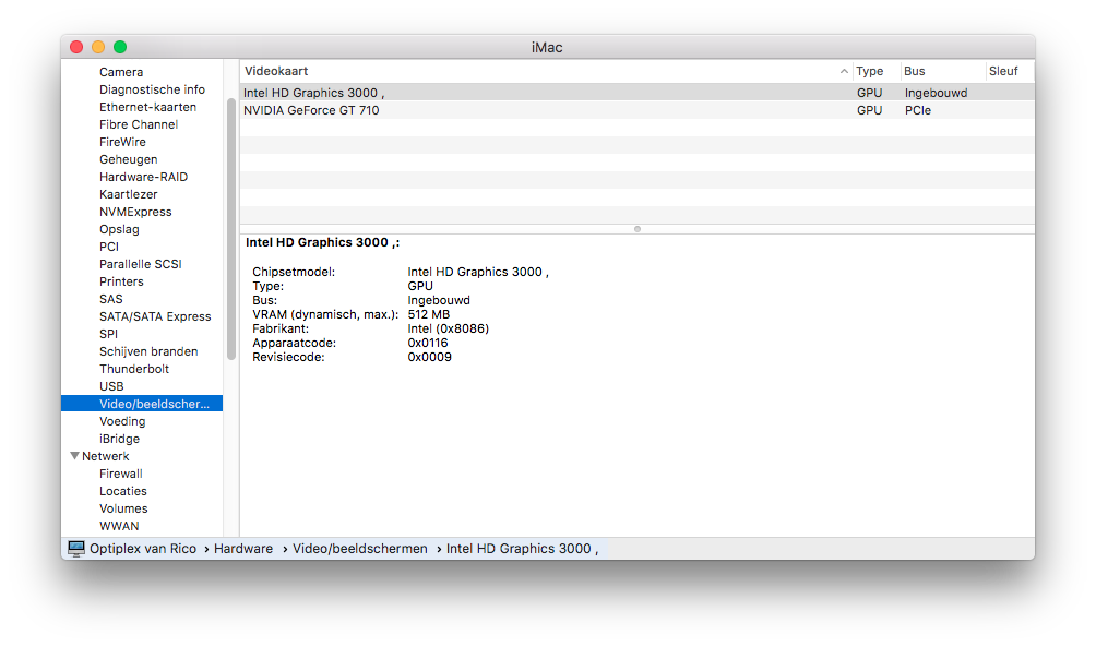

Could someone tell me what is wrong with this? The model only shows when I set the buffer to 0x18 but of course that is too long, so macOS is filling that space with an "," at the end. But if I put 0x16 (or even 0x17), the model gets ignored by macOS (thus it shows Intel HD-video 3000)
                    If (LEqual (Arg2, Zero))
                        Return (Buffer (One)
                            0x03
                    Return (Package (0x06)
                        "device-id",
                        Buffer (0x04)
                            0x26, 0x01, 0x00, 0x00
                        "AAPL,snb-platform-id",
                        Buffer (0x04)
                            0x10, 0x00, 0x03, 0x00
                        "model",
                        Buffer (0x18)
                            "Intel HD Graphics 3000"
Image%202017-07-16%20at%2012.08.17%20AM.
One can progress here, except that the second screen goes to standby and does not want to recover?
Maybe because of my DSDT, I have two patches now, one for the HD 3000 and another for the radeon HD 5450?
Also I do not manage to boot on the Radeon HD; It boot exclusively on the Intel HD 3000  :thumbsdown_anim:    :wallbash:
when I apply the DSDT patch and modify config.plist . An idea would be welcome

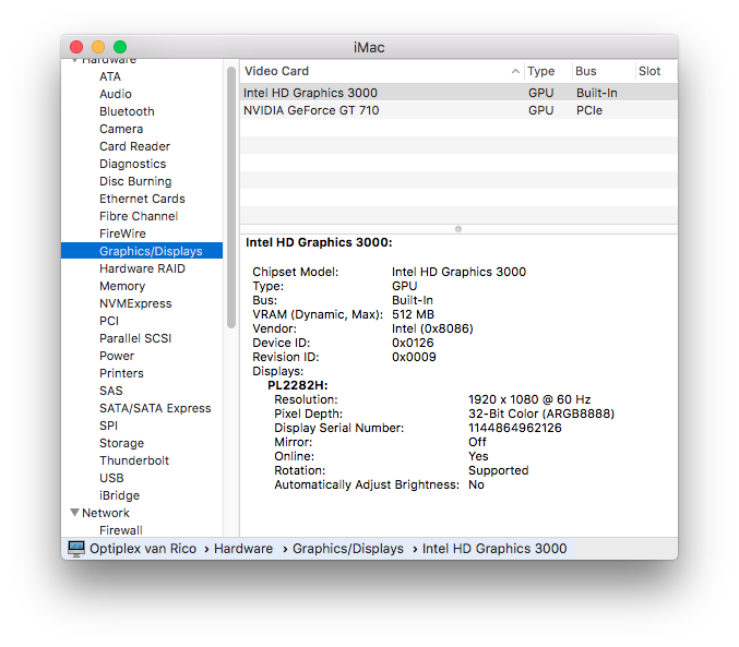

You can actually remove the value within bracket for the buffer ans simply enter "Buffer ()". The correct value is however 17bytes (number of characters +1). Or you could remove the "model" injection altogether and then set the "Package" length to 04 (or leave it empty like for a buffer).
The asl compiler automatically adjusts unspecified buffer lengths at compilation.
Yep, tried both already but then the igpu is still shown as "Intel HD-video 3000" rather than "Intel HD 3000":
IOReg is showing the correct modelname:
Image%202017-07-16%20at%2010.22.37%20AM.
I feel like I'm missing something, from which I'll say "ahhhhhh, of course!" as soon as I find out what...
The only way to make the card being shown as Intel HD 3000, is by specifying it in the DSDT with a buffer that is 0x18 or longer, otherwise it's ignored
Guest ricoc90
And if you turn your OS to English as opposed to Dutch?
Lol... then the card is shown correctly:
Is there a way to change the Dutch language file?

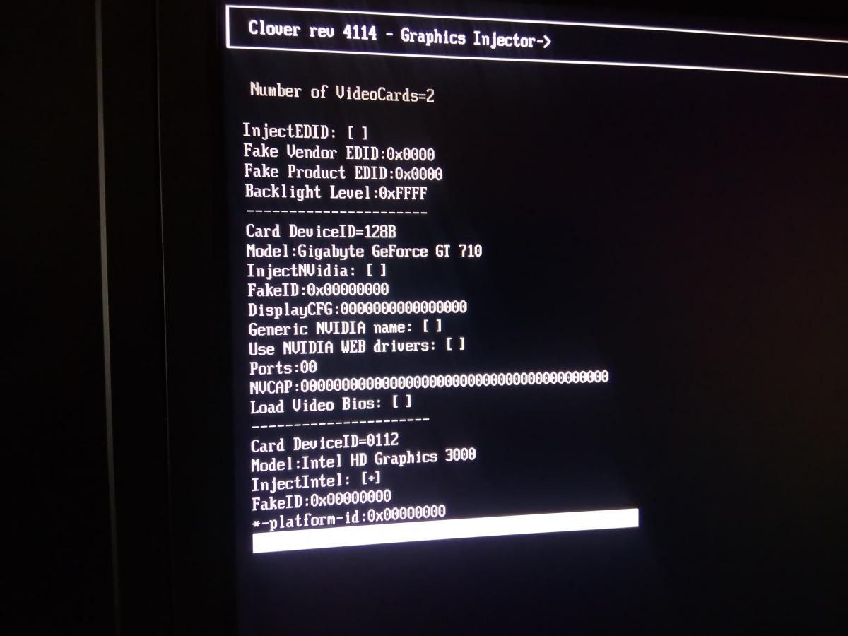

@ricoc90
Remove fakeid and platformid in config.plist
And please test. I will update clover after check report from you.
I want files(clover full log and ioreg)
나의 LG-F800S 의 Tapatalk에서 보냄
@Sherlocks its work with your Clover file
No patch DSDT no injection config.plist
attaching boot log and ioreg

@ricoc90

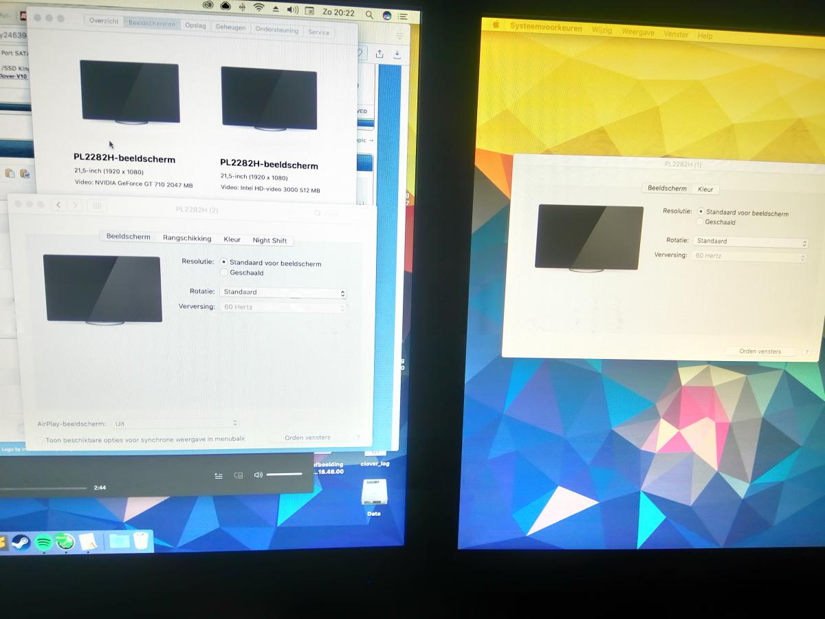

Works fine on DP. VGA needs binary patch so not tested
Ioreg and boot log attached  :thumbsup_anim:
So your GT 710 is magical because I try 3 différant Graphics card and when the Display port is Connect its boot only in the HD 3000
So I buying today a GT 710 and let you know about this  :angel:
Just removed the HD 3000 patch from DSDT, set injectintel to true in config.plist without specifying fakeid and platformid, also works fine.
I did however rename GFX0 to IGPU and PEG0 to GFX0, but it worked fine with the default names too
Its not an issue to View the card HD 3000 and the PCIe
Its  not Booting on the PCIe When the Display port is plug on Intel HD 3000
I have the same image as you have post, Both Display Both Graphics in Clover Setup

Tomorrow I will try to use a third screen on GT 710 HDMI and a fourth screen on the HD 3000 VGA
Are you sure you can used the second screen, because I have to do this but the screen its not usable in the second screen
its only a Picture like you, the Dock is not coming in the second screen?
I see your Uper bar its Scramble distostioning like me :(
