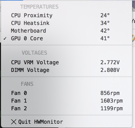

I use Slice's port of HWSensors3.  You need to figure out which super IO chip you have. Mine is IT8721F.
HWInfo: HWInfo get information from Clover bootloader, ©Slice 2013
AppleKeyStore::probe(IOResources)
Couldn't alloc class "FakeSMCKeyStore"
ITEIT87x: found ITE IT8721F
ITEIT87x: [Warning] no OEMVendor
ITEIT87x: [Warning] set default configuration
./smcutil -f
./smcutil -f

I read down thru the Slice HWSensor3 thread and did not understand much of it.  Do you have CPU temps working on your High Sierra Ryzen system?  If yes, can you provide some guidance to install?
Thank you,
neil

    Safe speed   : 0
    Target speed : 32
    Mode         : auto
    Temp         = 0
    Temp TB0T        = 0
    Temp TC0D        = 0
    Temp TC0P        = 23
    Temp TM0P        = 0
    Temp TN0P        = 40
    Temp Th0H        = 34
    Temp Ts0P        = 0
    Temp TN1P        = 0
    Temp Th1H        = 0
    Temp TG0D        = 48
Super IO ?  Is this the serial port "super IO" in bios?
Thank you,
neil
This is AMD FX.  They are all the same.  Once you figure out the sensor chip. See the installation picture in the middle https://sourceforge.net/projects/hwsensors3.hwsensors.p/.  ACPI is checked.  If it does not work, you need to pick the correct LPC chip type. All sensors connect to it via i2c bus.  When you install HWSensor3, you need to pick AMD CPU and the sensor chip.  The the app shows you the info.  What is your mother board?
This one https://www.gigabyte.com/Motherboard/GA-AB350N-Gaming-WIFI-rev-10#sp ?
See the I/O controller, iTE,  we have the same chip.  Pick ite for the LPC chip and AMD CPU/GPU.  That should work.
OK so there is no USB to connect?   My pcie adapter needs a usb connection for bluetooth.
It could be the same chip.
Edited by ydeng
