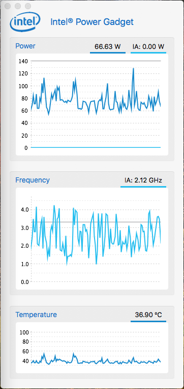

THe temps aren't too bad, but I have a 420 plus a 360 rad. The 7900x is a power hog! Just in windows it sits around 23deg.
HWmon doesn't work in X299 yet, for me anyway haha.
 I understand with your powerful config  :angel:

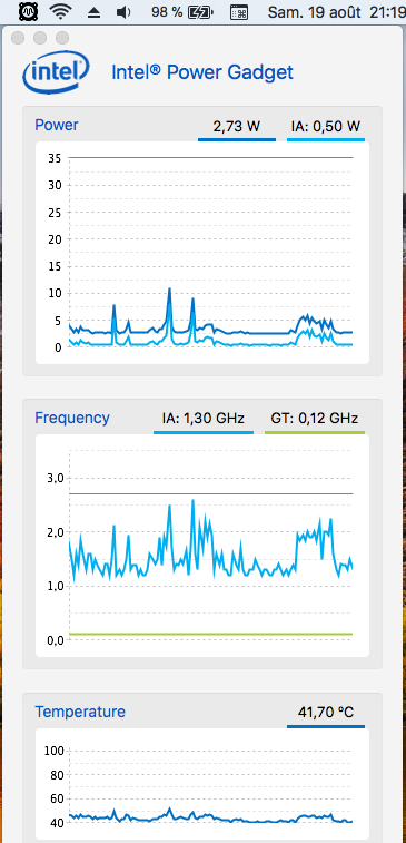

My low power config  :hysterical:  :P

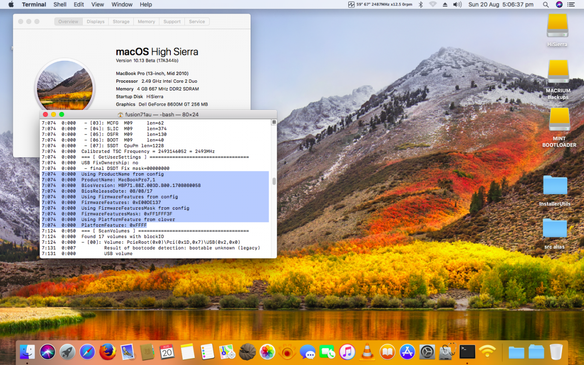

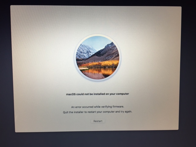

Hi @Sherlocks,
Thanks for correcting the default FF & FFM used for iMac11,3 in Clover r4178 - now no longer need to set manual values for that SMBIOS :).
However same problem occurs for SMBIOS MBP7,1 on my Dell XPS M1530 notebook - specs of machine in my sig.  The default FF (0xE907F537) & FFM (0xFFFFFFFF) used by Clover for DB6 ---> error occurred while verifying firmware.
7:046  0:000  Using ProductName from config
7:046  0:000  ProductName: MacBookPro7,1
7:046  0:000  BiosVersion: MBP71.88Z.003D.B00.1708080058
7:046  0:000  BiosReleaseDate: 08/08/17
7:046  0:000  Using FirmwareFeatures from clover
7:046  0:000  FirmwareFeatures: 0xE907F537
7:046  0:000  Using FirmwareFeaturesMask from clover
7:046  0:000  FirmwareFeaturesMask: 0xFFFFFFFF
7:046  0:000  Using PlatformFeature from clover
7:046  0:000  PlatformFeature: 0xFFFF
  • Clover legacy r4178, upgrade to DB6 by directly running the "Install macOS High Sierra Beta.app"
  • SMBIOS MBP7,1, no FF/FFM/PF or Board-ID/BIOS ver/date set in config.plist
After adding FF=0xE00DE137 and FFM=0xFF1FFF3F to my config.plist (same as MBP10,1 in post#2600), install proceeded without firmware verification error.
7:078  0:000  Using ProductName from config
7:078  0:000  ProductName: MacBookPro7,1
7:078  0:000  BiosVersion: MBP71.88Z.003D.B00.1708080058
7:078  0:000  BiosReleaseDate: 08/08/17
7:078  0:000  Using FirmwareFeatures from config
7:078  0:000  FirmwareFeatures: 0xE00DE137
7:078  0:000  Using FirmwareFeaturesMask from config
7:078  0:000  FirmwareFeaturesMask: 0xFF1FFF3F
7:078  0:000  Using PlatformFeature from clover
7:078  0:000  PlatformFeature: 0xFFFF

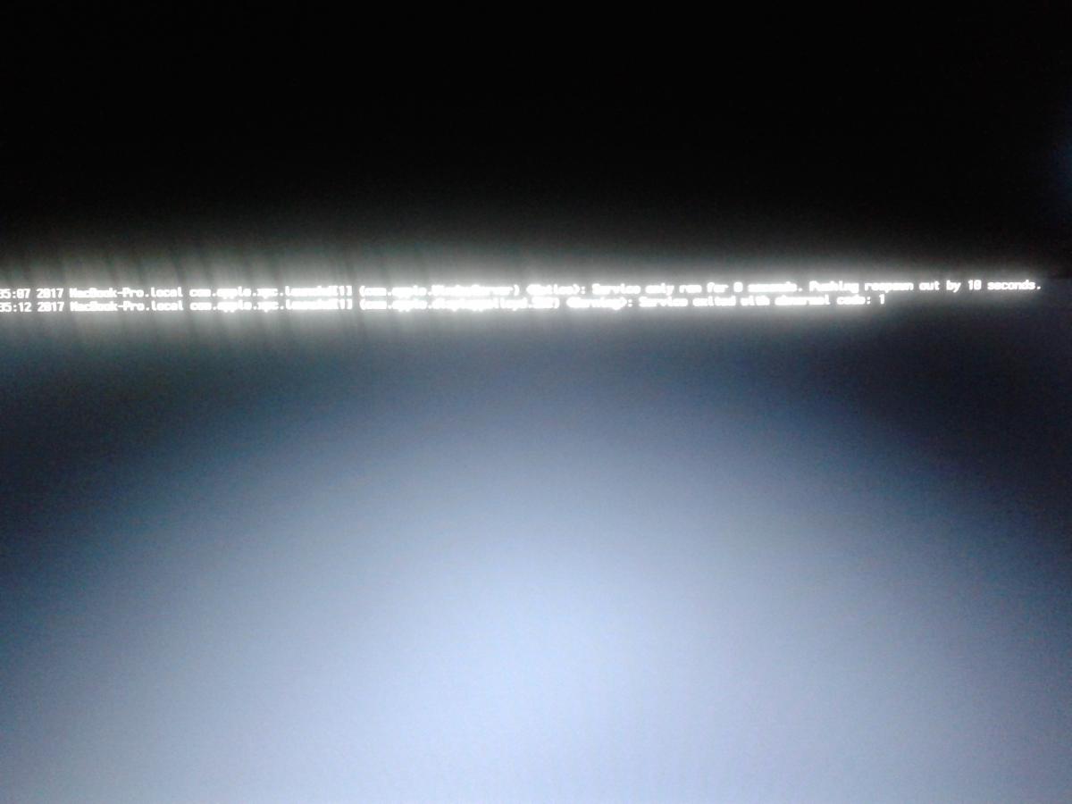

dp6 install usb
many method
alway same error,someone as a solution
