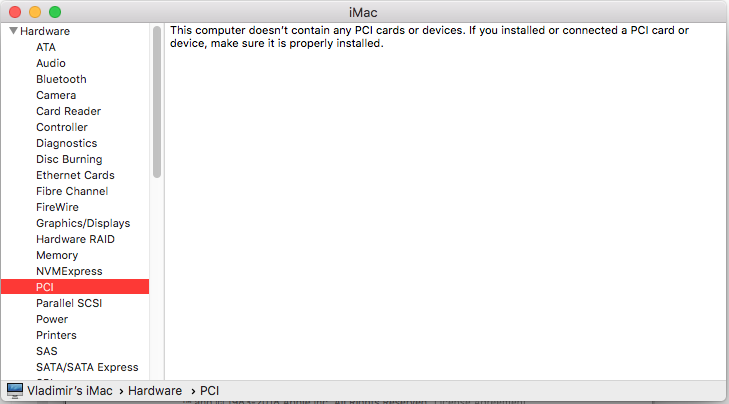

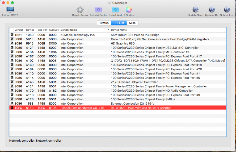

vik-vo Posted August 25, 2018 Share Posted August 25, 2018 (edited) Tell me how to start the PCI Wi-Fi adapter TP-LINK TL-WN881ND? how to make it work and what is needed for this? Edited August 25, 2018 by vik-vo Link to comment Share on other sites More sharing options...
MaLd0n Posted August 25, 2018 Author Share Posted August 25, 2018 6 hours ago, vik-vo said: Tell me how to start the PCI Wi-Fi adapter TP-LINK TL-WN881ND? how to make it work and what is needed for this? if don't work native, u need check if have a thirty party driver Link to comment Share on other sites More sharing options...
