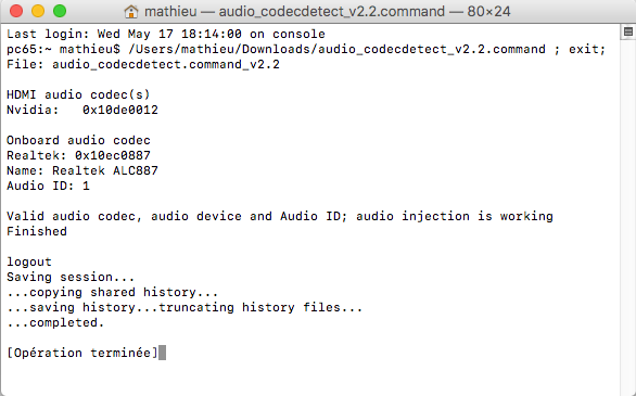

Cyberdevs Posted May 17, 2017 Share Posted May 17, 2017 based on this information run this one and answer the questions carefully with the info you have https://github.com/toleda/audio_ALCInjection/blob/master/audio_codecdetect.command.zip Link to comment Share on other sites More sharing options...
maxime25 Posted May 17, 2017 Author Share Posted May 17, 2017 I have nothing where answer Link to comment Share on other sites More sharing options...
Cyberdevs Posted May 17, 2017 Share Posted May 17, 2017 https://github.com/toleda/audio_CloverALC/blob/master/audio_cloverALC-120.command.zip Link to comment Share on other sites More sharing options...
maxime25 Posted May 17, 2017 Author Share Posted May 17, 2017 Thanks a lot everything works !! 1 Link to comment Share on other sites More sharing options...

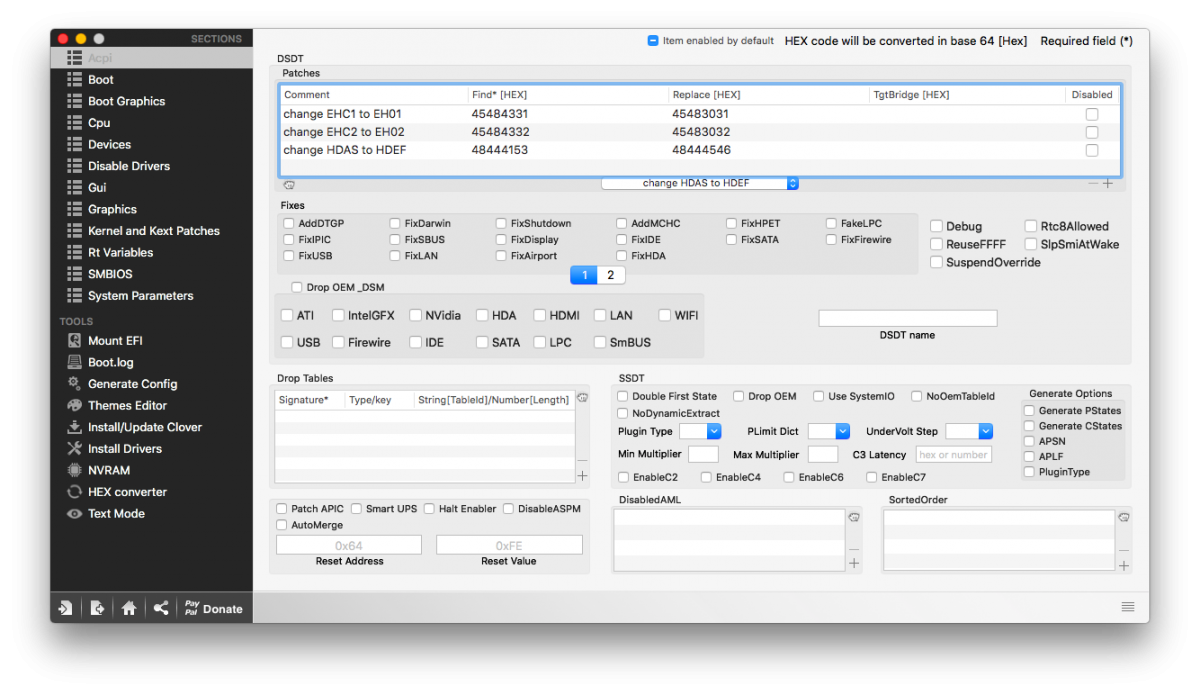

Cyberdevs Posted February 4, 2018 Share Posted February 4, 2018 question for you: it looks like i could use the Clover bootloader for multiple drives with different OSes, so i am wondering how easy it is to update the older Clover on the working bootloader? the Yosemite bootloader is actually on a separate USB stick. i had intended on copying it to the HD but never did it. anyway, help appreciated - thanks! not trying to confuse you too much. just trying to be thorough. i also realize that just because the current bootloader works on Yosemite that's no guarantee it will work on Sierra without any modification. Thanks for updating the signature. My first advice: Always use a USB disk for the purpose of testing new clover and EFI folder or config.plist. Have a back up of you existing and working EFI folder and keep it handy. Yes you can use the same EFI (Clover) for multiple OSes (I did some tests and used the same EFI folder for macOS 10.9 to 10.13) Trey to identify the working USB ports the ones that don't work are most likely the ones on the ASMedia controller. The reason the you don't have the USB support in macOS Yosemite is because you need to use a specific kext for USB 3.0 ports. I'm not gonna get into that right now. Updating the clover is a very simple task and you can just download the latest version of it and install it on the driver that you are currently using as the main macOS drive. But it's better to know what you are doing. I will send you an EFI folder form my IvyBridge rig with the latest clover and you can test it and see if you can boot into macOS with it. Update - i switched to a different rear USB port which helped me to run the initial Sierra installer. interestingly when i rebooted back into Yosemite i saw the install hadn't completed yet (the disk has a folder called macOS Install Data so it needs to finish obviously) also the USB port that worked while installing Sierra was dead when i was in Yosemite. switching the cable back to the original port (i think it's a USB 2.0 port not a 3.0 port) worked fine. These information might not be needed since you successfully installed macOS Sierra but it's good to know them feel free to skip this With macOS Sierra there are some slight changes in the installation process. Once you completed the first stage one the installation and upon reboot you need to select the destination drive which you are trying to install the macOS Sierra on. the second installation process will start short after you successfully booted into macOS installer. macOS Install Data is the data which macOS installer will extract from the original macOS Installer (Sierra and High Sierra) which is called the startosinstall method. About the USB ports you either need to use a patched DSDT or just add the following ACPI fixes to your config.plist: (Use CloverConfigurator) Name: change EHC1 to EH01 Find: 45484331 Replace: 45483031 Name: change EHC2 to EH02 Find: 45484332 Replace: 45483032 For activating the Audio add this patch with the AppleALC.kext and set the Layout-ID to 1 under the Devices in the config.plist: Name: change HDAS to HDEF Find: 48444153 Replace: 48444546 Link to comment Share on other sites More sharing options...
metaphysician Posted February 4, 2018 Share Posted February 4, 2018 @cyberdevs - OK will download Clover Configurator and try these. just to bring you up to date, the Sierra install on the HD has no EFI folder. the EFI folder exists on the older bootloader USB stick and is version 3556, which means i don't have a dedicated folder for 10.12 available since it hadn't been released yet. so i did install the AppleALC.kext and Lilu.kext in S/L/E and i haven't done anything else yet. ideally i would like to update Clover on this USB stick, but i don't want to lose my current settings. do you know the best way to proceed here? in the meantime, though, i will download Clover Configurator and try your fixes for USB and audio. i'll keep you informed as to progress. thanks very much again! Link to comment Share on other sites More sharing options...
Cyberdevs Posted February 4, 2018 Share Posted February 4, 2018 @cyberdevs - OK will download Clover Configurator and try these. just to bring you up to date, the Sierra install on the HD has no EFI folder. the EFI folder exists on the older bootloader USB stick and is version 3556, which means i don't have a dedicated folder for 10.12 available since it hadn't been released yet. so i did install the AppleALC.kext and Lilu.kext in S/L/E and i haven't done anything else yet. ideally i would like to update Clover on this USB stick, but i don't want to lose my current settings. do you know the best way to proceed here? in the meantime, though, i will download Clover Configurator and try your fixes for USB and audio. i'll keep you informed as to progress. thanks very much again! if you are installing macOS Sierra on another HDD/SSD you can mount the EFI partition of that particular HDD/SSD and copy your existing working EFI folder from USB disk or HDD and then you can perform an update. You can also use the "Other" folder and put kexts inside it and clover will load it for any macOS but for macOS Sierra you might need to update the Clover bootloader itself I'm not sure which revision was essential for macOS Sierra exactly. Anyways you can also perform a clean install of clover on any HDD/SSD or USB disk and just replace the following folders with the one you already have. 1. config.plist 2. Drivers64UEFI 3. Kexts 4. Themes Here is the current EFI folder that I'm using on my IvyBridge rig. Give it a try and let me know how it works on your rig. EFI.zip Link to comment Share on other sites More sharing options...
