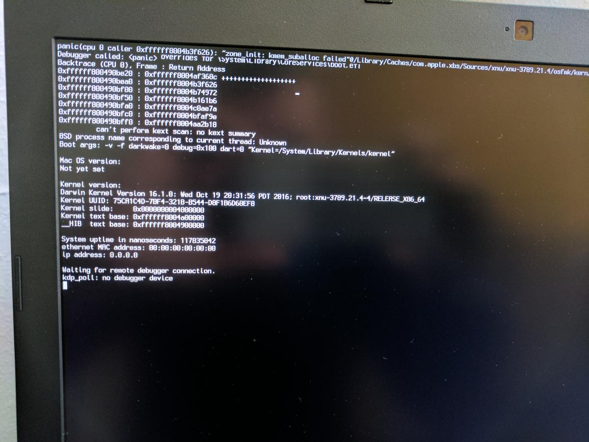

TECH_ATTACK Posted May 10, 2017 Share Posted May 10, 2017 Hello, ive just bought a new notebook for me. Its the Acer TravelMate P658-M-537B. Its a good piece of hardware with UMTS/LTE, non glossy FHD Display, very good batterie and good speed. In the past i installed OS X on many notebooks. Dell, Lenovo, Asus etc. All went fine, sometimes a little bit tricky, but i found a solution. Now, this Acer is really a hard thing. Hardware: CPU: Intel 6200u GPU: Intel HD520 SSD: Kingston M.2 (AHCI) WLAN: Intel (i know not working, will swap with DW1560) I get a KP directly after hit enter in Clover. (See attached photo) I use a Sierra installer with generic sets of kext/config.plist. But i cant even reach the installer. Most time i got a KP. Is someone here who knows what settings i have to use to install/use OS X on this notebook? Thanks in advance Greets 1 Link to comment Share on other sites More sharing options...

TECH_ATTACK Posted May 12, 2017 Author Share Posted May 12, 2017 @Allan Its a pandora installer USb Stick. @MaLdon THX. Tested. Same issue. After hitting installer in Clover instant KP Edit: I´ve found the reason. Seems to be clover is having problems with detecting amount of Ram. 1 Link to comment Share on other sites More sharing options...

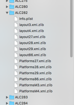

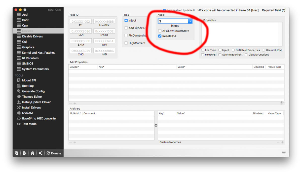

MaLd0n Posted May 16, 2017 Share Posted May 16, 2017 ALC282 u have these options, just inject, reboot, test 1 Link to comment Share on other sites More sharing options...
TECH_ATTACK Posted May 16, 2017 Author Share Posted May 16, 2017 Hey, i did use the "3". All is working fine. Thank you a lot. Sleep still not working, but not so important. Batterytime is better than under Windows. (over 10 Hours just with Office and Internet (WLAN)) 1 Link to comment Share on other sites More sharing options...
