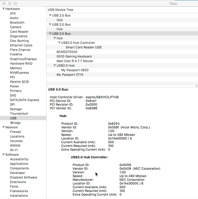

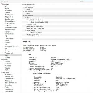

Thank you again for you help with my Sierra install.  I noticed however that my USB 3 is not completely correct.  I have a USB 2.0 hub inside the 3.0, etc... (See screenshot).  Easy fix?
USB 3.0 speed does not seem to be what it should be neither...
