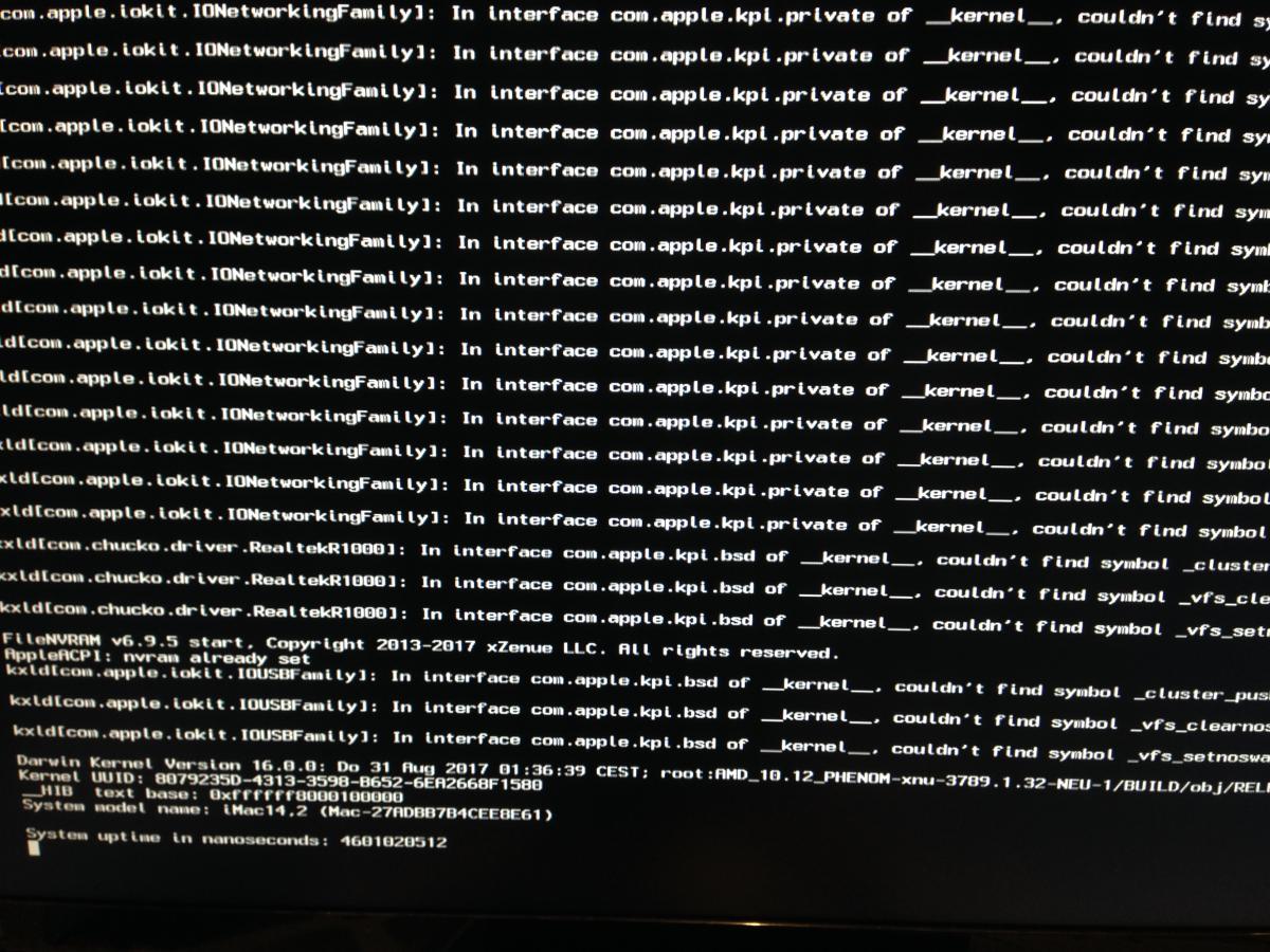

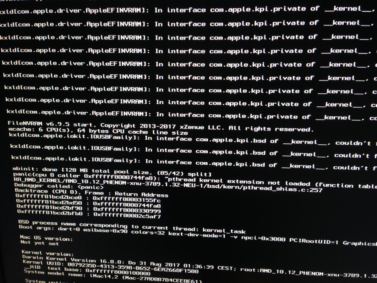

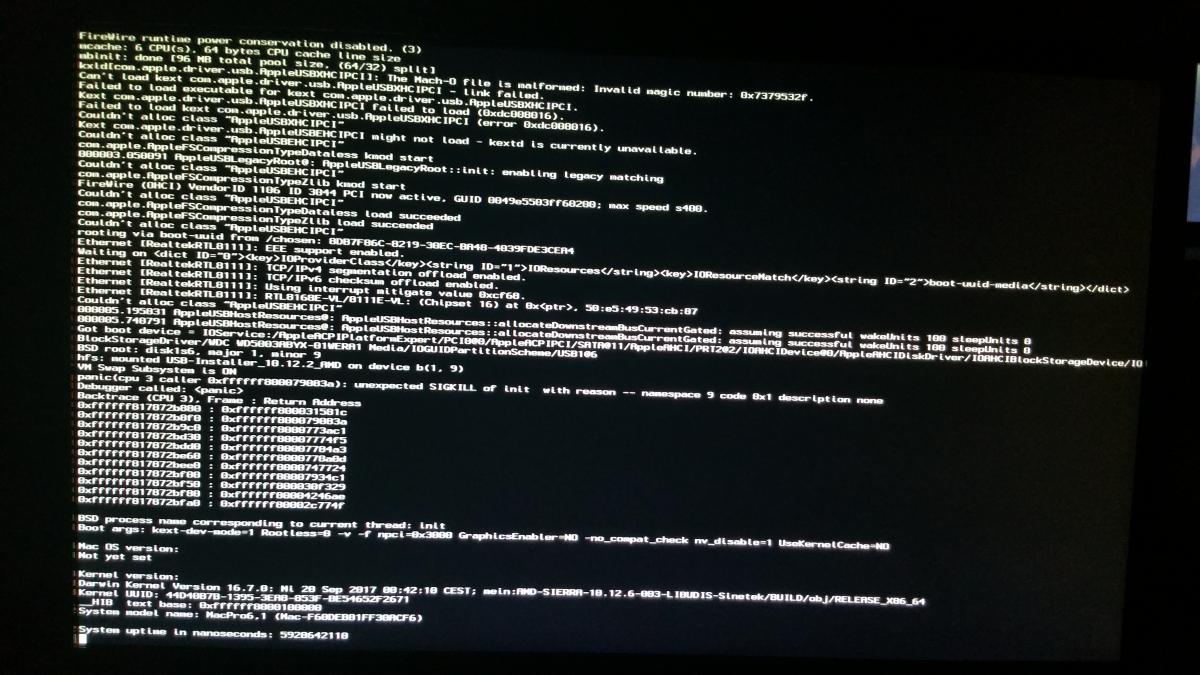

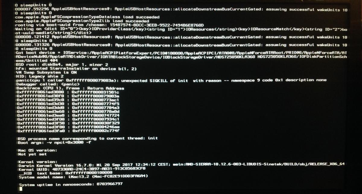

Thanks for this new testing kernel which got KP at 10.12.5 & 10.12.6 in FX-6300 hackintosh.

None of the SSE4.1 instructions are implemented.  There are only 5 SSE4.2 instructions here https://github.com/Shaneee92/SierraAMD-XNU/blob/master/osfmk/OPEMU/ssse3.c#L119.  This is not going to work.  Each of these is emulated with a function which takes ssse3 as argument.
If you add error check here
https://github.com/Shaneee92/SierraAMD-XNU/blob/master/osfmk/i386/trap.c#L806
you should be able to see that emulation fais, returns nonzero.
Here are all the instructions that need to be implemented: https://software.intel.com/sites/landingpage/IntrinsicsGuide/#expand=1244&techs=SSE4_1 .

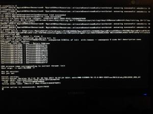

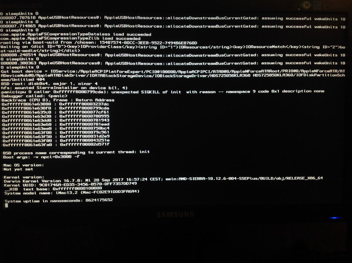

no luck hes rite same as above ,just a few usb  messages sneaked in between the panic output
You hit pextrq twice which is sse4.1.  These extract instructions are different because the destination is a regular register or memory.  The existing opemu code expect xmm registers as destination.  That's why fisttp emulation uses x87 instructions to modify memory location directly.  sse4.2 emulation writes to state64 to write registers.  Anyone knows x86 flags are restored when trap handler returns?  ptest instructions only changes the flags.  I could get the correct behavior by pushf/popf instuctions but if the flags get restored somewhere else.  These will have not effect.  Anyway to test opemu without working AMD Phenom system?  I have most of the emulation written.  Need to test against intrinsics first.  For pextr and ptest instructions, need to actually put this opemu.  Maybe I need to write a proper integration test.
now hang at this point with last kernel

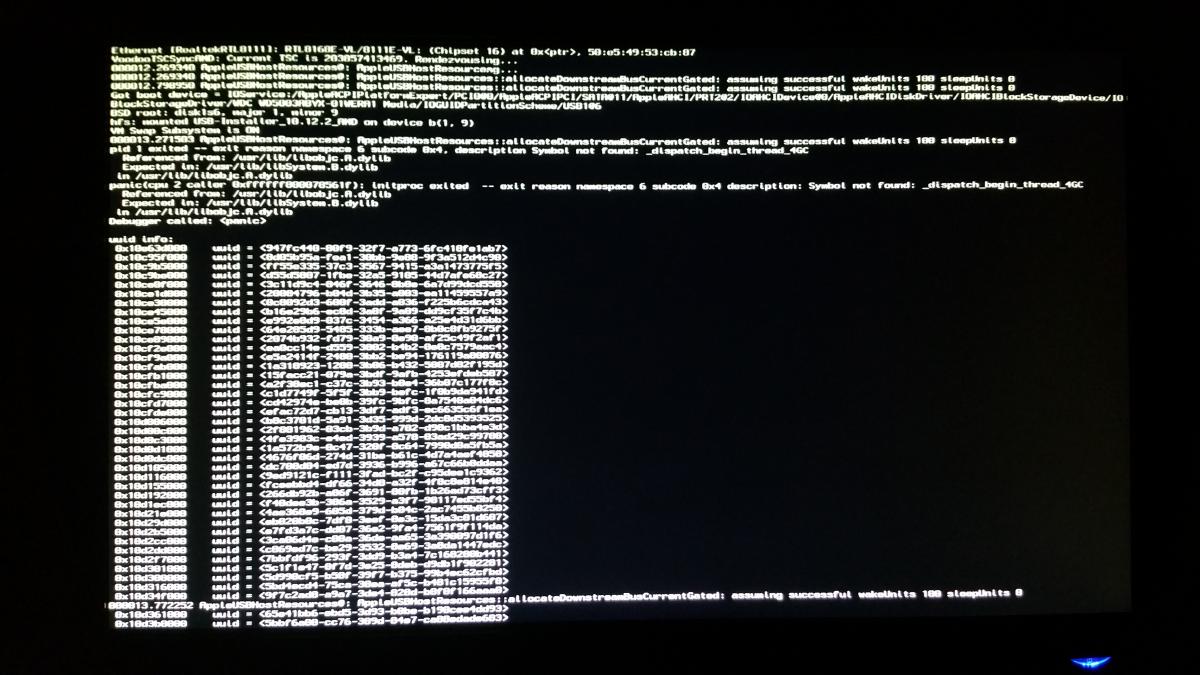

I cannot tell why init got killed.

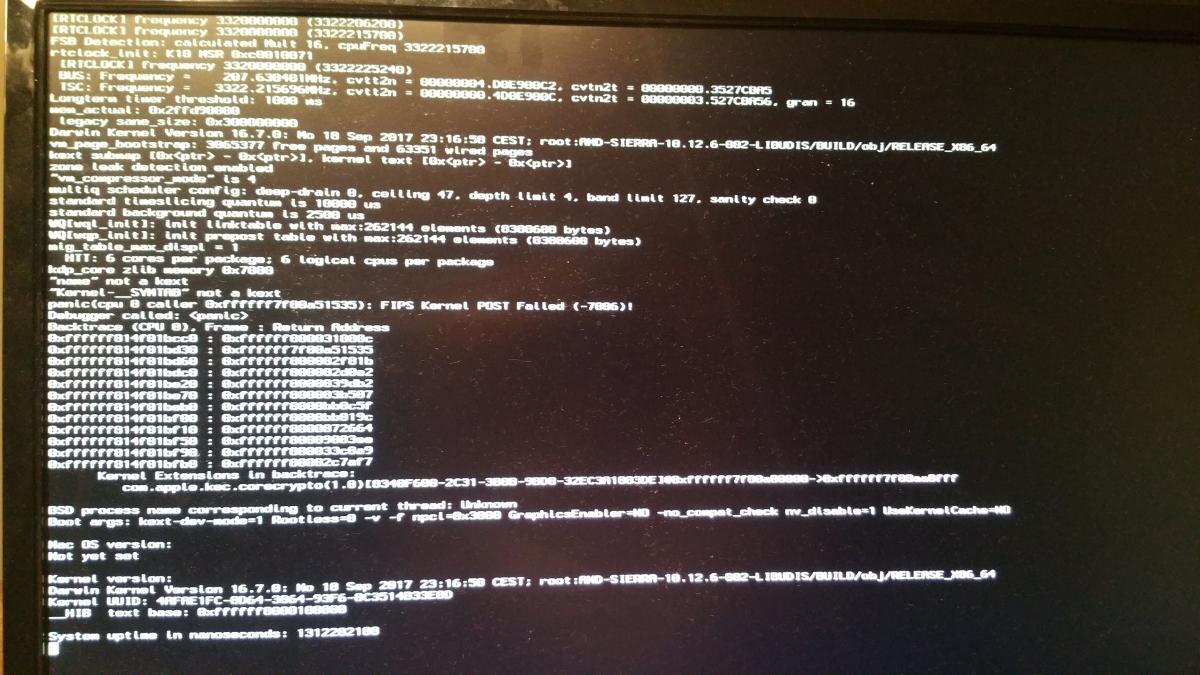

The corecryto one says the kext does not pass POST test, which means math error.
Apparently there are different versions of functions with different instruction sets.  avx2 functions should not be called if not available.

If opemu fails, it prints "OPEMU: instruction nmenic" , like the screen shots in AkimoA's post.
https://github.com/Shaneee92/SierraAMD-XNU/blob/master/osfmk/OPEMU/opemu.c#L104
