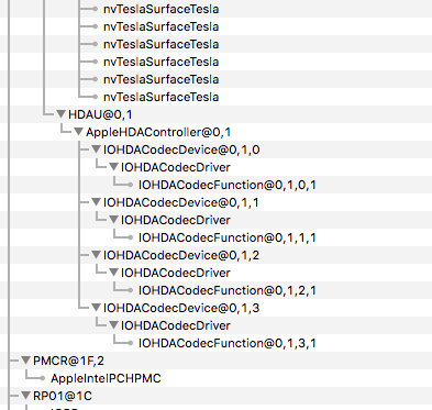

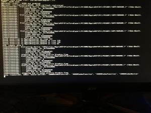

Asteroids Posted December 15, 2017 Share Posted December 15, 2017 Hi MaLd0n, Some months ago, you helped me with getting an older mobo going. Now I'm helping a friend with his new machine, which will help you with your Beer Fund! We did the basic install (almost entirely following your instructions). It boots 10.12.6 Sierra, has Ethernet, sleeps, wakes (with TWO button presses), does actually shut-down and looks pretty good overall. The graphics card is causing a bit of a slowdown during boot, though. The system is a: Gigabyte GAZ270X-UD3 (with F7 BIOS, PCB is Rev. 1.0) 32 GB RAM 7700K GeForce 210 (I know, right!?! He's going to upgrade that in a few months) Please take a look, and let us know what you see (and a DSDT would be great). (BTW: I did have to update the version of USBInjectAll.kext to get the 3.0 ports working.) Thanks! Asteroids Asteroids_FlatResponse iMac Z270X 7700K.zip origin_DSDT_aml_files_from_Z270X-UD3_Asteroids_FlatResponse.zip Send me Asteroids_FlatResponses iMac.zip 1 Link to comment Share on other sites More sharing options...
MaLd0n Posted December 15, 2017 Author Share Posted December 15, 2017 Hi MaLd0n, Some months ago, you helped me with getting an older mobo going. Now I'm helping a friend with his new machine, which will help you with your Beer Fund! We did the basic install (almost entirely following your instructions). It boots 10.12.6 Sierra, has Ethernet, sleeps, wakes (with TWO button presses), does actually shut-down and looks pretty good overall. The graphics card is causing a bit of a slowdown during boot, though. The system is a: Gigabyte GAZ270X-UD3 (with F7 BIOS, PCB is Rev. 1.0) 32 GB RAM 7700K GeForce 210 (I know, right!?! He's going to upgrade that in a few months) Please take a look, and let us know what you see (and a DSDT would be great). (BTW: I did have to update the version of USBInjectAll.kext to get the 3.0 ports working.) Thanks! Asteroids Hi, Aste Welcome back Check CLOVER.zip replace, reboot and send me new ioreg test sleep, etc, wake with power button 2 Link to comment Share on other sites More sharing options...

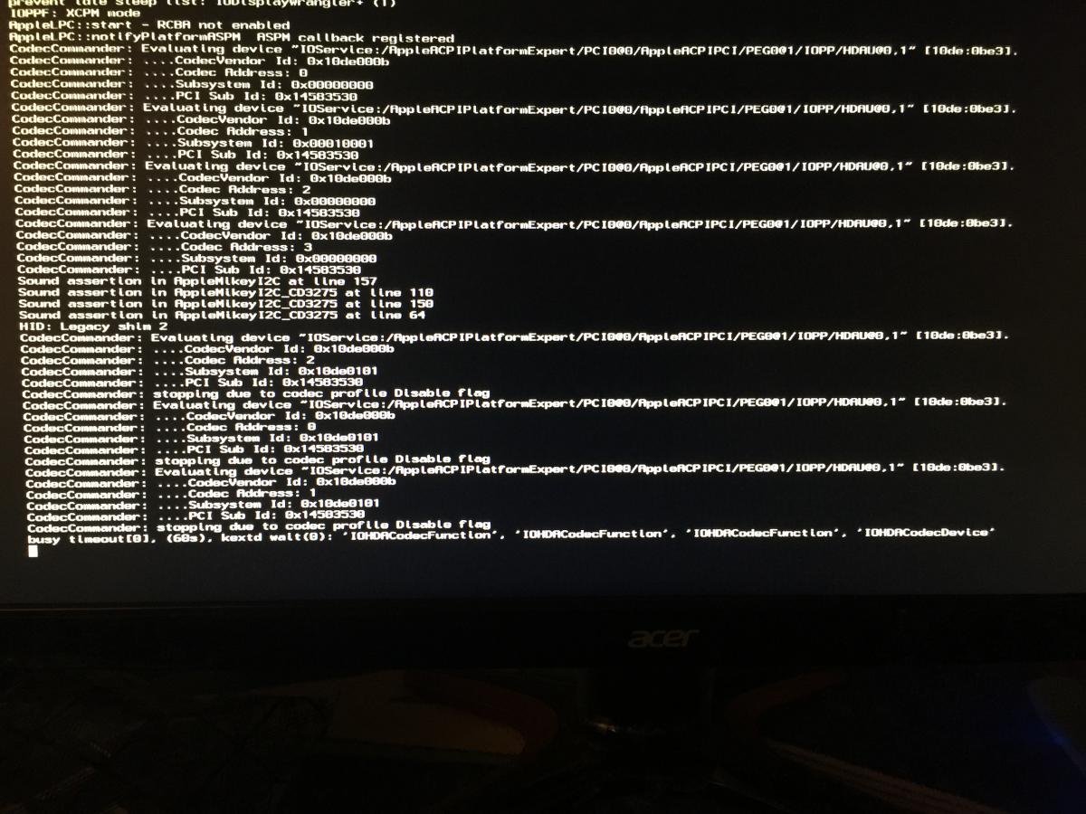

Asteroids Posted December 15, 2017 Share Posted December 15, 2017 Hi, Aste Welcome back Check CLOVER.zip replace, reboot and send me new ioreg test sleep, etc, wake with power button Done. Sleeps, wakes with Power Button. Shuts down properly. During boot it still has a delay of about 2 minutes because of "IOHDACodecFunction" (see attached pic), which I'm fairly sure is caused by the audio-on-HDMI-port of the video card. Should I go ahead with Piker-Alpha's SSDT stuff for Power Management? I just realized I did not yet do that. Thanks! Asteroid_FlatResponses iMac #2.zip 1 Link to comment Share on other sites More sharing options...
MaLd0n Posted December 15, 2017 Author Share Posted December 15, 2017 Should I go ahead with Piker-Alpha's SSDT stuff for Power Management? I just realized I did not yet do that. dont need check, PM work, all in DSDT During boot it still has a delay of about 2 minutes because of "IOHDACodecFunction" (see attached pic), which I'm fairly sure is caused by the audio-on-HDMI-port of the video card. ye, i think yes too see HDMI work native try remove NvidiaGraphicsFixup.kext, the kext inject audio HDMI 1 Link to comment Share on other sites More sharing options...
Asteroids Posted December 15, 2017 Share Posted December 15, 2017 try remove NvidiaGraphicsFixup.kext, the kext inject audio HDMI Bing! Now it boots in seconds You are a giant among men. Beer funds sent! Thank you so very much! I spent hours trying to figure that out. Is it possible to avoid the "Disk Not Ejected Properly" for USB Flash Drives, when waking from Sleep? Link to comment Share on other sites More sharing options...
