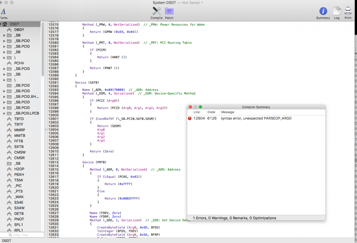

sarvodaya1219 Posted November 22, 2017 Share Posted November 22, 2017 DELL or HP? MaLd0n 2017-11-16 às 11.38.44.png without errors for ur try DSDT.aml.zip Tried the DSDT. Getting One Error "SYNTAX ERROR, UNEXPECTED PARSEOP_ARGO" Link to comment Share on other sites More sharing options...
MaLd0n Posted November 22, 2017 Author Share Posted November 22, 2017 use acpi6,1 Link to comment Share on other sites More sharing options...

sarvodaya1219 Posted November 23, 2017 Share Posted November 23, 2017 use acpi6,1 Used latest Maciasl. In preferences selected acpi6.1. Patched the DSDT. But getting kernel panic. Booted into windows. removed the DSDT in patched folder and rebooted again,. Link to comment Share on other sites More sharing options...

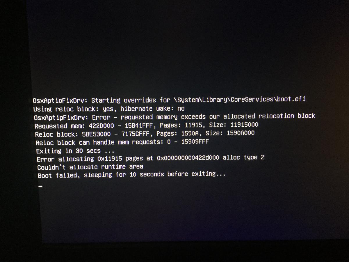

MaLd0n Posted November 26, 2017 Author Share Posted November 26, 2017 MSI z170a Gaming M7 would not boot with OsxAptioFixDrv-64.efi, but did boot with OsxAptioFix2Drv-64.efi. Thanks MaLd0n this thing was giving me a headache to even boot and hope to recover my old install since I upgraded Hopefully this will let me see if I even want to recover or start fresh, probably fresh Edit: I backed everything up with command line, partitioned my ssd to erase it, installed and get greeted with a similar screen. OsxAptioFixDrv: Starting overrides for \macOS Install Data\Locked Files\Boot Files\boot.efi Using reloc block: no, hibernate wake: no Error allocating 0x11915 pages at 0x00000000071e8000 alloc type 2 Couldn't allocate runtime area Boot failed, sleeping for 10 seconds before exiting... So... I am guessing it may have to do with apfs or something else since the installer booted fine? Ok, it worked when I enabled nv_disable=1... Got stuck at kextd stall[0], seems fakesmc isn't loading... it is in the 10.13 folder as the latest clover and 10.13.1 worked like that before... if it doesn't boot this time I am going to bed lol No cliff hangers, I keep getting that message again... even with nv_disable not sure what's going wrong so it's time to sleep. use OsxAptioFix2Drv-64.efi use kexts in Library/Extensions and put only fakesmc in Clover/Kexts/Others for updates i using fakesmc in clover folder and library/extensions, no problems MaLd0, can you tell me how can I solve my problem? use a fresh install, intall clover, replace folder, only it 2 Link to comment Share on other sites More sharing options...
