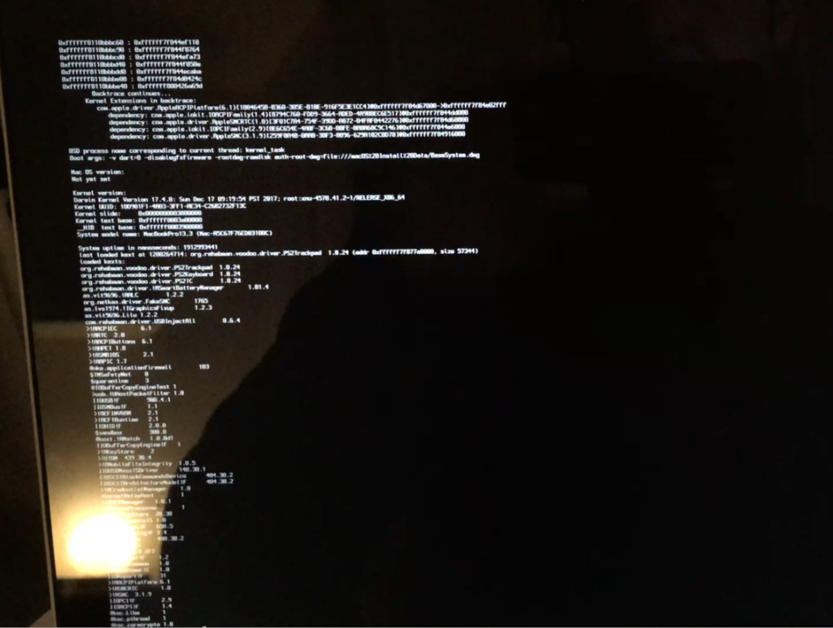

using your Clover folder I have a kernel panic. I had to make a video to understand what is the cause, I am attaching this frame, you are able to understand what it depends on?

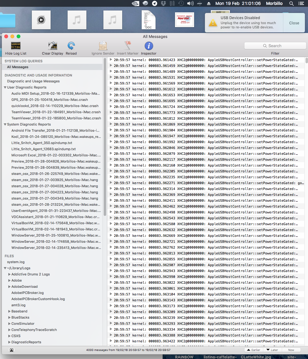

Here my zip file! I don`t know if Audio is still right configured. I'm just using a extern interface!!
After a sleep:
"USB device disabled. unplug the device using too much power to re-enable usb devices"
on the console:
kernel[0]: 035766.910192 AppleUSBXHCIPCI@00000000: AppleUSBHostController::setPowerStateGated: going to state 1 returned 0xe00002e9
kernel[0]: *** kernel exceeded 500 log message per second limit  -  remaining messages this second discarded ***
Thx in advance  for your support.
Send me Morbillos-iMac.home.zip
remove DSDT and check if work

Hi Mald0n
After a sleep:
on the console:

no...
does not start in any way, I also tried to remove extensions and clover flags. Using the old folder Clover (which I enclose) once started from the stick, the second attempt to boot in kernel panic as you can see from the picture that I attach.
can it be something related to the msr patch?
CLOVER.zip
no...

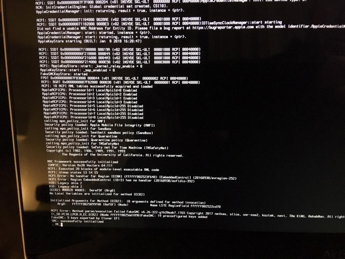

try it
change H_EC to EC
485f4543
45435f5f

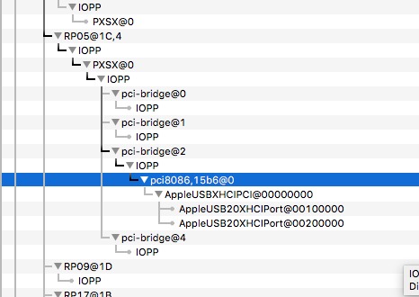

on ioregistry explorer there are any red port but after a wake up the console begin to report
u have thunderbolt?
On board there is a port but nothing is plugged on!!!

I've also noticed a rise in temperature after 1st awake. I think this is related tho the usb power issue
Sorry, but again : i'm running on el capitan (just cause the topic) are the settings right?

in log is XHC2, XHC2 is a usb c inside RP05/PXSX
try create a SSDT for power management and check if solve
