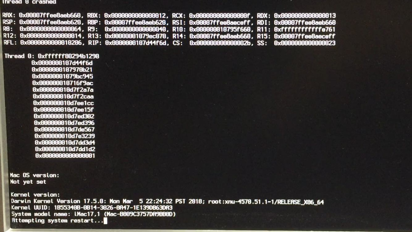

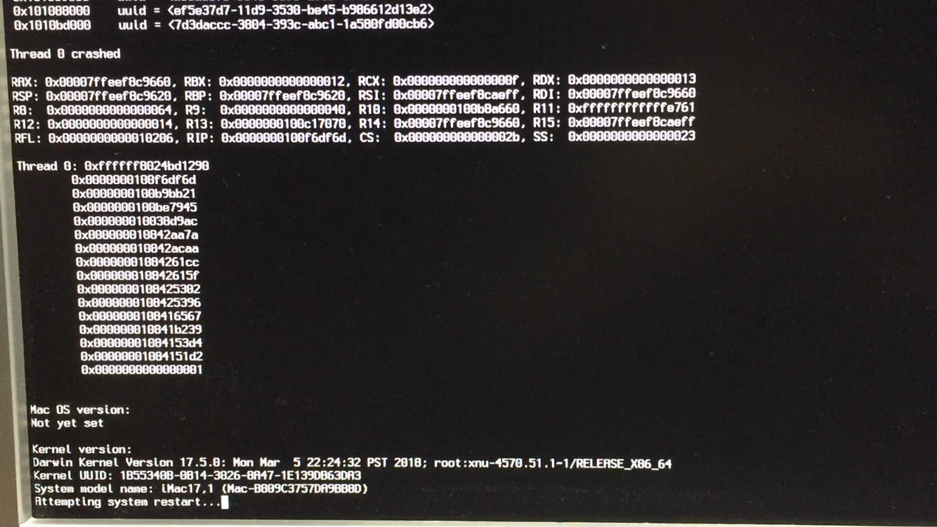

vtec100000000rpm Posted April 11, 2018 Share Posted April 11, 2018 (edited) Hello. I've got the error message "Attempting system restart..." when I boot "Install macOS High Sierra" 10.13.4 from USB memory. CLOVER folder was replaced with MaLd0n's one, and FakeSMC is replaced by the latest version. I attempted some versions of OsxAptioFixDrv instead of AptioMemoryFix.efi , but they didn't work. Dell Vostro 3267 Celeron G3900 Skylake ATi RADEON HD5450 Can Anyone help me? Excuse me for my poor English... (@_@ config.plist ACPI.zip Edited April 12, 2018 by vtec100000000rpm Product name: Optiplex -> Vostro Link to comment Share on other sites More sharing options...
MaLd0n Posted April 11, 2018 Author Share Posted April 11, 2018 u need a fakecpuid, celeron don't have native support Link to comment Share on other sites More sharing options...

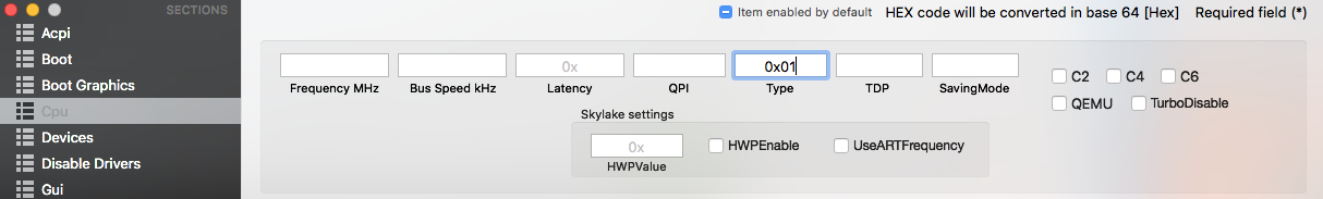

vtec100000000rpm Posted April 11, 2018 Share Posted April 11, 2018 Thank you for your reply , MaLd0n ! I tried "0x0506E3"(Skylake H) and "0x0406E3" (Skylake U) , but it restarted at the same step. Mmm... Link to comment Share on other sites More sharing options...
MaLd0n Posted April 11, 2018 Author Share Posted April 11, 2018 try a KernelCPU in config.plist Link to comment Share on other sites More sharing options...
vtec100000000rpm Posted April 11, 2018 Share Posted April 11, 2018 33 minutes ago, MaLd0n said: try a KernelCPU in config.plist Thank you. Then I tried it, however it restarted at the step again.... config.plist Link to comment Share on other sites More sharing options...
gagaraz Posted April 11, 2018 Share Posted April 11, 2018 Hello MaLd0n Please help me with DSDT & Clover -ROG STRIX z370-F GAMING -8700k https://drive.google.com/open?id=1zGwSTJWRBd1-Nw046Mp-ZTLXsRj0tr4G Link to comment Share on other sites More sharing options...
MaLd0n Posted April 11, 2018 Author Share Posted April 11, 2018 1 hour ago, vtec100000000rpm said: Thank you. Then I tried it, however it restarted at the step again.... config.plist Try other smbios, i never use this processor 1 Link to comment Share on other sites More sharing options...

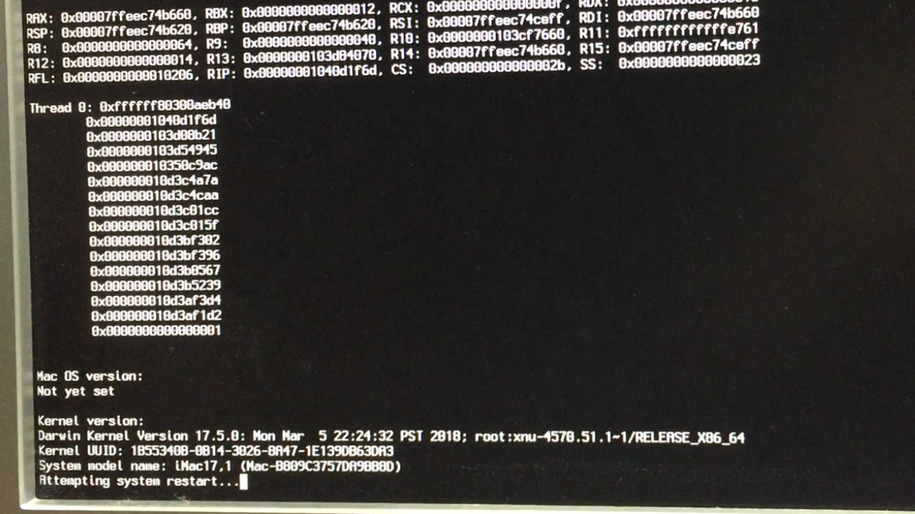

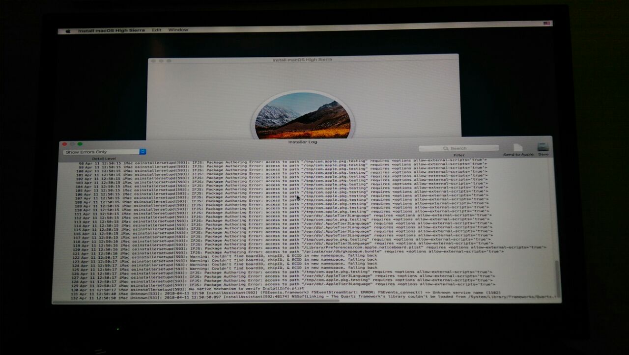

vtec100000000rpm Posted April 12, 2018 Share Posted April 12, 2018 (edited) 21 hours ago, MaLd0n said: Try other smbios, i never use this processor Thanks a lot ! I succeeded to boot from USB memory , and installed from USB memory to HDD with following settings. SMBIOS: iMac 13.2 (i5-3470) FakeCPUID: 0306A0 (IvyBridge) KernelXCPM: True (Couldn't boot without this check) But the second step of installing (boot from HDD) , it has got another error and aborted. I attempted to add FakePCIID.kext , but it didn't work.... Any idea ? config.plist Edited April 12, 2018 by vtec100000000rpm add the latest config.plist 1 Link to comment Share on other sites More sharing options...

vtec100000000rpm Posted April 13, 2018 Share Posted April 13, 2018 On 2018/4/12 at 11:39 PM, vtec100000000rpm said: Thanks a lot ! I succeeded to boot from USB memory , and installed from USB memory to HDD with following settings. SMBIOS: iMac 13.2 (i5-3470) FakeCPUID: 0306A0 (IvyBridge) KernelXCPM: True (Couldn't boot without this check) But the second step of installing (boot from HDD) , it has got another error and aborted. I attempted to add FakePCIID.kext , but it didn't work.... Any idea ? config.plist I succeeded to finish install with this config.plist. Thank you very much ! But at the 1st boot from HDD, " IOConsoleUsers: gIOScreenLockState 3 ..." error occured and looped. (This thread is the installation guide, so I go to another thread.) config.plist 1 Link to comment Share on other sites More sharing options...
