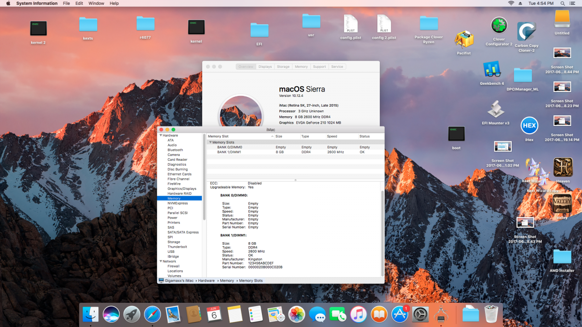

busratio and fsb works for chameleon and clover !
Interested that if wrong memory ram ...
I think that clover is bad ... =)))
I already had a discussion with Slice a long time ago about the flag "busratio" and he always told me that this flag did not work on clover, "fsb" yes, there are other flags scheduled to This effect for determined the busratio and the fsb, in any case with the kernel auto 16.5, no flag changes the kernel clock, the value is well set and good for the 1700 :) if it allows to start with clover, Why not but normally has no impact. When I overclock my Ryzen, it takes the bios values and not the flag I could have written :)
In any case, even if the clock is not good, this does not prevent to start macOS.
It is strange, because if not used the keyboard doesn't work, it will reach the log in screen but no entry. It should not be needed but it does work.
Is the problem? Slide=0 rootless=0 keepsymbols etc... because it worked for two people with ncpi=0x3000 busratio=30 only.
I tired many times with your config.plist and files but it didn't work the same as Ciro82. I have X370 board with USB 3.1 type A and type C and every attempt ended with USB error using your configuration. Maybe the X370 configuration needs different parameters?

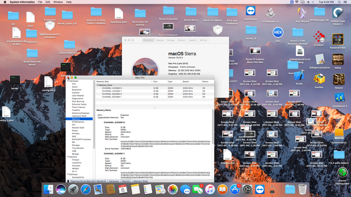

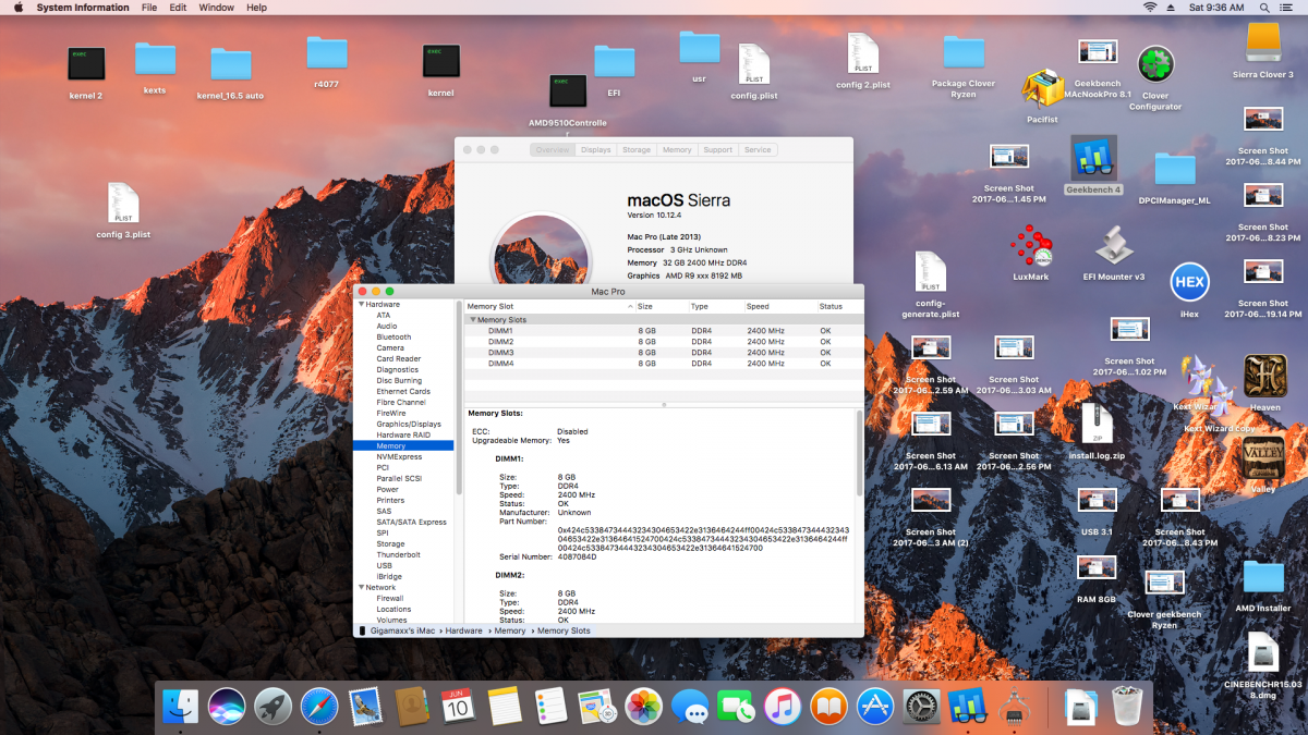

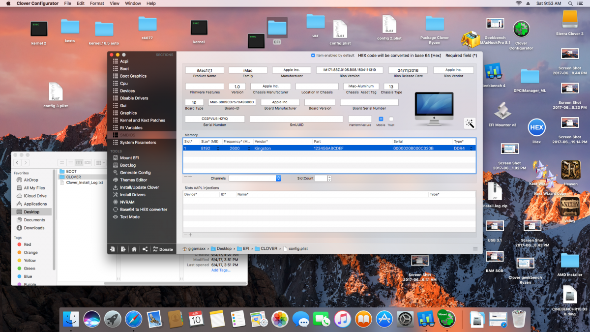

Another strange anomaly in clover is my Ram is listed as 8gb Kingston 2600MHz, but in chameleon it is listed correctly as 32gb 2400MHz. It is Crucial ram not Kingston.
The problem comes from different motherboards and their different bios and chipsets;)
Asus AMI bios works fine without problems, clock ram 2133 corsair is true :)
Clover gives a lot of cosmetic values that do not have real effects on proper operation, audio is a good way to see if your clock is well set, you can compare video / audio recordings with windows to see if the Clock is correct, in clover boot.log also.

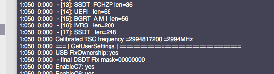

in clover I wrote 3000 Mhz, the real tsc of my cpu is this: Calibrated TSC frequency =2994828300 =2994MHz
look with busratio=35, no change value ;)
Edited by papiercul

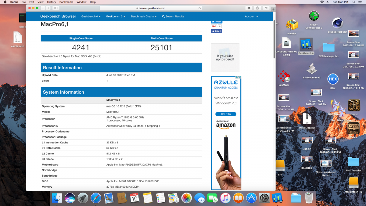

test:

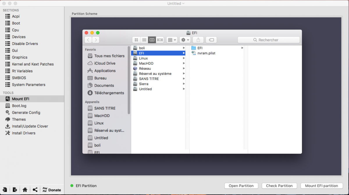

look , CPU o/c at 3400 Mhz, = 1700x, generate new file nvram
I do not know if it will work, to try :)

1:058  0:000  Calibrated TSC frequency =3394150980 =3394MHz

nvram.plist.zip

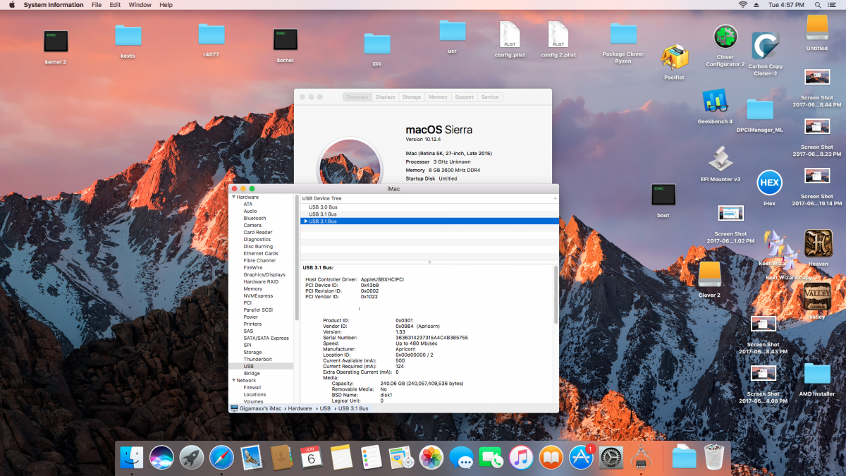

Here is the clover USB 3.1 and RAM 8gb
boot.log clover, please
Voyager GT 3.0 :
  Identifiant du produit :    0x1a09
  Identifiant du fournisseur :    0x1b1c  (CORSAIR MEMORY INC.)
  Version :    1.00
  Numéro de série :    0708530D841DDF60
  Vitesse :    Jusqu’à 5 Gb/s
  Fabricant :    Corsair
  Identifiant de l’emplacement :    0x00300000 / 2
  Courant disponible (mA) :    900
  Courant requis (mA) :    504
  Exploitation supplémentaire actuelle (mA) :    0
  Intégré :    Oui
  Media :
Voyager GT 3.0 :
  Capacité :    31,64 Go (31 641 829 376 octets)
  Support amovible :    Oui
  Nom BSD :    disk2
  Logical Unit :    0
  Type de carte de partition :    MBR (partition Master Boot Record)
  USB Interface :    0
  Volumes :
CLOVER :
  Capacité :    2,92 Go (2 920 783 872 octets)
  Disponible :    2,9 Go (2 901 843 968 octets)
  Inscriptible :    Oui
  Système de fichiers :    MS-DOS FAT32
  Nom BSD :    disk2s1
  Point de montage :    /Volumes/CLOVER
  Contenu :    DOS_FAT_32
  UUID du volume :    1D6C979C-83EB-3515-A53A-00DF5B212973
OS X Base System :
  Capacité :    28,72 Go (28 721 043 968 octets)
  Disponible :    22,16 Go (22 158 397 440 octets)
  Inscriptible :    Oui
  Système de fichiers :    HFS+
  Nom BSD :    disk2s2
  Point de montage :    /Volumes/OS X Base System
  Contenu :    Apple_HFS
  UUID du volume :    E4C5F3AB-913E-3A96-98B2-8B4E8CEE1A23

Ok so I can boot using clover and install using clover with my nvidia driver working. My problem is how can I get rid of this

I checking memory ram - is correct showing  kingston .
Normal shows =)
But why for you problem ... interested ))

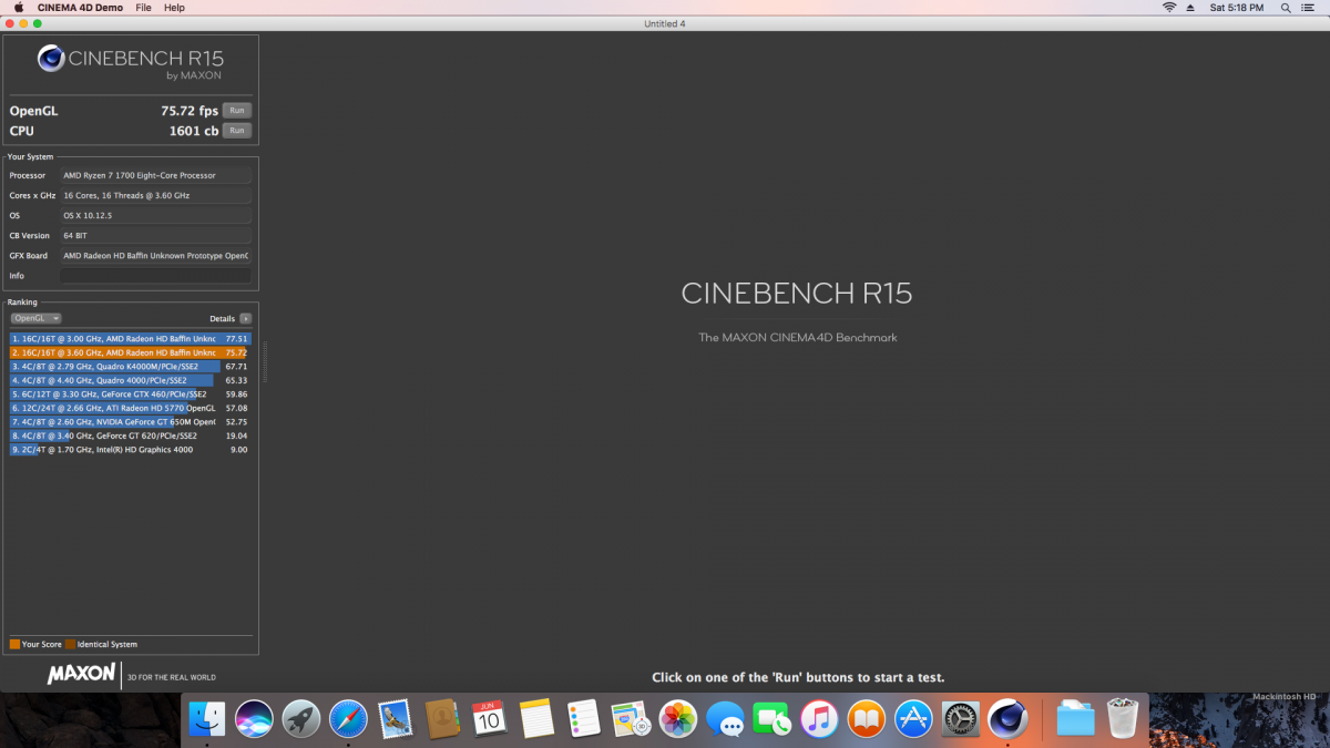

Clover Ryzen build Sierra 12.5. with auto kernel 16.5  boot arg.   npci=0x3000 busratio=36.    CPU setings in clover left blank or 000000 values.    I'm only using boot argument to set CPU frequency.    Running very stable.
Thanx.
Same CPU/Boot settings. Kernel 16.5 auto
iMac 14,2 Ryzen 1800X @ 3.60 GHz   https://browser.geekbench.com/v4/cpu/3085735
Single-Core Score 4775
Multi-Core Score 26176
