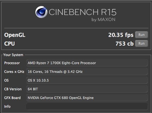

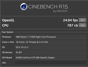

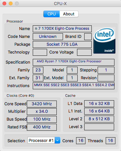

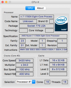

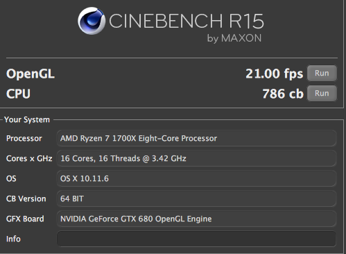

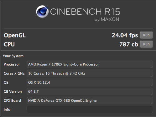

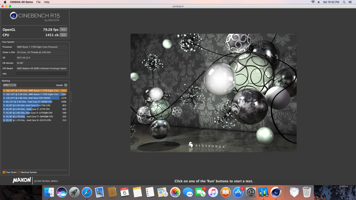

After booted without busratio=xx there are obvious improvement as below (machdep.tsc.frequency: 1710300079):
1. Timer was not so fast as before, but it's still too fast.
2. Performance was much higher than before (about 50% for CPU at Windows 10, 20~25% for GPU GTX-680 at Windows 10)
3. Stability was also much better now.
I'll try to fix and improve it more, e.g. the performance of CPU & GPU by Cinebench R15 should be much higher than current test values.

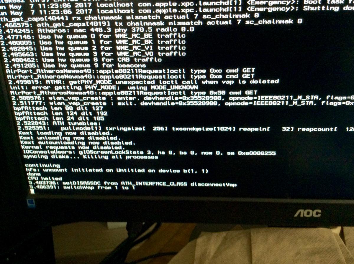

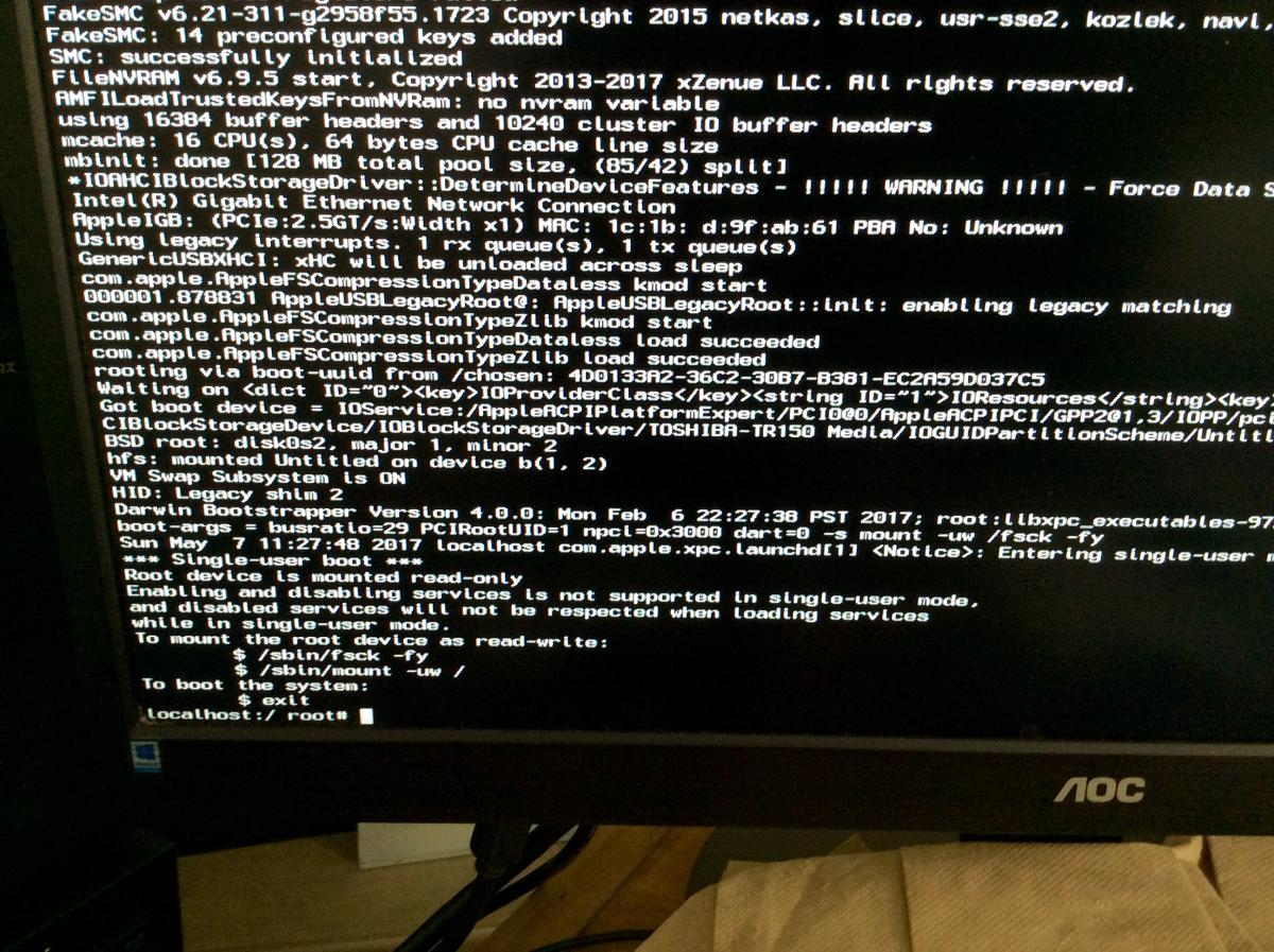

I'm getting shutoff, it loads up to login then shuts down. I included all the framework, extensions and kernel files in S/L folders and also in Extra folder. Should I just load the kernel and try again?
This is with original boot file. Does this need to be used with the beta kernel(s)?
try flag -s , and then write :
mount -uw /
fsck -fy
exit
mount -uw /
fsck -fy
exit

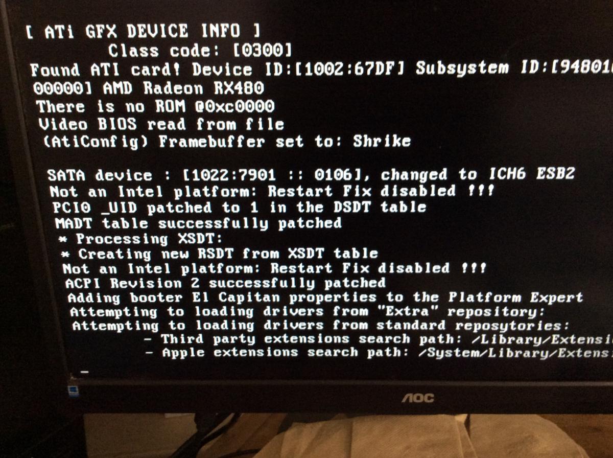

First pic is with -v -x the second photo is with -s and the other commands. The first pic was after removing my wifi card as the first screenshot.
I will replace my S/L folder and retry the install of frameworks I only got the merge option on the kernel frameworks loading the other two only had the replace option.

Gigamaxx , you need repair permissions !

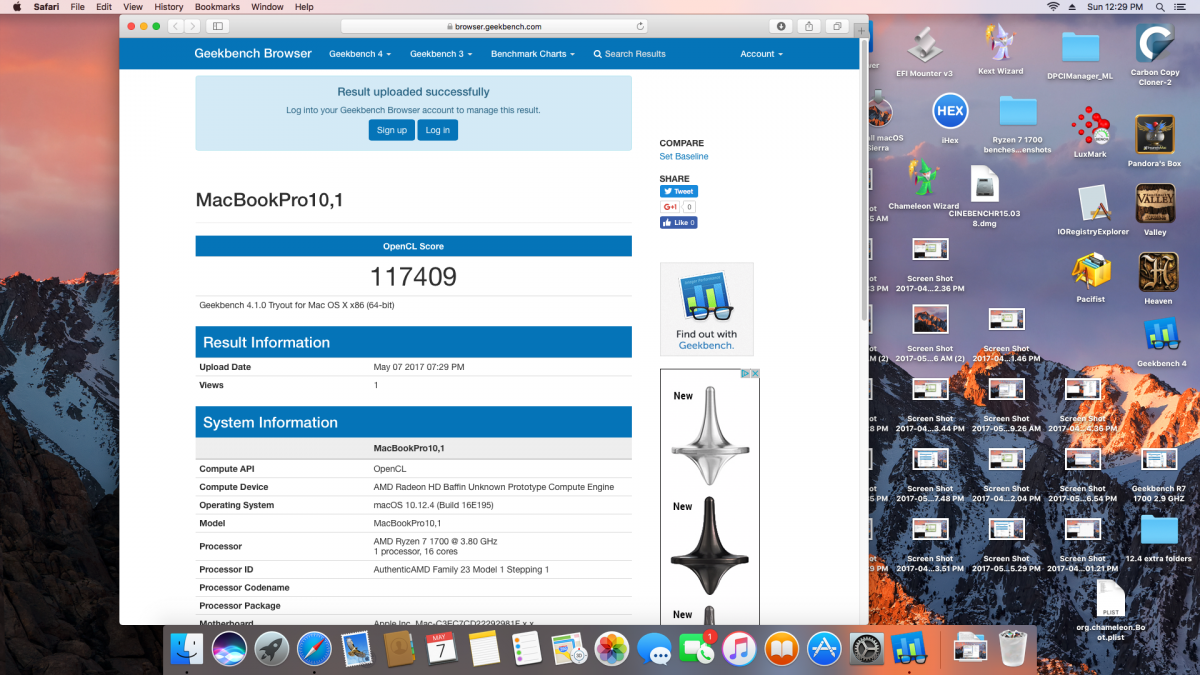

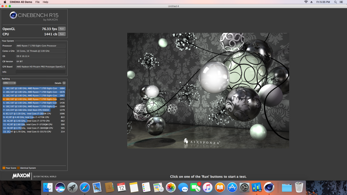

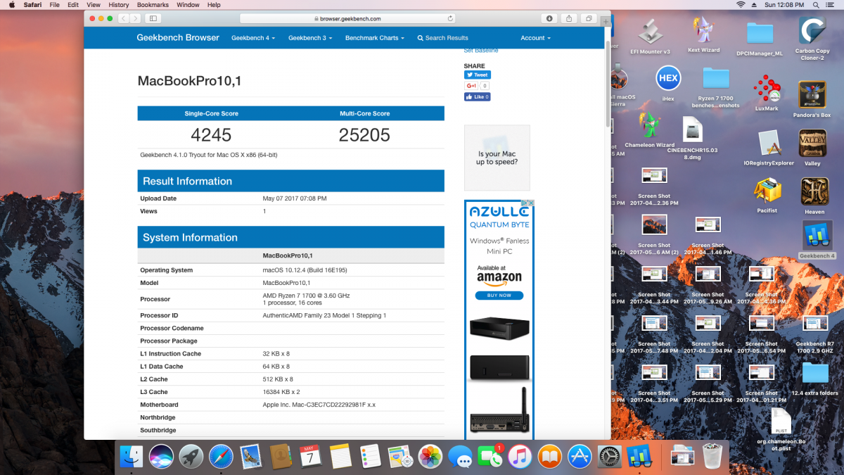

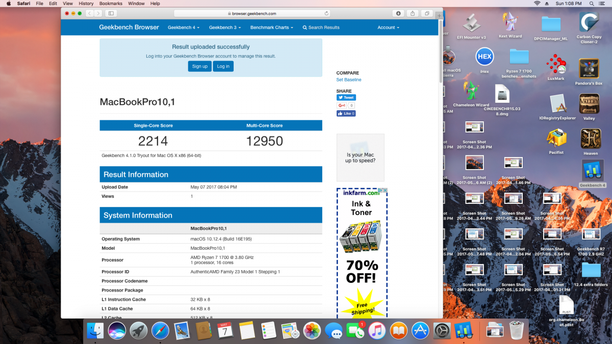

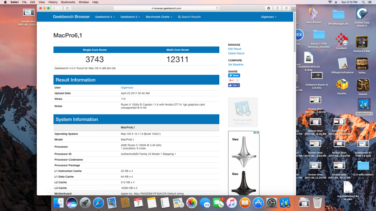

After replacing my files and then reapplying the new fixes it booted no problem, I installed wifi card and ran a Geekbench @ 3.6 GHz.   It works!   Yes check out the multi thread core.   Now for 37-39 GHz tests.   This is with original boot file.
Once again, Bronya you da man!

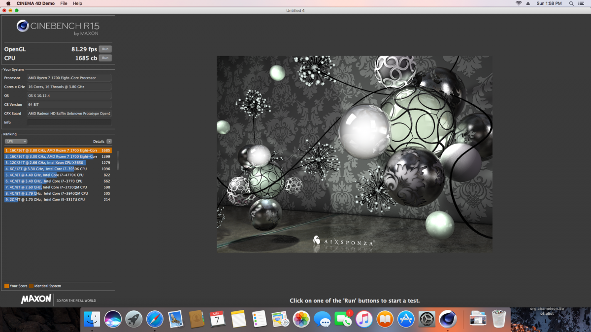

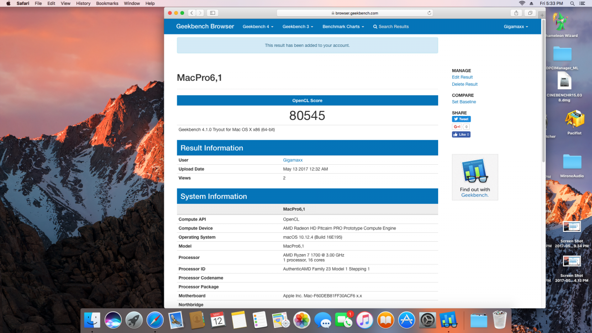

Ok to sum up so far, the new Kernel and other files work great!    I cannot get the new boot test zip to boot correctly      Using the original Boot and the new kernel and other files has allowed me to overclock my Ryzen 7 1700 to 3800 MHz with stability.    3900MHz crashes at boot up, I have stock fan system.
With original boot file I need to add busratio=(38 or whatever my CPU bios setting is) or I get the 1/2 performance or frequency issue.  see pics.     Notice the RX 480 compute benchmarks as well.   It affects both the CPU and Graphics cards the same way, 1/2 performance level.
machdep.tsc.frequency: 3800118979

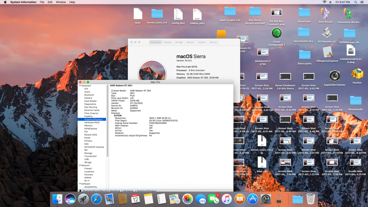

Graphics Cards
Nvidia
Nvidia GT 210 1gb DDR3 EVGA, Nvidia GT710 2gb MSI, Nvidia 8400GS EVGA.    All of these worked with nv_disable=1 and after initial configuration they worked without nv_disable=1.    My purpose for these cards is to supply a IGPU or internal graphics (CPU graphics) type of solution to run my AMD RX 4XX series cards.
AMD
AMD XFX RX 480 reference 8GB 1266-1288MHz.  Runs good but performance is lower using Nvidia helper cards than with my Pentiuum internal graphics (Skylake IGPU is even better).
AMD GIGABYTE RX 460 4gb (no 6 pin power).
