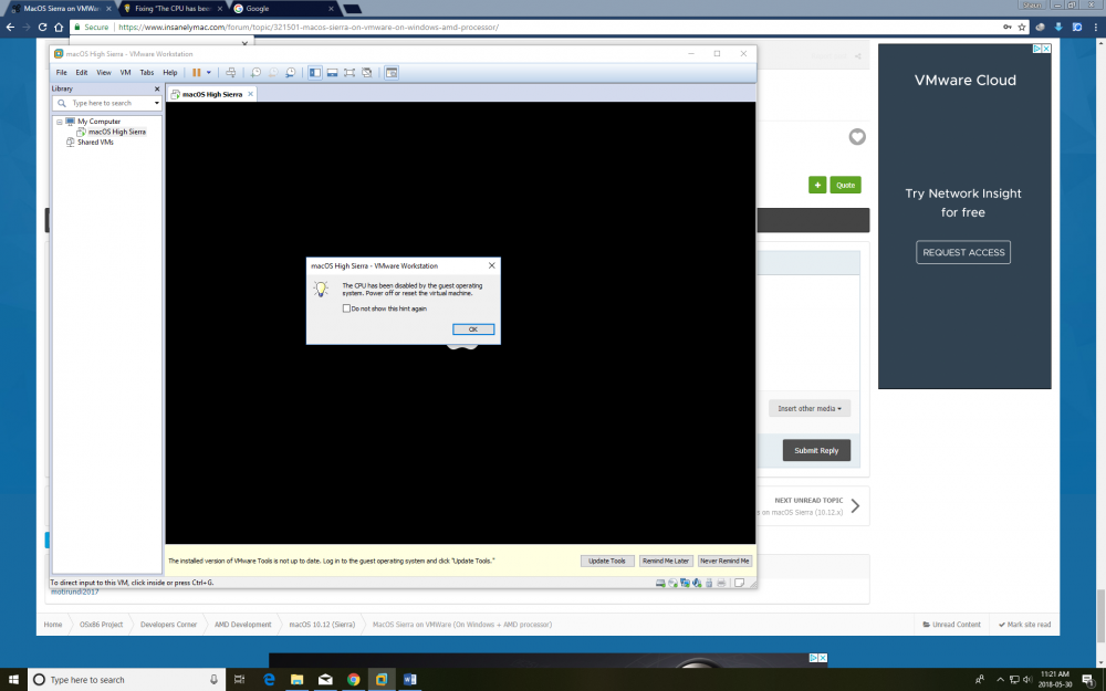

InTheY2K Posted April 14, 2018 Share Posted April 14, 2018 (edited) Hi, I am new to this whole macOS VM thing, and I hope my question is placed correctly here. After successfully installing and running macOS Sierra (10.12.5) with VMware Player 12.5.5 on my Acer Aspire (AMD A10-7300) for a couple of days I fell for the temptation to run the update to High Sierra, as it suggested. The update seemed to run smoothly but upon reboot it said "The CPU has been disabled". According to my research I suppose that High Sierra is not working with VMware on AMD architecture, correct? I am confused. I have found a number of forum posts with different kernels but don't know how to apply them. What would be the right way to get it running? Thanks in advance for any pointers, Sascha Edited April 14, 2018 by InTheY2K Link to comment Share on other sites More sharing options...

motirundi2017 Posted May 30, 2018 Share Posted May 30, 2018 Can you also send me a link please or just tell me how to set up the sttings to get past the CPU has been disabled message. It would be greatly appreciated!!!! Link to comment Share on other sites More sharing options...

kinglibrus Posted July 18, 2018 Share Posted July 18, 2018 @Mundane1026 I am trying to run OS X High Sierra on VMware. My Proc is a AMD Phenom XII 955 If those files you have will help me can I get them? Getting the "Guest Operating System Disabled the CPU" Message. Link to comment Share on other sites More sharing options...

heldigard Posted February 18, 2019 Share Posted February 18, 2019 I have an AMD FX 8350 working on VMware 15, so you need edit the .vmx file with the info: smc.version = "0" cpuid.0.eax="0000:0000:0000:0000:0000:0000:0000:1011" cpuid.0.ebx="0111:0101:0110:1110:0110:0101:0100:0111" cpuid.0.ecx="0110:1100:0110:0101:0111:0100:0110:1110" cpuid.0.edx="0100:1001:0110:0101:0110:1110:0110:1001" cpuid.1.eax="0000:0000:0000:0001:0000:0110:0111:0001" cpuid.1.ebx="0000:0010:0000:0001:0000:1000:0000:0000" cpuid.1.ecx="1000:0010:1001:1000:0010:0010:0000:0011" cpuid.1.edx="0000:1111:1010:1011:1111:1011:1111:1111" featureCompat.enable = "FALSE" Also the unlocker 3.0.2: https://github.com/DrDonk/unlocker/releases Source: https://www.insanelymac.com/forum/topic/302641-guide-installing-os-x-108-1012-under-vmware-workstation-8-9-10-player-6-with-amd-host-cpu/ Link to comment Share on other sites More sharing options...
