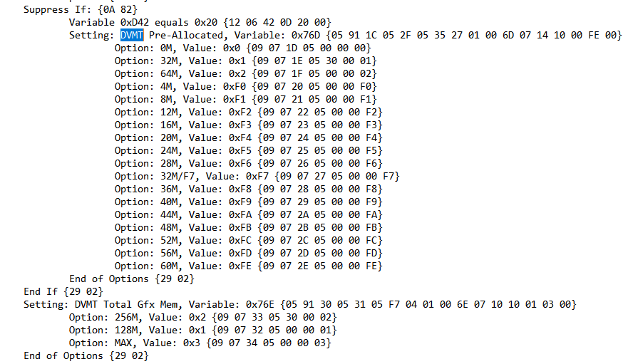

tikizondo94 Posted July 2, 2018 Share Posted July 2, 2018 (edited) How where you able to decipher what your original DVMT setting was in the BIOS extract? I can see the variable. But i have no idea what the "preset" variable would output in MB? My Dedicated Video In Device Manger for my GPU states 128MB. Im using a UHD 620. Screen output is 1920x1080 Edited July 2, 2018 by tikizondo94 Link to comment Share on other sites More sharing options...
