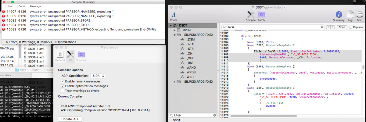

Ok, i generated another kext with spoof paramter and put it in the Other folder.
So basically i need to open DSDT.dsl and replace all _DSM occurrences with XDSM, compile, and then save it as .aml in patched folder?
errors:
line 14907:
 I2cSerialBusV2 (0x0020, ControllerInitiated, 0x00061A80,
                    AddressingMode7Bit, "\\_SB.PCI0.I2C0",
                    0x00, ResourceConsumer, _Y24, Exclusive,
line 15068:
CreateWordField (SBFB, \_SB.PCI0.I2C0.HDAC._CRS._Y26._ADR, ADR)  // _ADR: Address
Store (CADR, ADR)
CreateDWordField (SBFI, \_SB.PCI0.I2C0.HDAC._CRS._Y27._INT, AINT)  // _INT: Interrupts
line 15085:
                If (LEqual (BID, 0x20))
                    Return (SBFB)
                Return (ConcatenateResTemplate (SBFB, SBFI))
            Method (_STA, 0, NotSerialized)  // _STA: Status
                If (LNotEqual (I2SC, Zero))
                    Return (0x0F)
                Return (Zero)
I renamed it to something with .bak. is it some problem? I can boot Mac with it but can't boot windows because it is seen as legacy HD.
Wysłane z mojego Pixel przy użyciu Tapatalka
Yes. Yes rename as instructed above
errors:
If you're going to use static patching to rename _DSM->XDSM, you will need to disassemble correctly, and use correct tools for disassembly and re-compilation.
Or you can use the _DSM->XDSM hotpatch which is just a simple entry in config.plist.
