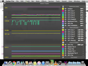

kosakgroove Posted December 15, 2016 Share Posted December 15, 2016 Hi guys, this is my first desktop HackintoshSpecs are as follows:Gigabyte EP45-UD3LRIntel Core 2 Quad Q6600NVIDIA Geforce 210 1024 MB VRAMWhen using NullCPU power management you can see the temps are really great. The performance is definitely better without that kext, but when I am using no NullCPU and use the Generate P and C states options in Clover, along with Drop OEM SSDT, temps go up to 60ºC all the time, whether it is heavy load or idling.I know the ssdtPRGen.sh doesnt work with this kind of CPU , which is not even properly recognized in mac.... What should I do to get some native CPU power management up on this baby?Thanks in advance. Here is my Clover folder CLOVER.zip 1 Link to comment Share on other sites More sharing options...

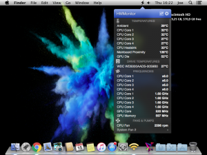

kosakgroove Posted December 15, 2016 Author Share Posted December 15, 2016 Works better performance-wise, but I am still stuck between 1.6GHz and 2.39GHz. CPU is always at one or the other frequencies, no in-between. Does this look to you like a successful implementation of native power management? Not to me. Link to comment Share on other sites More sharing options...

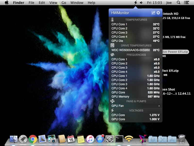

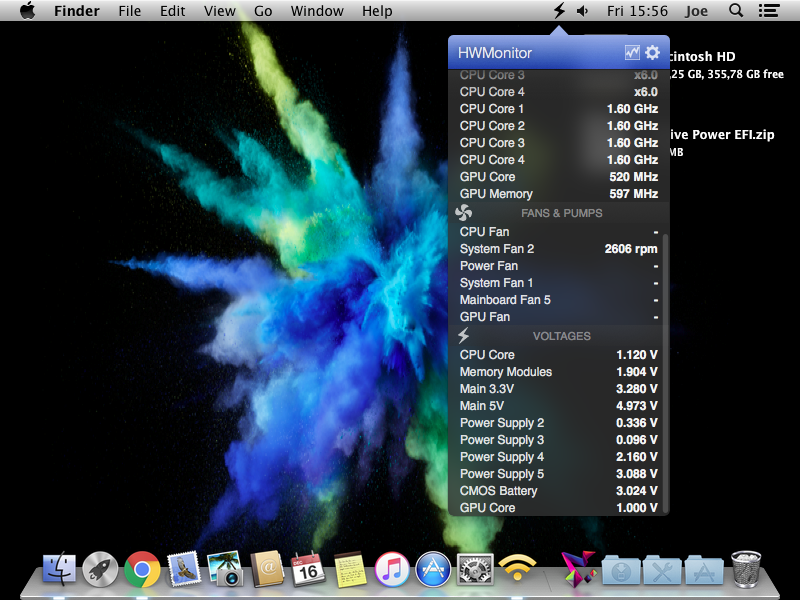

kosakgroove Posted December 16, 2016 Author Share Posted December 16, 2016 Please correct me if I am wrong but I think I was able to do it, since:1- No NullCPU in my system anymore2- I use Generate P and C states in Clover3- Last login: Fri Dec 16 12:58:24 on ttys000 Joes-Power-Mac:~ joe$ kextstat|grep -y applelpc 89 0 0xffffff7f826b0000 0x3000 0x3000 com.apple.driver.AppleLPC (1.7.0) <59 11 5 4 3> Joes-Power-Mac:~ joe$ kextstat|grep -y appleintelcpu 19 0 0xffffff7f8227d000 0x2b000 0x2b000 com.apple.driver.AppleIntelCPUPowerManagement (217.92.1) <7 6 5 4 3 1> 27 0 0xffffff7f82278000 0x3000 0x3000 com.apple.driver.AppleIntelCPUPowerManagementClient (217.92.1) <7 6 5 4 3 1> Joes-Power-Mac:~ joe$ kextstat|grep -y acpiplat 12 1 0xffffff7f82587000 0x5f000 0x5f000 com.apple.driver.AppleACPIPlatform (2.0) <11 10 7 6 5 4 3 1> Joes-Power-Mac:~ joe$ kextstat|grep -y acpi_smc 62 0 0xffffff7f81a6f000 0x10000 0x10000 com.apple.driver.ACPI_SMC_PlatformPlugin (1.0.0) <61 60 59 11 10 7 6 5 4 3> Attached is my EFI , please help and tell me if all is goodTemperatures went down to great levels: I did lose most of the LPC sensors I had before AppleLPC loaded, like CMOS battery Level, PSU voltages, but I honestly dont care, as long as its something purely cosmetical, that doesnt mean anything.Is this good to rock guys? Native Power EFI.zip Link to comment Share on other sites More sharing options...

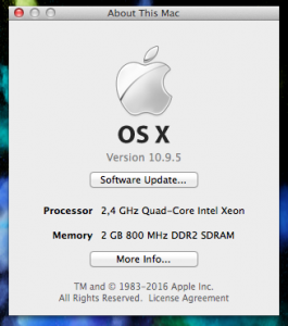

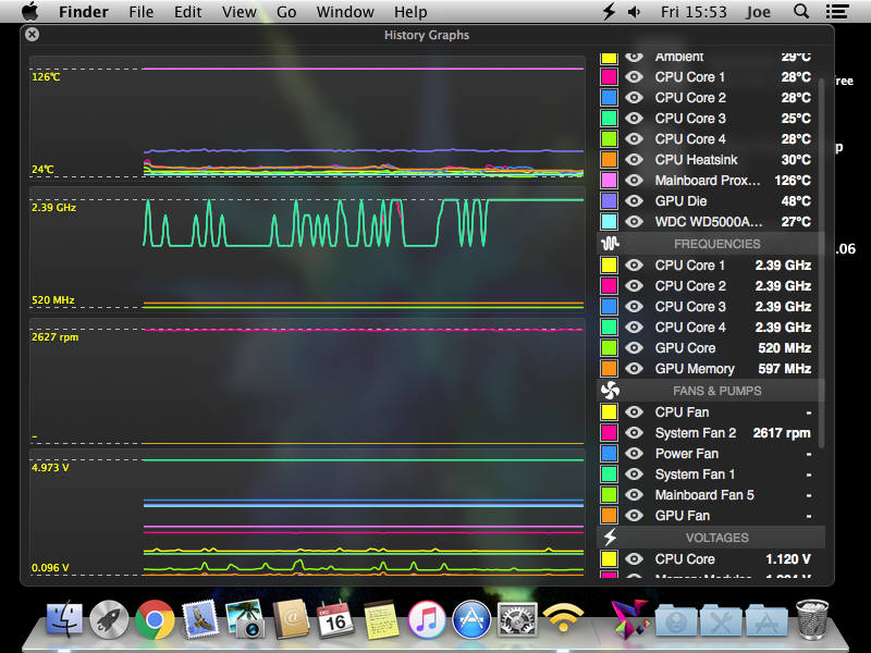

kosakgroove Posted December 16, 2016 Author Share Posted December 16, 2016 I am running OS X 10.9.5 Mavericks. I use a Cartri modded BIOS since it makes most of the DSDT patching made. I just modified a bit of it to my needs. I tried all LPC and shutdown patches I found and none work well. So I need custom LPC injector and I need EVO Reboot since it's the only way to shut this computer down totally when it uses OS X. I dont see what harm this kexts do. I am using Mac Pro 3,1 SMBIOS and have no NullCPU anymore. The only problem now seems that it never goes lower than 1,60 GHz, even when idling.... I get 1,60 GHz, 2,13 GHz and 2,39 GHz , nothing more nothing less. Computer now oscilates between those states. Temperatures are really great at the moment so I dont know, i can live with it in this state, But if anyone can kindly help me further After a reboot the LPC sensors are all back, and AppleLPC.kext still loaded! Awesome Link to comment Share on other sites More sharing options...
MaLd0n Posted December 16, 2016 Share Posted December 16, 2016 I am running OS X 10.9.5 Mavericks. I use a Cartri modded BIOS since it makes most of the DSDT patching made. I just modified a bit of it to my needs. I tried all LPC and shutdown patches I found and none work well. So I need custom LPC injector and I need EVO Reboot since it's the only way to shut this computer down totally when it uses OS X. I dont see what harm this kexts do. I am using Mac Pro 3,1 SMBIOS and have no NullCPU anymore. The only problem now seems that it never goes lower than 1,60 GHz, even when idling.... I get 1,60 GHz, 2,13 GHz and 2,39 GHz , nothing more nothing less. Computer now oscilates between those states. Temperatures are really great at the moment so I dont know, i can live with it in this state, But if anyone can kindly help me further Screen Shot 2016-12-16 at 15.53.44.png why u use bios mod? Use original bios and full edit DSDT with folder http://www.insanelymac.com/forum/index.php?app=core&module=attach§ion=attach&attach_id=209505 Link to comment Share on other sites More sharing options...
