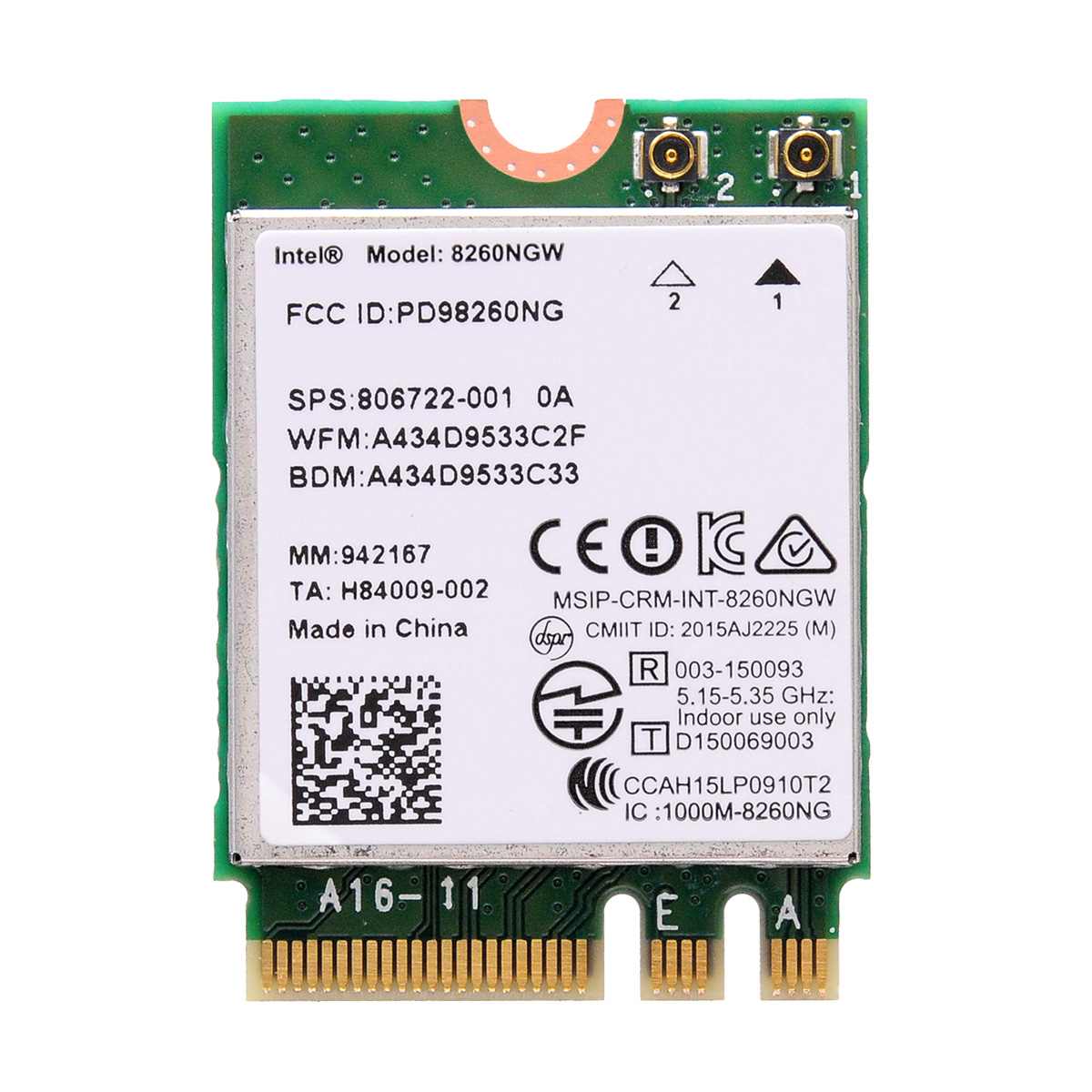

Baschdl Posted December 17, 2016 Share Posted December 17, 2016 No need to clone it. Windows 10 is bound to the device itself not the SSD, it will automatically be activated no matter what drive you put in there. Don't forget you have to replace the Intel Wifi card as well for working wifi. even though the system gets activated the first time with the pre installed drive?! nice to know, I read that one has to call Microsoft after switching harddrives. the Dell wifi card is already on my desk;-) Tonight, I will prepare everything for the osx installation tomorrow - and play around with the stock OS in the meantime to check out the tablet (did not have a chance the first time because of the wrong power supply/cord). -- Sent from my iPhone using Tapatalk 1 Link to comment Share on other sites More sharing options...

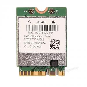

Baschdl Posted December 19, 2016 Share Posted December 19, 2016 OMG, I bought the DW1560 as a 'wifi card' on Amazon; no mentioning of bt. So I never checked in the preference pane. My bad! sorry, works of course. edit: any news on the tb3 support with the new MBP arriving?! -- Sent from my iPhone using Tapatalk Link to comment Share on other sites More sharing options...
blankmac Posted December 19, 2016 Author Share Posted December 19, 2016 OMG, I bought the DW1560 as a 'wifi card' on Amazon; no mentioning of bt. So I never checked in the preference pane. My bad! sorry, works of course. edit: any news on the tb3 support with the new MBP arriving?! -- Sent from my iPhone using Tapatalk If it did work, it would only be with Sierra. I've booted Sierra but haven't delved too deeply into getting things working. Sent from my iPhone using Tapatalk Link to comment Share on other sites More sharing options...
