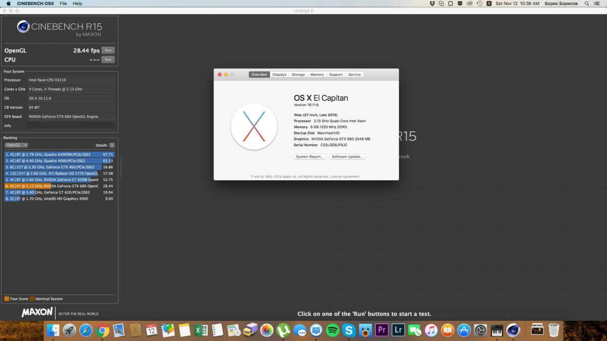

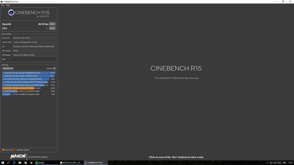

kd503_b Posted November 12, 2016 Share Posted November 12, 2016 I just bought a gtx 680. The card is a 2 gig version from Asus. I haven't installed the nvidia web driver. The card is getting 40 fps in Windows 10, whereas in OS X under 30 fps. Does anybody know what's the problem? Link to comment Share on other sites More sharing options...
Matthew82 Posted November 12, 2016 Share Posted November 12, 2016 Cinebench is not good gpu performance test. It mixing cpu and gpu in test. If you will have faster cpu the fps will by bigger. Try with Luxmark 3, Geekbech 4 ore Valley. Link to comment Share on other sites More sharing options...
kd503_b Posted November 12, 2016 Author Share Posted November 12, 2016 Tried Valley - same story. Around 1400 point in Windows, in OS X around 1000 . I think my problem is with the AppleGraphicsManagement kext not boosting my gpu when it's under load. Link to comment Share on other sites More sharing options...
Matthew82 Posted November 12, 2016 Share Posted November 12, 2016 Windows always giving bigger score then MacOS Link to comment Share on other sites More sharing options...
