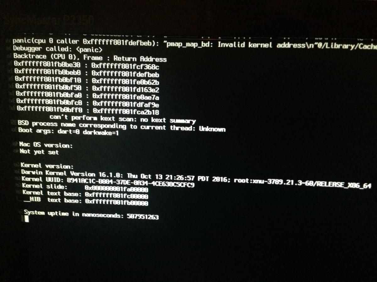

Please someone try this: https://www.dropbox.com/s/zu5jixphkr4elk0/OsxAptioFix2Drv.efi?dl=0
I tell you... if this one should give you VarStore r/w access, storm the AMI headquarters and slaughter them all.
This will give UEFI wrong addresses for virtually mapped RT_data regions, so the system might not boot, fail randomly during RT or not shutdown properly.
EDIT1: nevermind, this will not work... hold on, will update the post with a new bin soon.
EDIT2: This could work now... link updated.
Kernel panic :"pmap_map_bd: Invalid kernel address\n"@/Library/Caches/com.apple.xbs/Sources/xnu/xnu-3789.21.3/osfmk/i386/pmap_x86_common.c:2211
Hmm, we can't test it then, but I have a horrible foreseeing for what could be the reason. Would you be ready to flashed a modded fw? GA has "DualBIOS" afterall...
