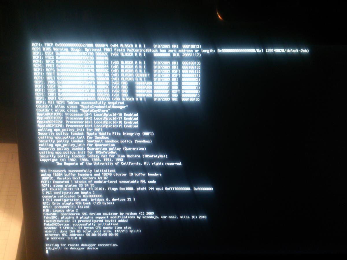

I created USB installer with macOS 10.12.1, successfully install macOS and clover not work. I configure it as before(in 10.10.5), but when i tried to boot, clover show me +++++++++++++++++++ and reboot computer. Chameleon boot system correctly. I tried different SMBIOSes, but no luck. Kernel is in /S/L/Kernels/. I attach the config.plist and installation screenshot. Sorry my bad English.

Clover needs a functional prelinkedkernel to boot, if you use -f or UsekernelCache=No to boot with Enoch that will not work with clover at least with AMD hackintosh, boot with enoch repair caches from terminal make sure that you have a prelinked kernel without errors and then reboot with Clover.

Again, yes on El Capitan and Sierra there are no caches on S/L/Caches/com.apple.kext.caches/startup, that kextcache file is symlinked to the prelinkedkernel file,if you delete prelinkedkernel and reset the pc immediately the only way to boot is with Enoch -f or UseKernelCache=No so there is a no-caches boot,if you use Clover you will get instant reboot because Clover needs the prelinkedkernel file a.k.a kextcache,safeboot is a no-caches mode also have you tried to boot into safe mode (-x) using Clover?

You can build prelinkedkernel from el capitan using kextcache -update-volume command,Kext Wizard or even touch command but it won't work for you because you have kexts that causing errors, you have to find out first which kexts don't link remove them and replace them with the vanilla apple kexts then use sudo kextcache -update-volume /Volumes/yourSierraDiskNAme and reboot.

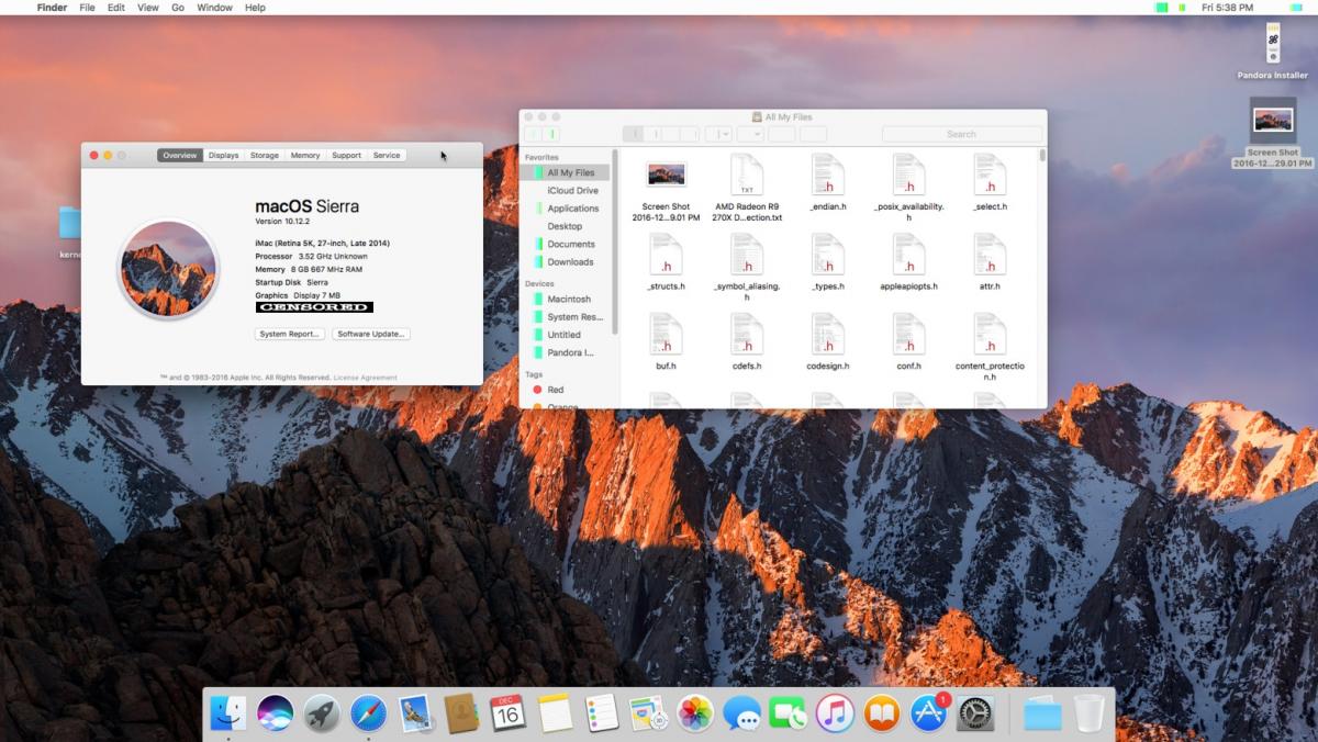

The graphical glitch came back. I updated my Sierra 10.12 to 10.12.2 with Broya's new Kernel and I repair everything(remove kext, add new kernel). YES, I did enable my GPU(adding my device id to the kext) but it's not being recognized. My Graphics is AMD R7 370.

Fix your GPU it says 7MB vga,driver not injected or loaded,i'm on 10.12.2 and there is no glitch at all,i have green icons ONLY in safe mode where there is low resolution graphics.

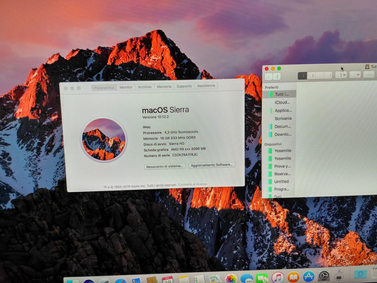

I installed Sierra 12.2 (16c67) in my FX 8320 system using 12.1 kernel. It works well but I have glitched icons like El capitan (same problem as 10.12 GM with Bronya Kernel). How Can I fix It?
You have to inject your GPU, its not recognized by macOS OOB. Use this guide, It's really easy! When the Radeon works, the glitch is gone.
As far as I can see, you have to edit the AMD9500Controller.kext and inject the Device ID 0x67DF1002
In Clover, you have to set:
- FakeID / ATI = full ID 0x67DF1002
- Inject / ATI = true
- FBName = framebuffer name Dayman
- FixDisplay = true
Repair Permissions and reboot.

Yes, I know. Yesterday after installing Sierra 12.2 I tried to get the RX480 work with full acceleration by edit RadeonX4100 kext and inject 0x67DF1002 (In the 9500 controller there is already the device ID) but nothing has changed. I will try with clover (I always use Enoch bootloader).
