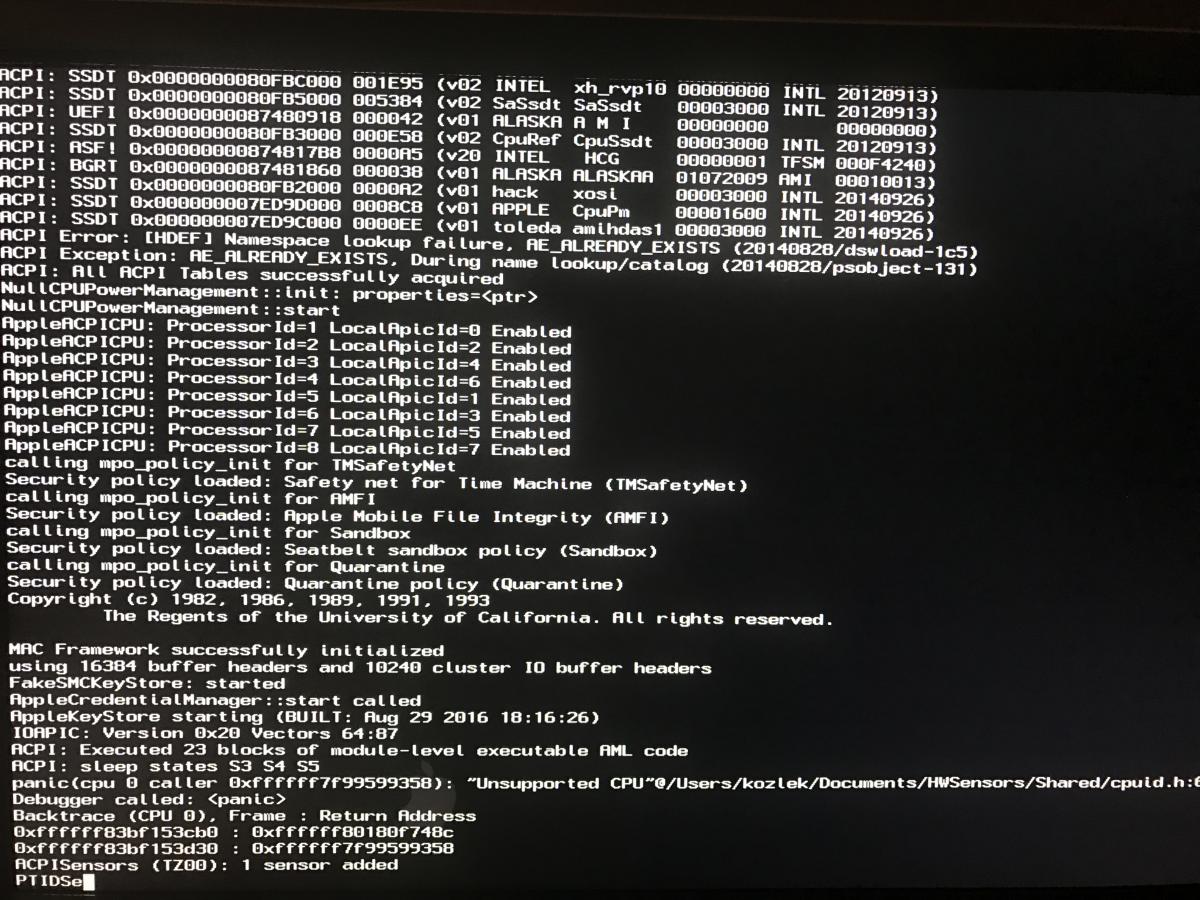

tamorgen Posted October 22, 2016 Share Posted October 22, 2016 I've been running a GA-Z68XP-UD3 board for nearly 5 years, and I've decided to upgrade: GA-Z170X-UD5 Motheboard Intel Core i7 6700K CPU G.SKILL F4-3000C15D-16GVRB Ripjaw Series 16 GB DDR 3000 DIMM EVGA Geforce GTX 970 4GB FTW Gaming Corsair HX850i PSU Corsair Hydro Series H75 Closed Loop CPU cooler Plextor M8Pe M.2 2280 512GB NVMe My old system ran very solid for most of that time. I started off building it with utilites from (that sight that shall not be named), and moved from the dark side to Clover. Overall Clover has been a much better experience, once it's up and running. I've based my BIOS settings on Cyberdevs post, and even tried variations of his config.plist. I've added PikerAlpha's IONVMEFamily.kext patch to the clover Kernel and Kexts patching, to try and get Sierra to recognize my NVMe SSD (no luck yet) I'm only using FakeSMC.kext and NullCPUPowermanagement.kext (tried with and without the later) I installed Sierra using a Vanilla install off of USB to my old Crucial 128 GB SSD, since the Sierra installer doesn't see my M.2 drive. Installation went fine. Upon reboot (still off of USB), I'm getting Kernel panics and not able to boot into mac OS. panic(cpu 0 caller 0xffffff80003430d6): "zone_init: kmem_suballoc failed"/Library/Caches/com.apple.xbs/Sources/xnu/xnu-3789.1.32/osfmk/kern/zalloc.c:2149 I've attached my EFI directory. Can anybody assist? EFI.zip Link to comment Share on other sites More sharing options...
tamorgen Posted October 23, 2016 Author Share Posted October 23, 2016 Anyone? I've been working on this all day. I've removed some of the extra stuff in the clover folders, and I'm making very little progress. I stilll cannot boot. I've attached the latest image of my panic screen. Link to comment Share on other sites More sharing options...

tamorgen Posted October 23, 2016 Author Share Posted October 23, 2016 I still can't get past: panic(cpu 4caller 0xffffff7f8cb99358): "Unsupported CPU"@/Users/kozlek/Documents/HWSensors/Shared/cpuid.h:698 I am just trying to boot off of the USB. All I have is FakeSMC and NullCPUPowerManagement installed. I'm getting very frustred. Link to comment Share on other sites More sharing options...
scj312 Posted October 24, 2016 Share Posted October 24, 2016 I still can't get past: panic(cpu 4caller 0xffffff7f8cb99358): "Unsupported CPU"@/Users/kozlek/Documents/HWSensors/Shared/cpuid.h:698 I am just trying to boot off of the USB. All I have is FakeSMC and NullCPUPowerManagement installed. I'm getting very frustred. Sure, I can post mine. This error looks to me like you have HWSensors installed either in /S/L/E or /L/E since I didn't see them in your EFI. 1 Link to comment Share on other sites More sharing options...
tamorgen Posted October 24, 2016 Author Share Posted October 24, 2016 Sure, I can post mine. This error looks to me like you have HWSensors installed either in /S/L/E or /L/E since I didn't see them in your EFI. Thanks. I'll give them a looksie when I get home (and you get them posted). While I don't remember having HWSensors installed, it's certainly possible. I may need to wipe the drive and start clean as a next step. It's certainly possible that there is something in my /S/L/E directory that I don't remember, and the Sierra installer isn't overwriting/clearing out. Link to comment Share on other sites More sharing options...
tamorgen Posted October 24, 2016 Author Share Posted October 24, 2016 Sure, I can post mine. This error looks to me like you have HWSensors installed either in /S/L/E or /L/E since I didn't see them in your EFI. So, good news/bad news. Mostly good. I got my system to boot finally. I booted into the Mac OS installer, and then went into Terminal and mounted the system drive. I went into /S/L/E, and sure enough, there was FakeSMC.kext, right where it shouldn't have been. I originally built my old system using MB from TM (can't say the real names on this board), and his tools put FakeSMC in there. So I'm up and now just need to fine tune (and there was much rejoicing). The bad news, is that I had to remove my M.2 drive to see my other hard drives and SSDs. I'm unclear why this is, but I suspect that some of the SATA ports get disabled if an M.2 drive is present. The only thing I found in the manual is that a PCI slot gets disabled, but I'm sure I'm missing something somewhere. I'd still like to take a look at your /EFI directory and config.pllst. My System Report is showing my EVGA Geforce GTX 970, but at 0 MB. Definitely something wonky there. Link to comment Share on other sites More sharing options...
