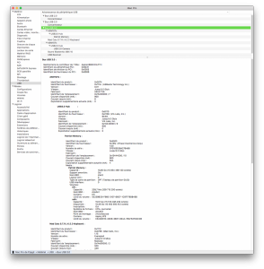

The USB3 ports are working great :) only port not working is usb 3.1 (with ASMedia).
ASmedia works well in usb3

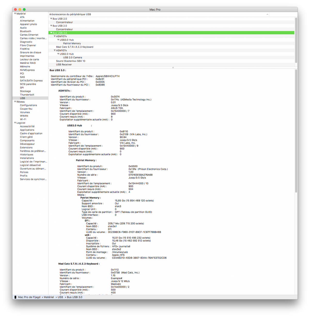

I installed an X99 with USB3,1
The usb3.1 are well declared with the name USB3,1 but works as a USB3 therefore 5GB / S and not 10GB / S
Here on my X99-A all my AsMedia usb works
